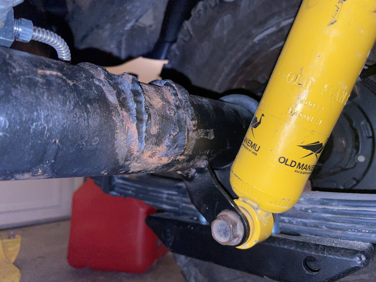

After my bent axle debacle, clobbering a shock mount, I thought about going the same way.
My D489 has 3.125 tubes, so I'll have to do some more homework, but I'm not a fan of the stock shock mounts either.

If I can ever figure out where I got these from, I’ll share the link. They work great on my axle if welded right.
