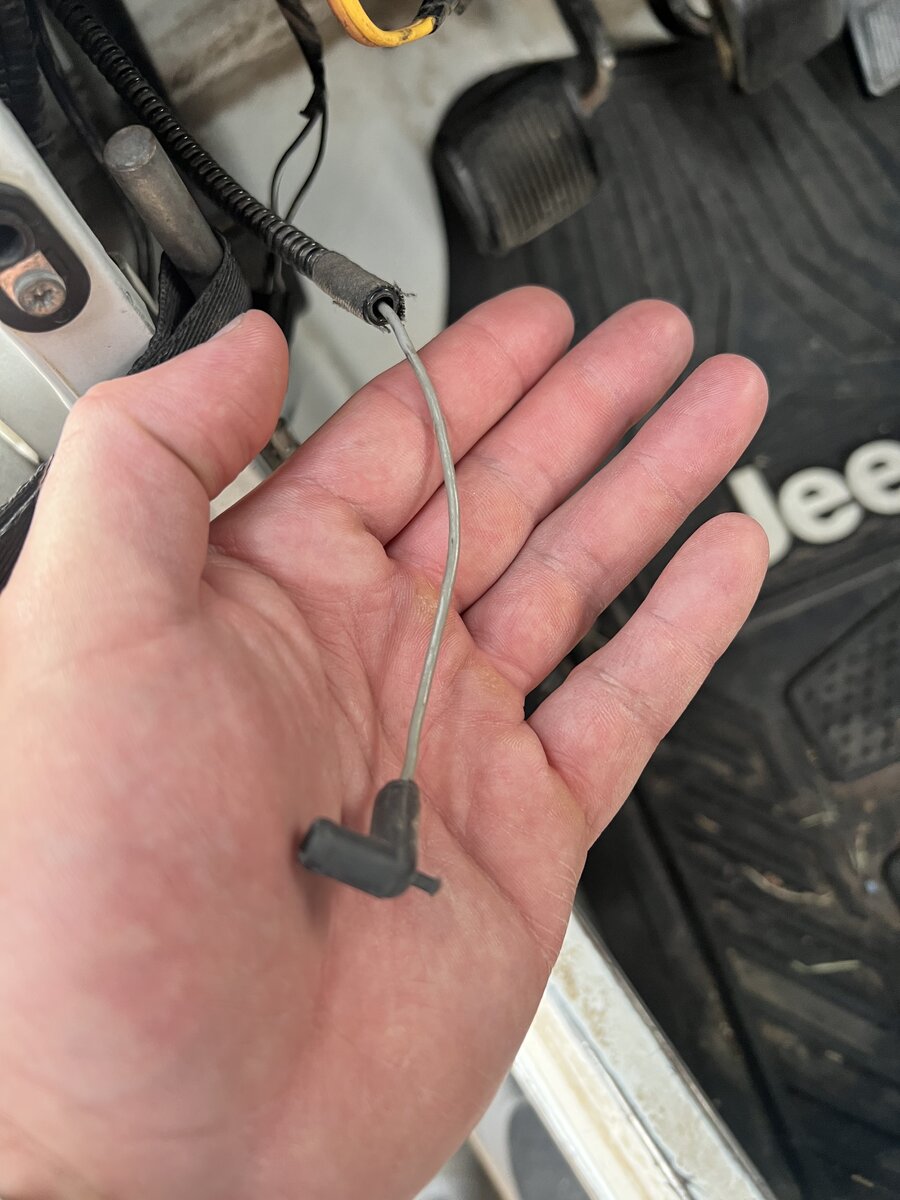

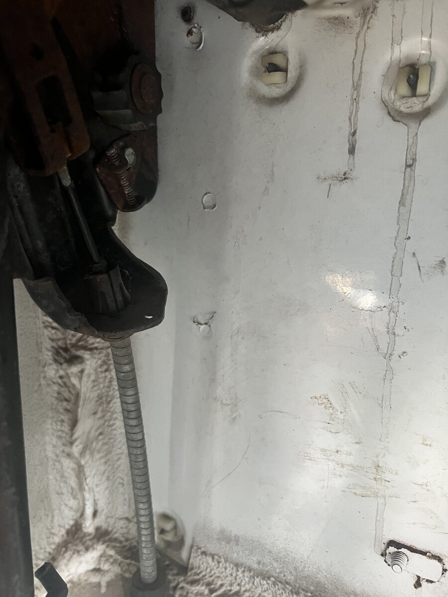

This is what the parking brake looks like. This is the only wire I found and it’s unplugged. Nowhere to plug into.
Pretty certain there should be a stud on the assembly for that elbow to go onto. I have a 94 which uses a spade terminal instead so it's not exactly apples to apples. And I'm not close to my rig to post a pic currently. But I can send what Mine looks like later.
Yeah, right under that black knob is probably where the stud should be. There is a spring laying in there. Was looking at other pictures and looks like something got broken off. The problem is I’m not sure if the light had come on before when the break was engaged. My thinking right now is that the previous owner may have broken it and closed off the circuit turning the light off. And I probably knocked what he did loose. Not sure but speculation.
