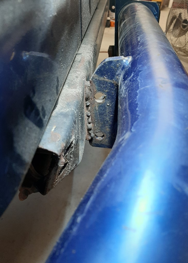

Good deal on the bumpers. I have some tube type a previous owner installed. The front bumper mounted on the standard frame attach points but they welded the read bumper to the rear clip. I cut the weld off last week to sand and repaint the bumper and found their weld had burned through the clip. I'll patch it and try to make up some brackets to properly attach it.
Let me know how your rear bumper attaches.
Still have not gotten to the rear bumper, but I have hitch that will bolt directly to the clip you are talking about (uses 4 bolts per side). Then the bumper connects to the hitch by way of the clip you have in the picture. I will have to replace my rear clip due to rust.

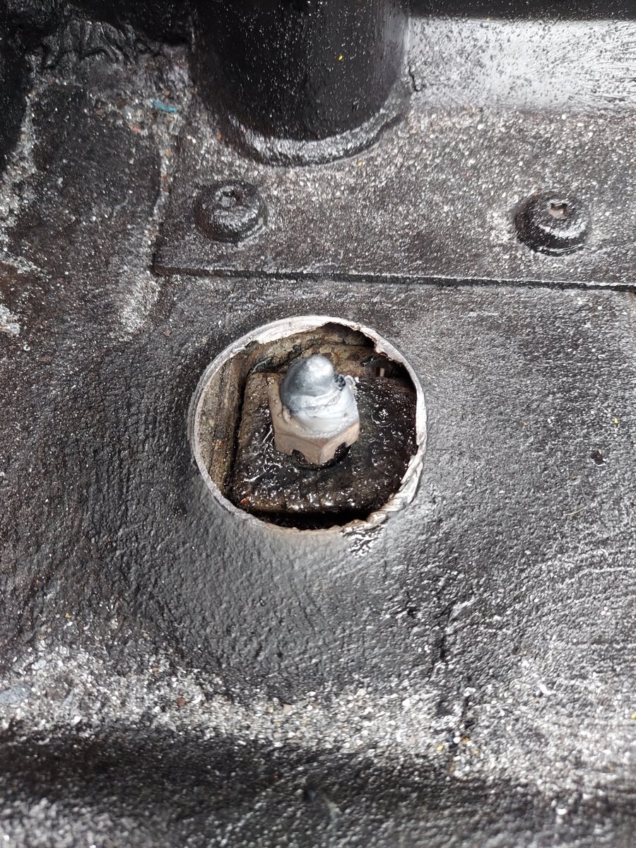

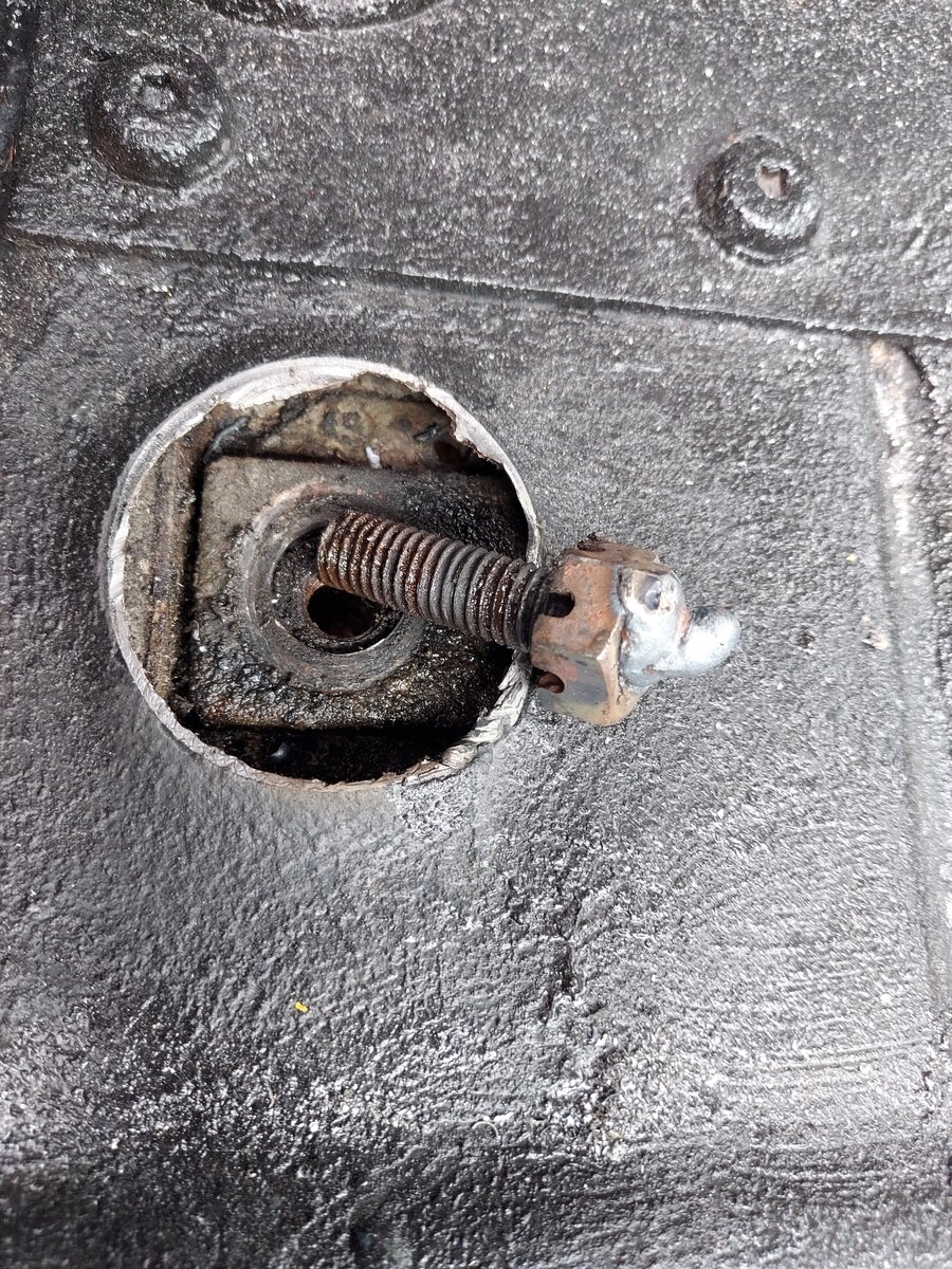

I just realized I never finished with my body mount problem and how I solved it. Some of the bolts were seized up, some were missing, and some the lower half was rusted off. The missing was easy and I simply ran a tap thru the threads. The rusted off and seized were the bigger issue. I used a 1-1/2 hole saw on the inside and cut the floor out above the mount hole and bolt. Soaked them down with "Free All" . Nest day 1 or 2 came out with vise grips, but for the remaining I wire brushed the bolt head and put an oversize nut over it. Welded it to the bolt and wrenched them right out. Tacked the cut-out floor back in place with a coat of undercote. I used anti-seize on the treads of all the new bolts. Actually I use anti-seize on every nut and bolt I touch.
