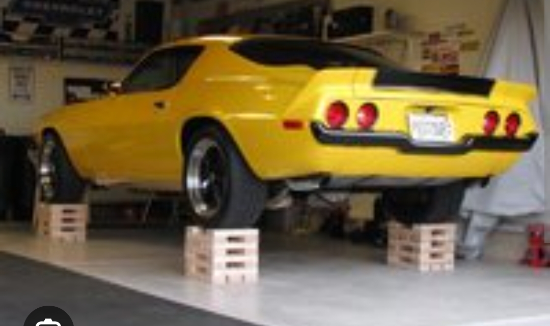

If the wheels are staying on, I built these from 2x4's no fear of them tipping over. The wood is glued and screwed together.
Copy/pasta picture from internet.
