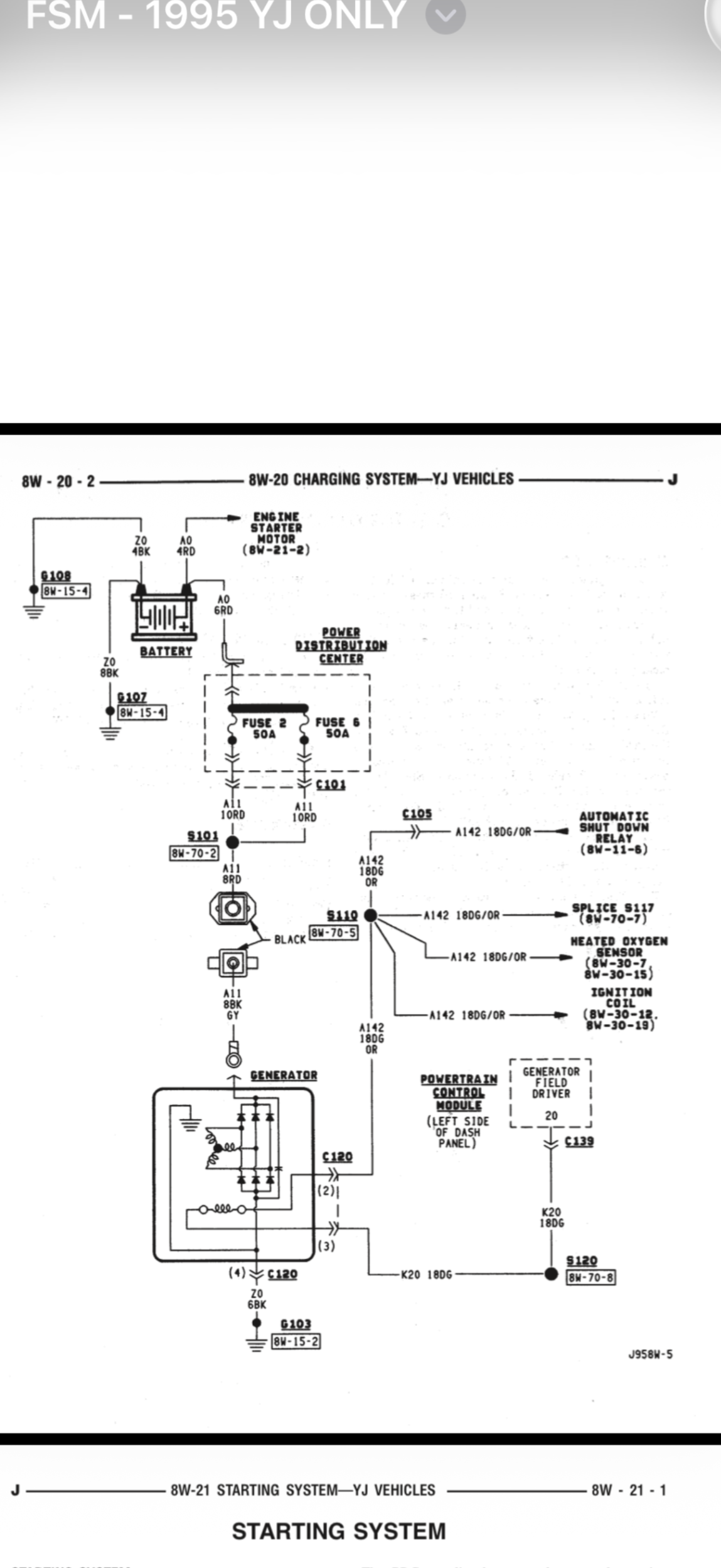

I referenced our FSM for this foundation: (see attached diagram)
– 4 ga battery → starter
– 6 ga battery → PDC
– 4 ga battery → engine block
– 8 ga battery → firewall
– braided head → firewall strap (and hood strap on some)

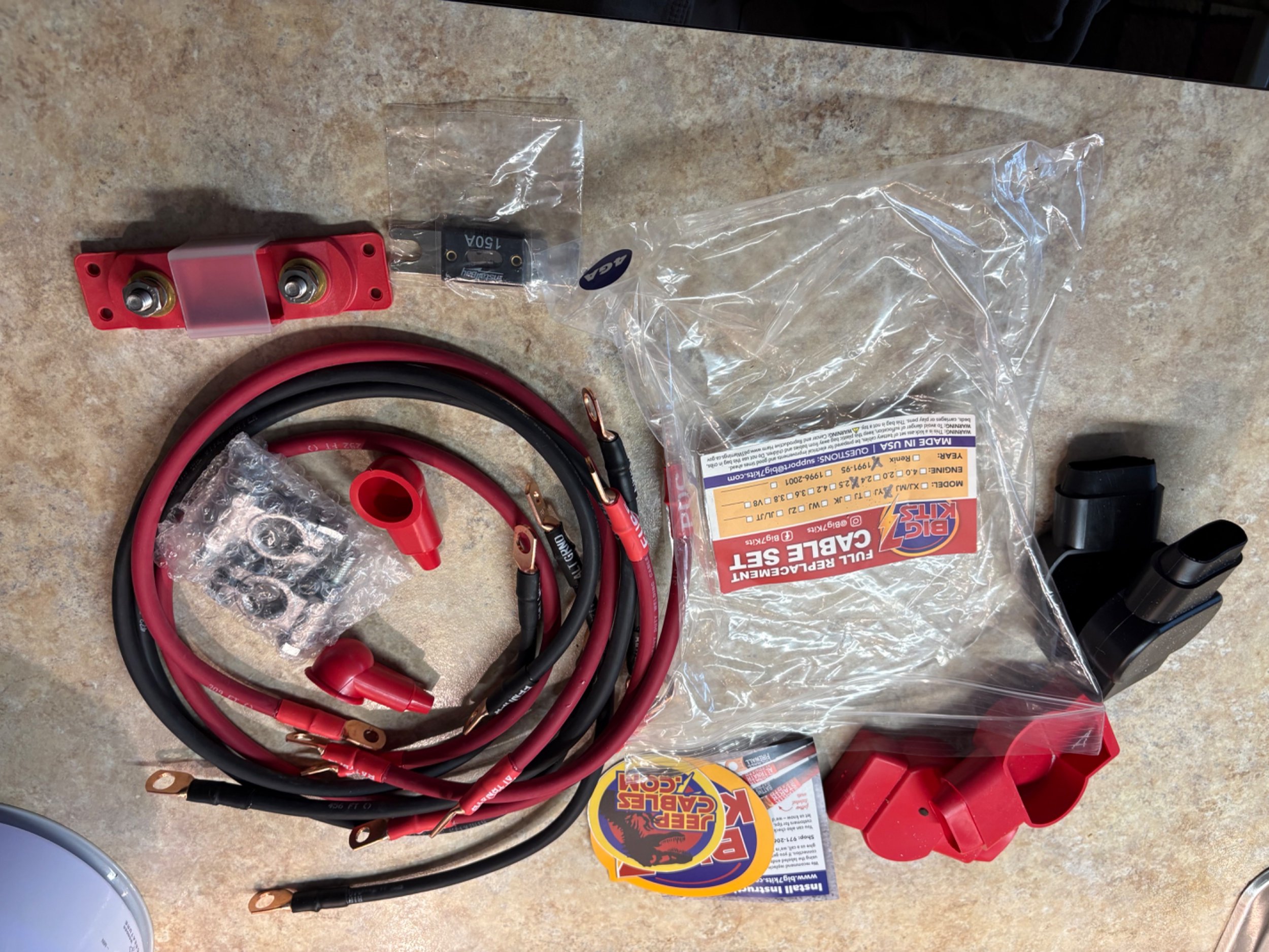

Very nice analysis! A guy, jfleland, on Jeepforums recommended jeepcables.com and I just received their kit. Went with the stock 4guage kit. Nice stuff. The corrosion, damage and voltage drops around the jeep makes this work a no brainer. Your principles make sense and will add to kit. Two gauge to starter I don’t think is really necessary but what the heck. Drove and worked on big starters and batteries in over the road trucks so know big and clean are most important. I can now get back to inside work.
Most important, comes with TWO stickers!

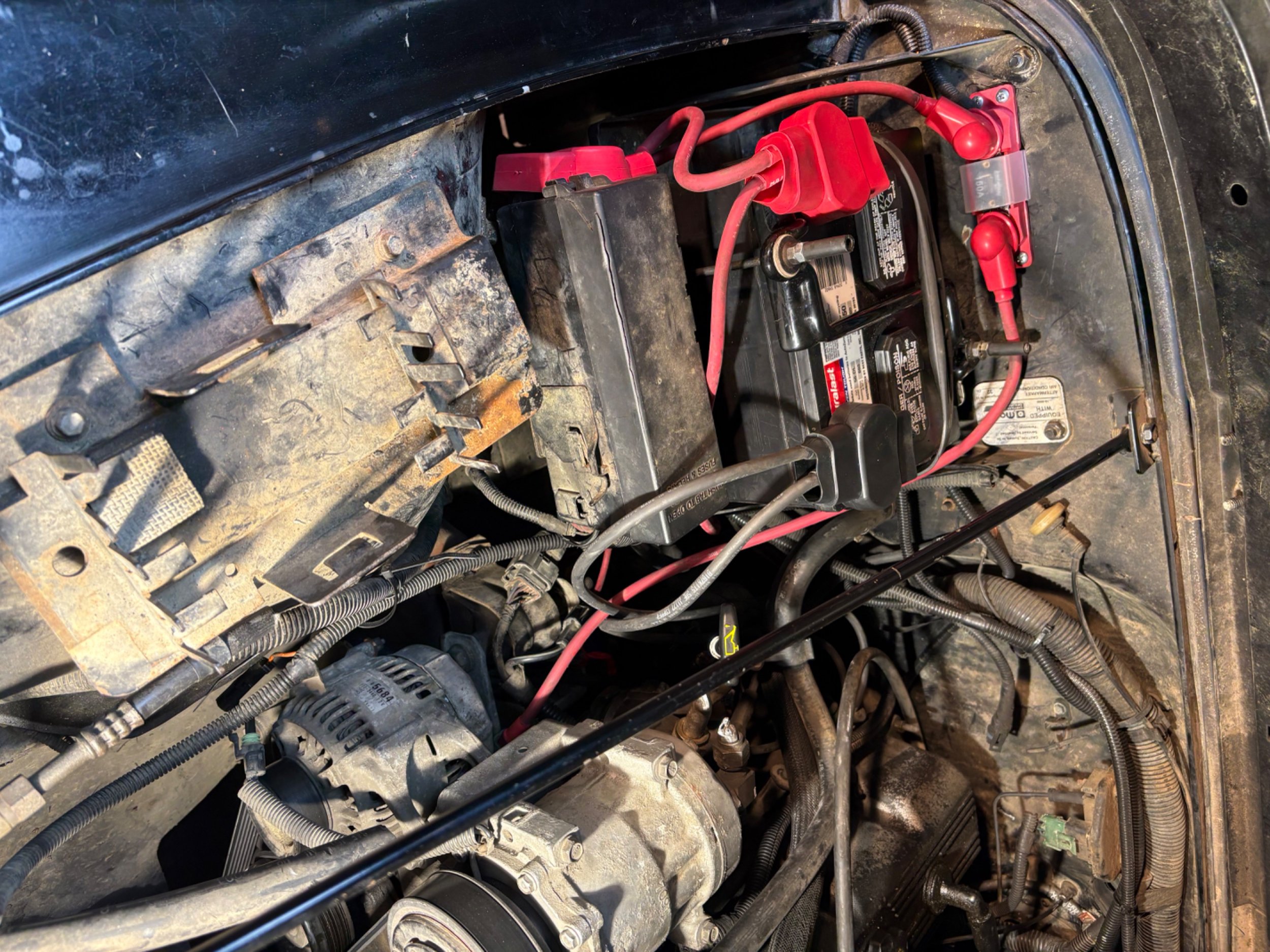

Awesome! Please let me know how it goes! Are you installing the external fuse?
What about the wire to the alternator? Messing with that plastic isolator for the cable to fit made me hesitant.

I would like to see some photos when you're finished with your install. I believe that most of my cables are still in good condition but I'm sure they probably have some oxidization due to being 30+ years old. The only thing my YJ has going for it, is that it has always been garaged and only driven in the summer months.

I just did this 4 guage set from jeepcables.com. Great quality and fit. I made one change switching cables from PCM so I could get fuse up behind battery. Battery one was inch longer but had to drill larger the fuse one to fit battery.
The installation looks good. Question about the red terminal cover on the PDA covering the two red wires. Did that come with your kit? Mine didn't have that one, I did order the other two Military terminal covers. and that's all I got.
