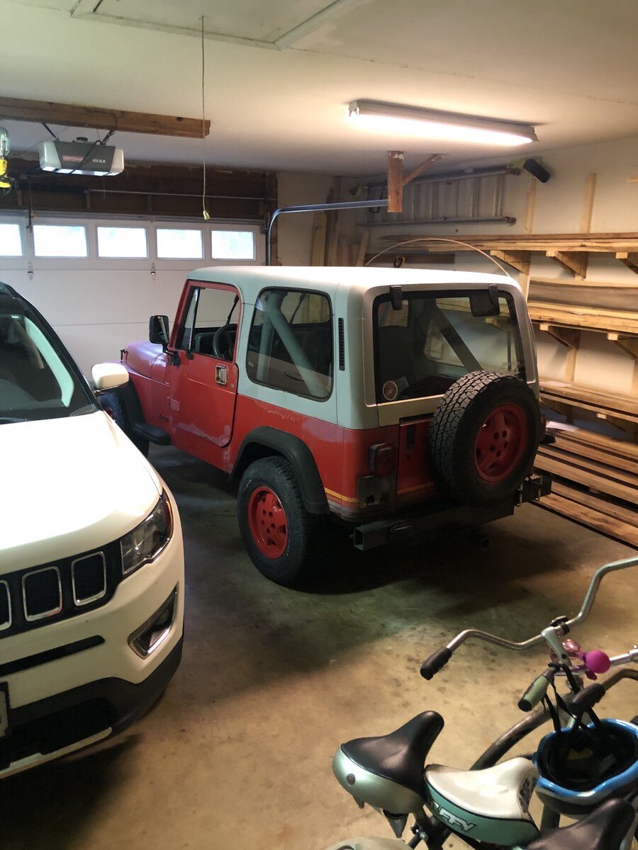

Hi all,
Yesterday I bought a very rusty YJ with at least on brake line busted. The seller provided me with new, pre-bent brake lines and Im planning on replacing them this weekend - Any tips or advice? Ive already got the PB blaster ready.. lol
