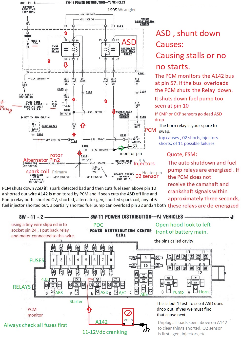

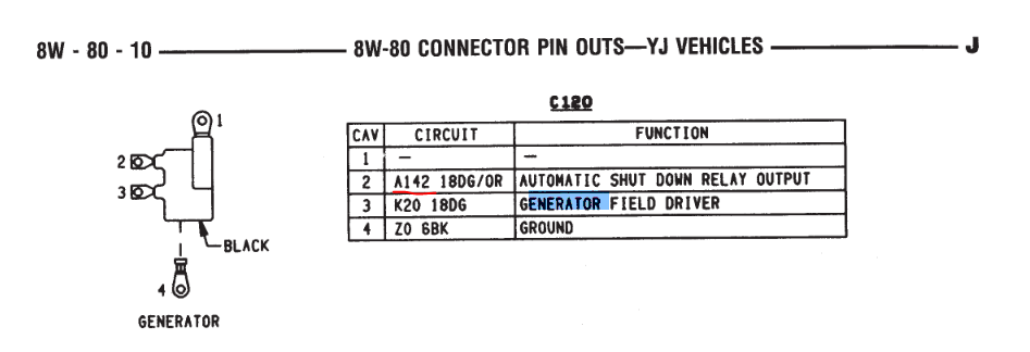

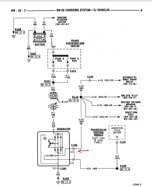

41: Alternator field control circuit open or shorted (wow smart) very serious.
42: Automatic shutdown relay circuit open or shorted(OR OVERLOADED)
ASD pin A142 overloaded or shorted.<<<<<<
42: Fuel pump relay control circuit (and ASD)
42: Fuel level unit - no change over miles OR Z1 voltage missing when auto shut-down circuit energized

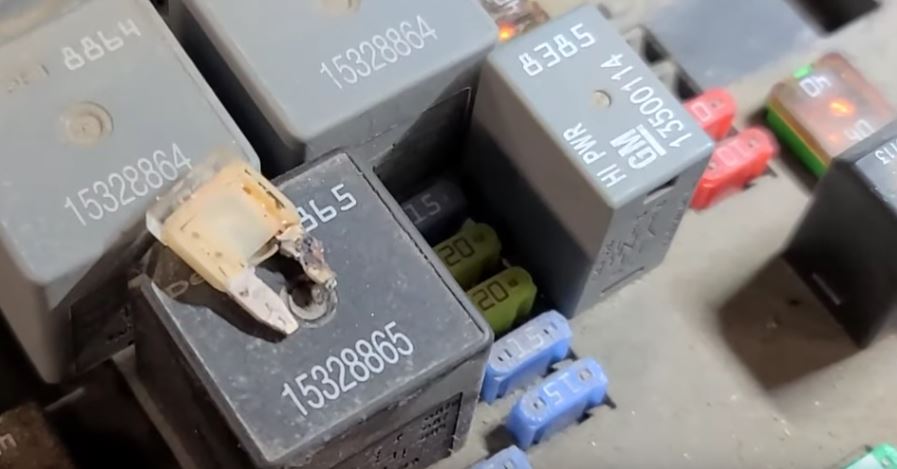

my guess is code 42, , very common.
