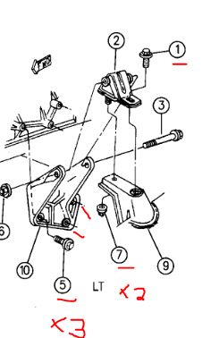

I thinks this is not going to work but is a way to reach some freeze (core ) plugs,
is it on center left core plug hole>?
some jeeps we can remove the left engine mount fully, (if not rusted in solid now) as many are in the salt belt (30 years in that is a horror)
4.0L I-6 engine left side (means drivers perspective
some heaters were installed not by jeep that is a fact. and crazy hard to prove yes/no.
and is moot, only the dure is a topic
mounts is the topic first. blocking acesss. (and manifolds) toss coin?
YT
these bolts pulled with front of engine lifted just a tad (jacked)<<video2
