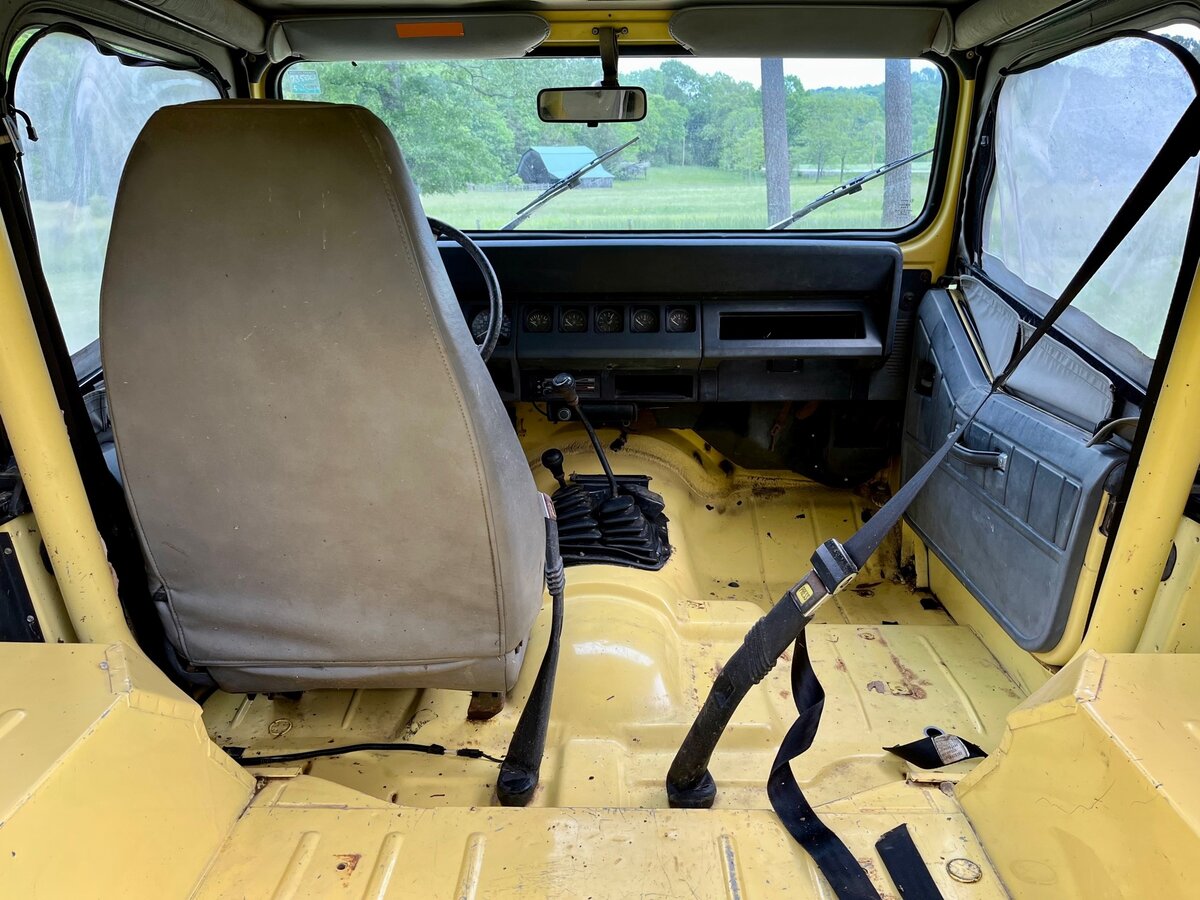

Anyone know of good vinyl paints that color-match (or sort of color-match) the various grays inside a 91? The dash & door panels are dark gray, the seats/visors/padding are a medium gray, and I assume the consoles matched the dash?
I'm asking for two reasons--I'm looking for a console that I assume I'll spray to maybe match the dash and doors, and I've got some patching to do on the driver seat that I'll touch up. Thought I might try SEM Medium slate gray (or granite, or dark slate gray, or duplicolor charcoal) for console/dash parts and maybe start with SEM Medium gray for the seats but hoped someone else has already tested them out before I spent $100 on spray cans.
(Found a couple pieces of the old carpet in the barn--looks like it was black or very dark charcoal.)
