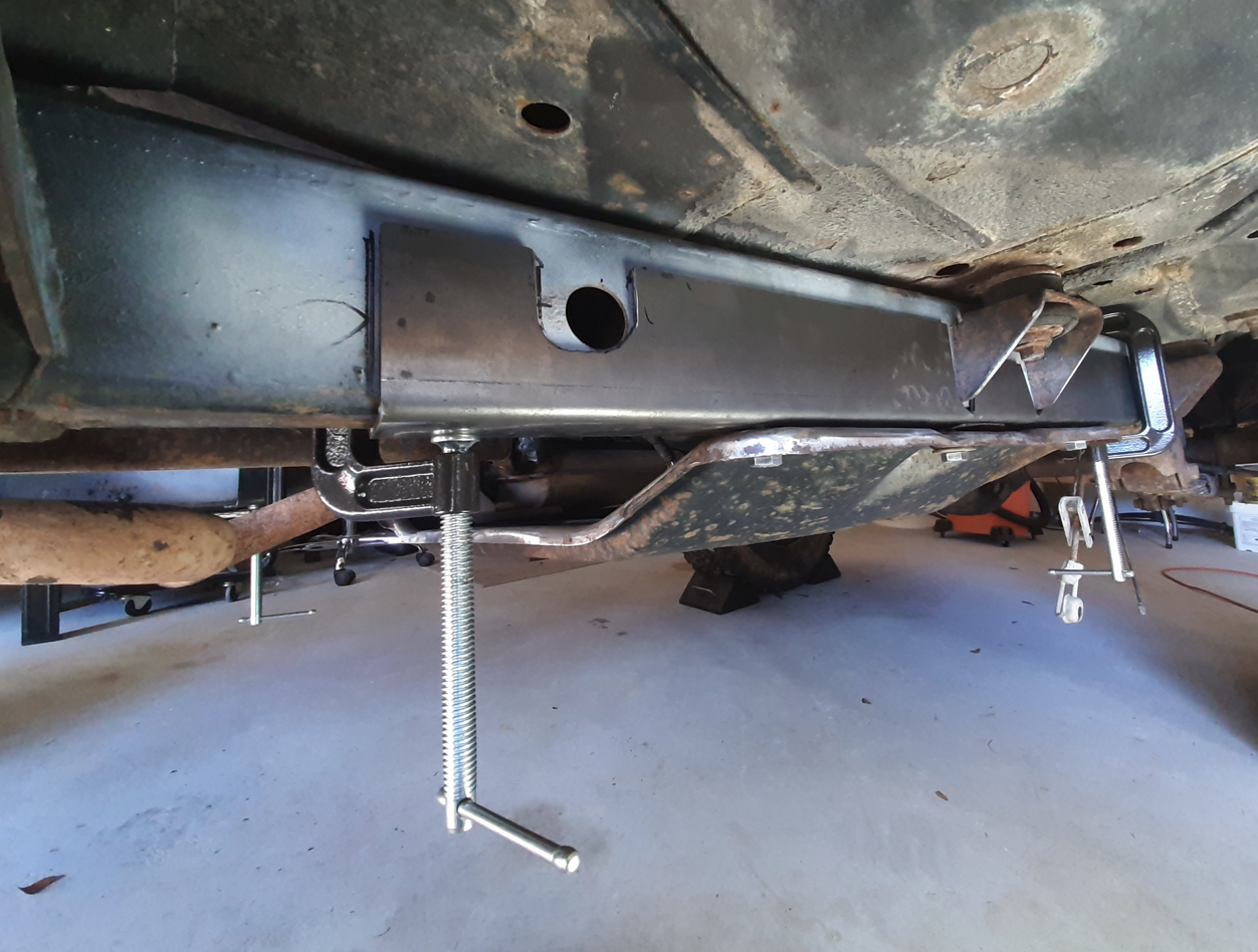

I had rust in the same spots but it was only limited to the rivnuts around the bolt holes. The top and sides of the frame were still in good shape.

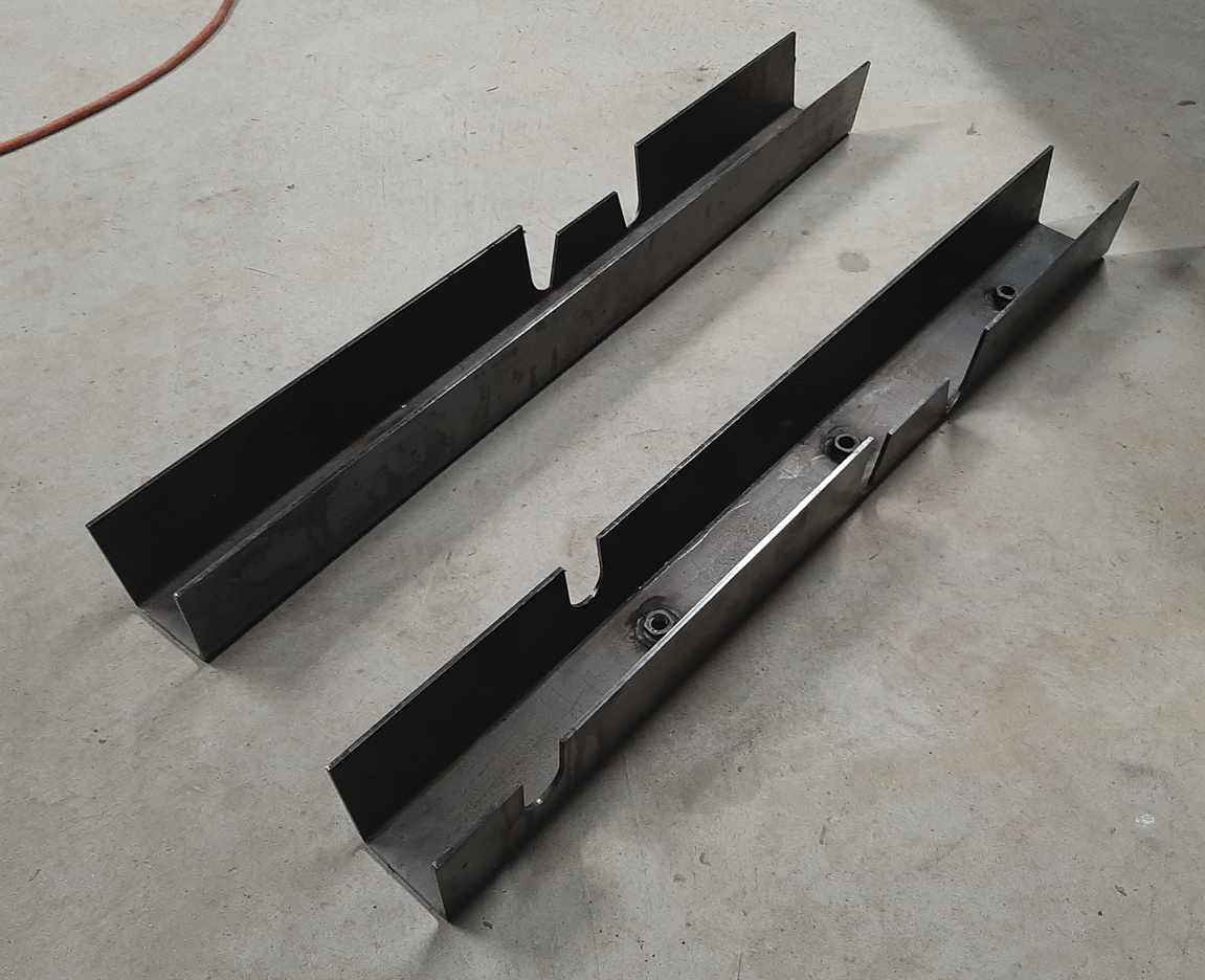

I cut out the bolt holes, treated and painted the inside of the frame and welded these channels to the frame. That was the only rust I found.
