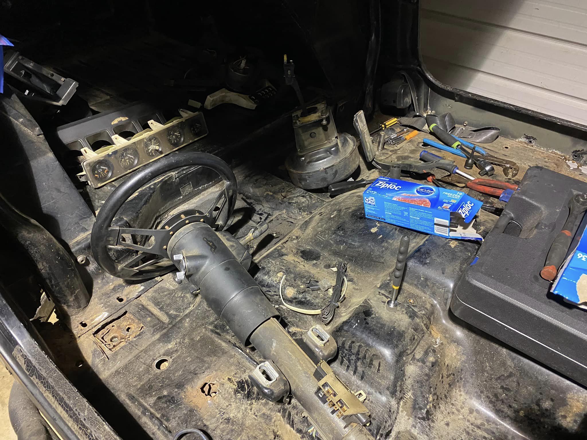

I'm still removing stuff but here's a photo of passenger side looking towards the rear of the tub. Hoping to have it completely stripped out by tomorrow except for the roll bar, they can grind those last couple of bolts out holding it in... 2 on each side, one set into the floor and the other set into the waterfall section. Oh! and the driver side seat belt, that one is stuck too!
Yours actually doesn’t look that bad compared to mine.
