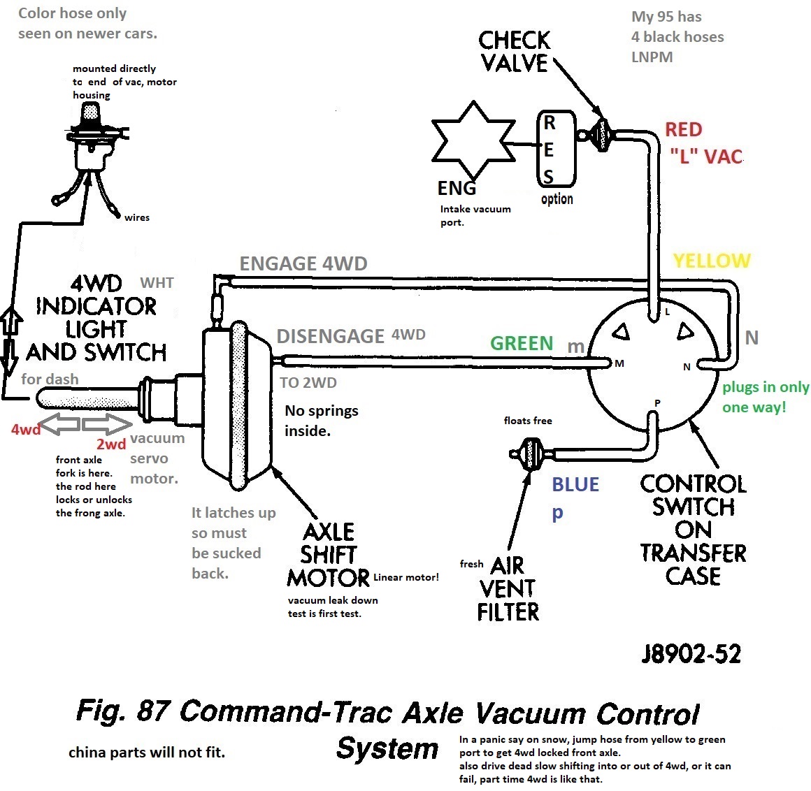

that vacuum servo (motor_ actuator) is push/ pull logic.
when one side sucks the other end vents.
if not , it goes to loggerheads. (means fights it self)
get a hand held vacuum pump,(w/gauge) and use it on the inboard nipple to get 4wd, the move to outboard ( all hoses pulled) and now 2wd and dash lamp goes off.
helps to have right wheel off ground. so the Vac servo etc can move easy
oops that free line is the VENT, oops
95 looks like this.YJ

if the lamp sticks on in 4wd, and you put vacuum on the inboard nipple, Tire off the road spun! by hand) then the servo is bad or its fork is jammed 4wd.
if not jammed then the switch is bad.
If the pinion stops moving and the lamp is stuck on,keyon, then the switch is bad. seen.at the fork housing in the video.

Key off test.
on mine I used the vacuum tool, on both nipples
and spin the tire.
and I had to spin it or the Vacuum motor stalls. and after applying hand pump vacuum there as I spin it you hear a loud clunk. (at that location)
do it to both nipples 1 at a time and spin it, it must clunk both ways or the motor is bad or the fork is jammed.
the axles are spline'd and must index and if not it jams. so the tires must turn even the most slow amount to get the lock to move.
the forks must not be dry ever. 5oz lube in the fork box.
