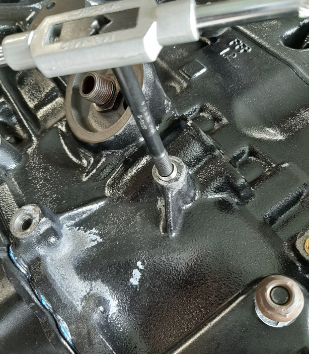

we cant see the bolt stuck, no photos presented
and damage seen is 100x best to see first. post photos, and win.
- heat
- if threads show, try vise grips and pen oil , after heating it up.
- if fails weld a nut to the short now stud
- if fails drilled out and collapsed
- if fails drilled out and Helicoiled, fix.
