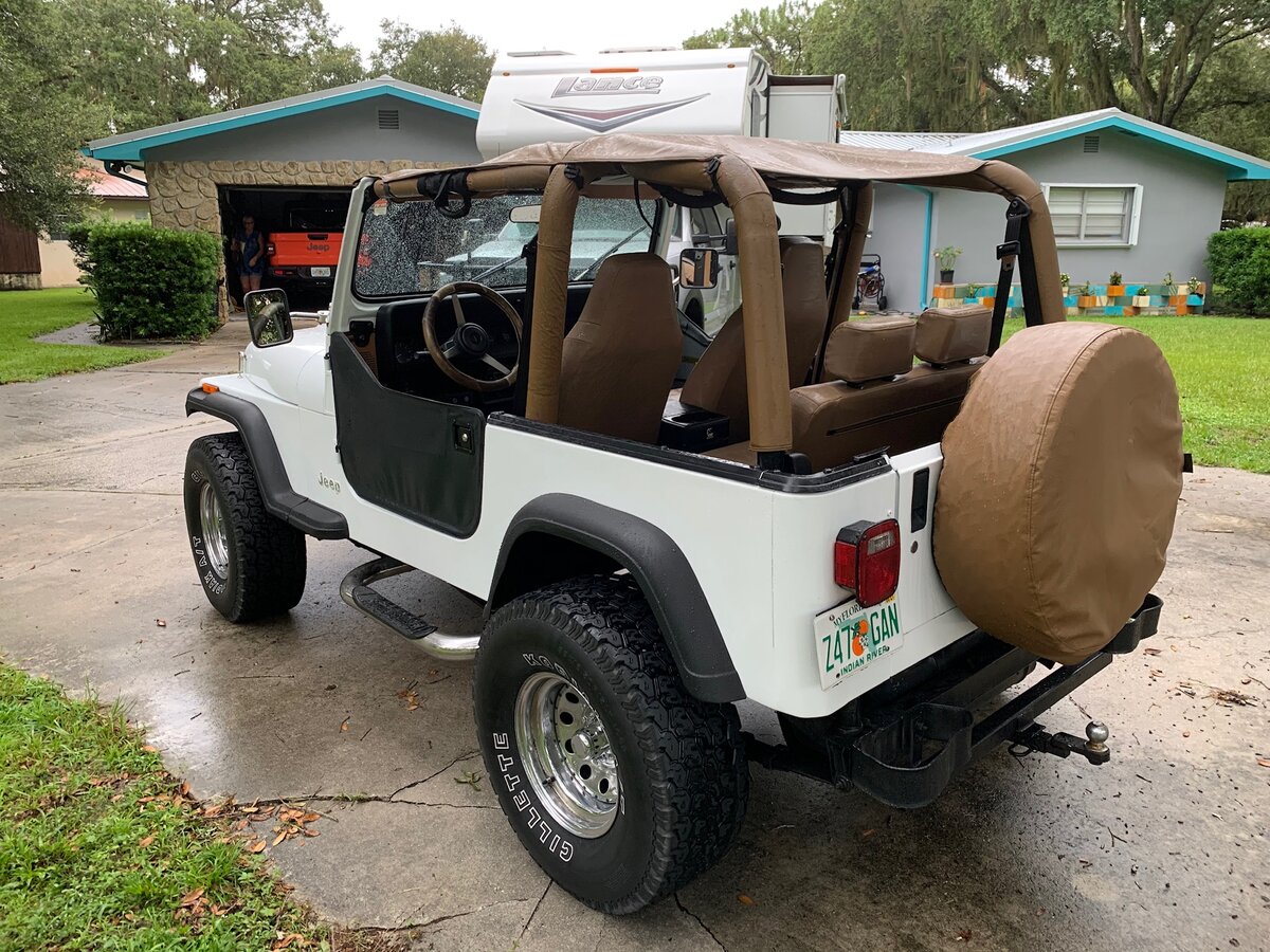

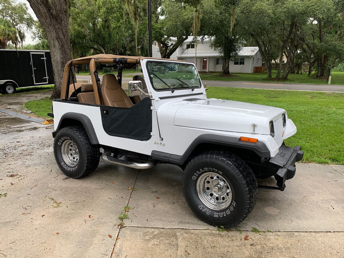

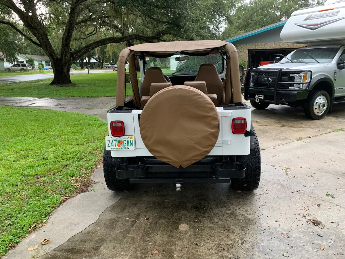

Thanks! It’s new to me and I have a few issues to resolve.That’s a good lookin’ machine

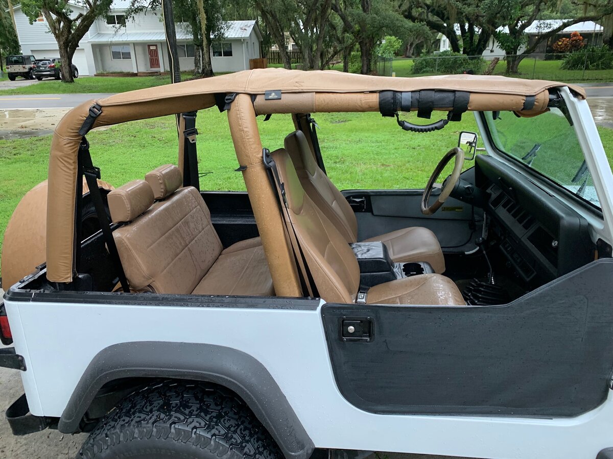

Agreed. Just had a repaint before I purchased. They didn’t do under the hood. At least they used the original color.White on tan interior is a great color combo!
If you have issues to resolve you are in the right place. There’s like geniuses and stuff hereThanks! It’s new to me and I have a few issues to resolve.

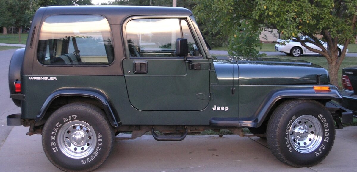

Cool! I will check for tire dates... but I do have smaller tires and wheels in the plan so if your really feeling nostalgic I think we can make a deal!Wow, that's really weird....I had those EXACT same wheels and Kodiak Gillette ATs 31x10.50R15 when I bought my YJ in Wichita, KS in July 2013. When I bought the YJ from my grandma, I swapped them since I needed to drive it 12 hours back to Texas. Tires were from 2001 or something, so I didn't want a blowout. Any idea where those tires and wheels came from? Mind checking the date on them? I'm really curious if somehow my old wheels and tires that i swapped in 2013 in Kansas ended up on your Jeep in Florida, lol.
Nice looking Jeep though. Only thing I'd do to it would be drop the body lift and go for OME suspension instead. Enjoy your Jeep. Here's a pic of mine from 2002 with the old tires. That will be crazy if you have my old stuff.

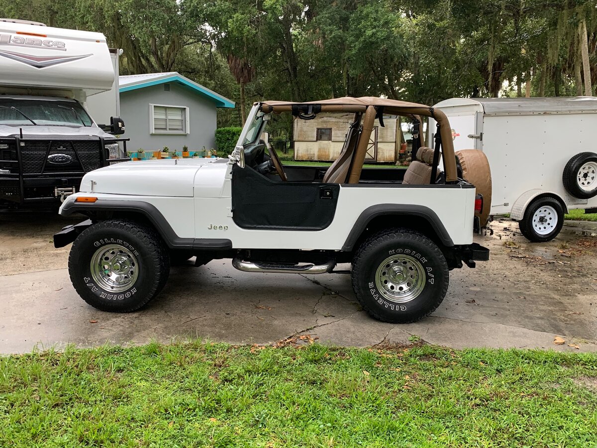

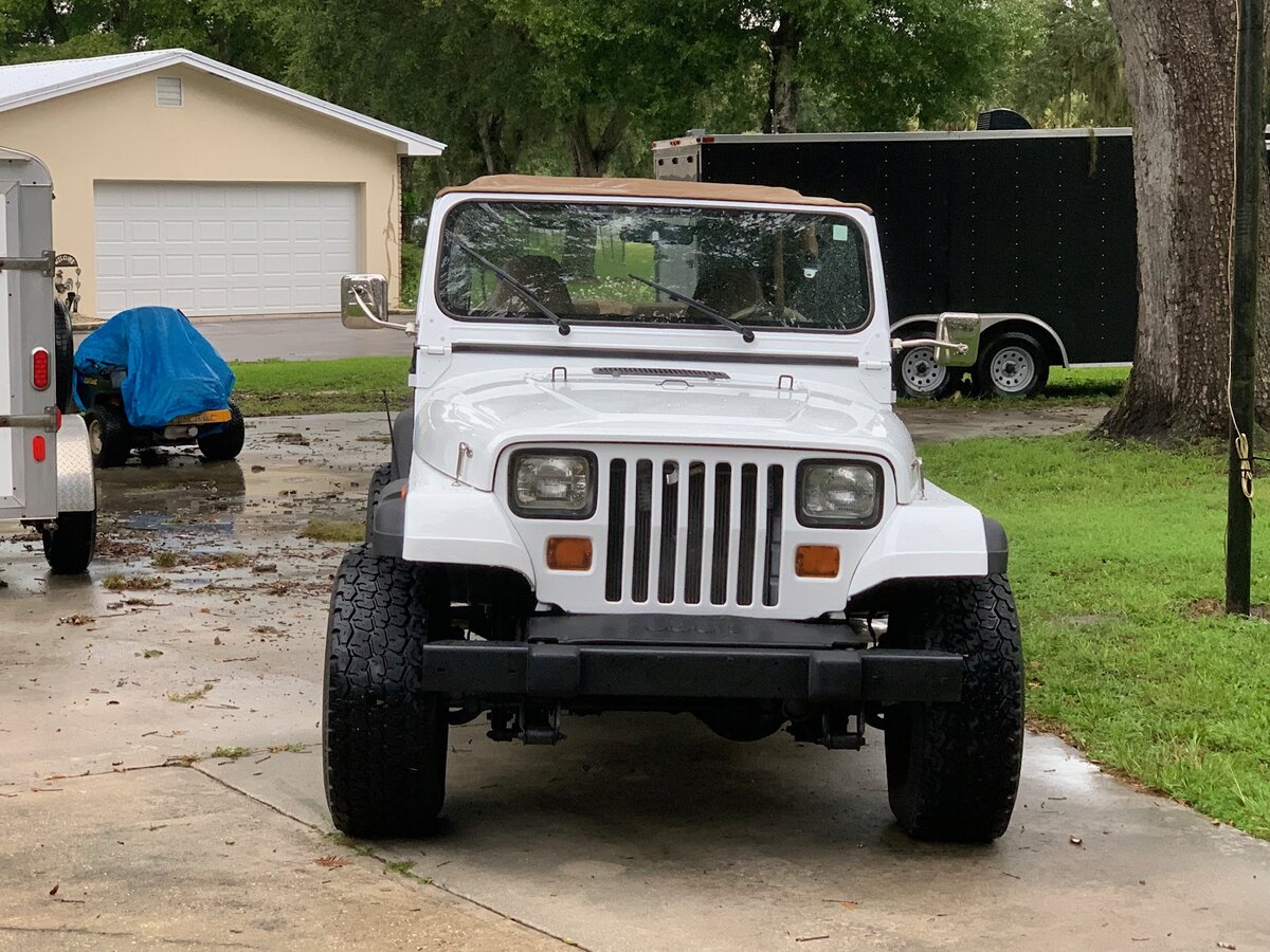

Appreciate all the good info. However someone has done what looks to be a 2 1/2 or 3” lift kit and a 3” body kit. Handles and drives pretty good but squeaks and groans some. It currently has a set of 33x12.5x15’s on it. I’m planning on working with my local 4x4 shop to evaluate exactly what it has and what it needs. I’ll work from there.4 36R Springs (Bought from Quadratec)

I can see the 3" body lift. Damn, if those Gillette's are 33's, then you don't have my old ones. Crazy how you have the same wheels I had though and that super rare brand/model of tire.Appreciate all the good info. However someone has done what looks to be a 2 1/2 or 3” lift kit and a 3” body kit. Handles and drives pretty good but squeaks and groans some. It currently has a set of 33x12.5x15’s on it. I’m planning on working with my local 4x4 shop to evaluate exactly what it has and what it needs. I’ll work from there.
I agree. The comment about the lift came from the seller. If you ask me, I’d say there is only a body lift on it. The suspension looks stock to me. More pics in a couple of days.Appreciate all the good info. However someone has done what looks to be a 2 1/2 or 3” lift kit and a 3” body kit. Handles and drives pretty good but squeaks and groans some. It currently has a set of 33x12.5x15’s on it. I’m planning on working with my local 4x4 shop to evaluate exactly what it has and what it needs. I’ll work from there.
