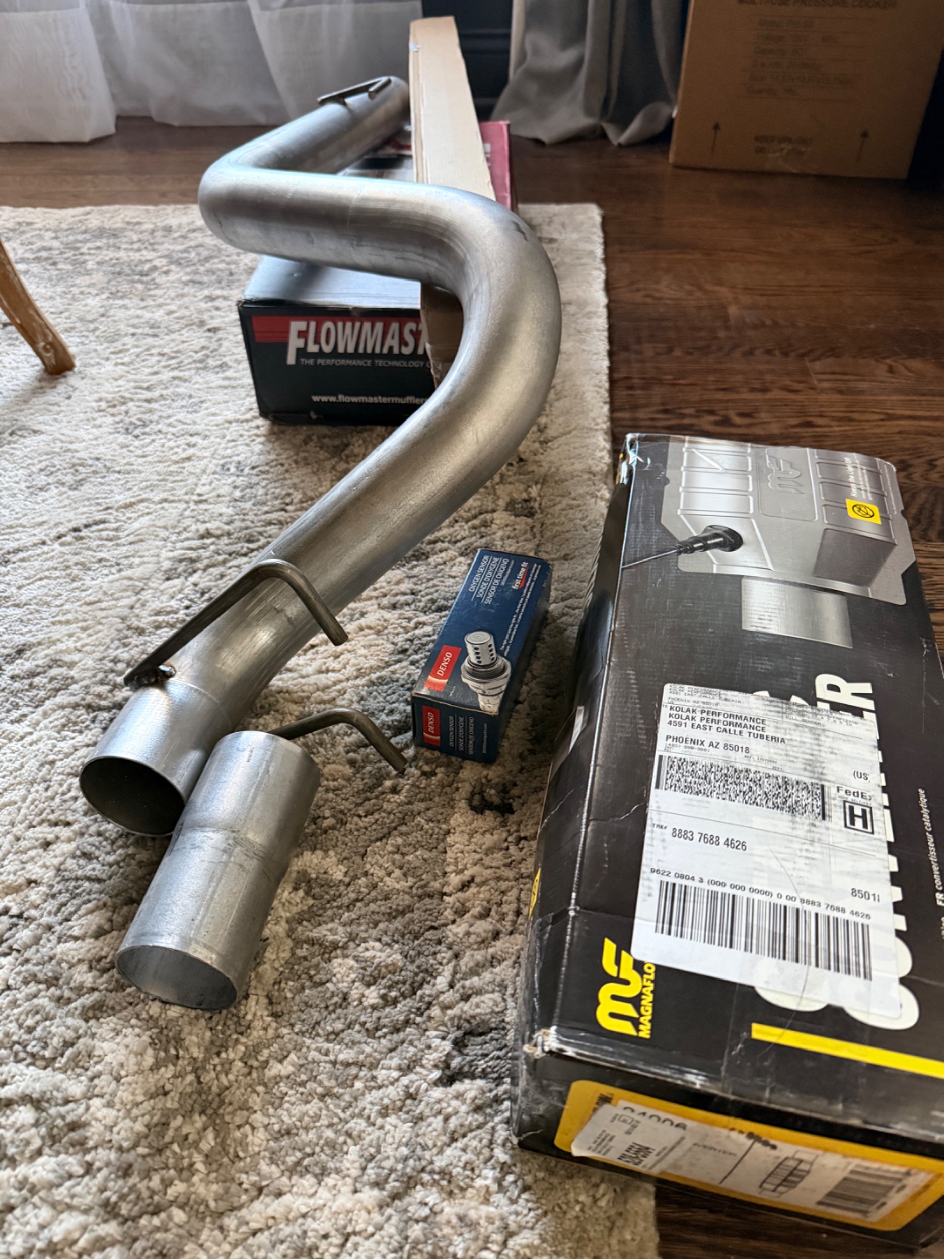

Hey Everyone,
Looking for some advice from those who’ve lived with different exhaust setups on a YJ 4.0.
My setup:
  • 1992 Wrangler YJ
  • 4.0L HO, manual
  • Currently being regeared to 4.56s
  • 31” tires now, likely moving to 32s down the road
  • Mostly stock drivetrain otherwise
I’m deciding between Flowmaster FlowFX, Flowmaster Force II, and Borla Touring, but I’m open to other suggestions if there’s something that really fits the bill.
What I’m looking for:
  • A sound that matches the personality of the YJ and the 4.0
  • I want it to sound right for an inline-6 — not trying to make it sound like a V8, because it isn’t one
  • Something I won’t get tired of, especially with the higher RPMs from the 4.56 gears
  • Minimal drone at cruising speeds is important
  • A little character under throttle is fine, but daily-drive livable matters more than raw loudness
Right now, I don’t have a working stereo, so the exhaust will be the only “music” for a bit — but I do plan to add a sound system eventually. With the top down, I still want to be able to hear my music without the exhaust overpowering everything.
I know any new exhaust will sound great at first, but I’m trying to choose something that stays true to the YJ’s character and holds up long-term.
For those running any of these (or something similar):
  • How’s the drone, especially with gears and larger tires?
  • Any regrets after living with it for a while?
  • Would you pick the same setup again?
Appreciate any real-world feedback. Thanks

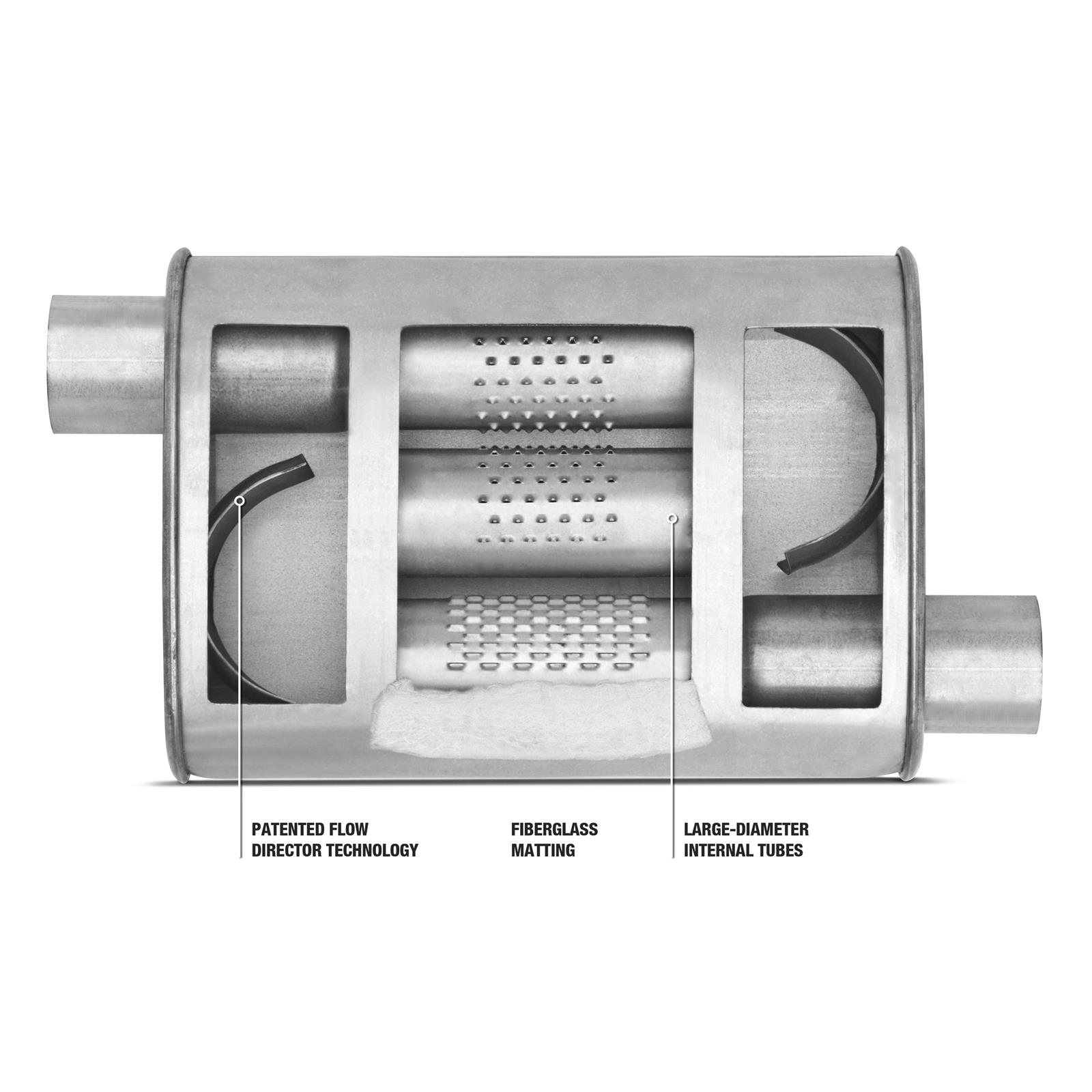

Turbo mufflers are similar to factory, but are built with less internal resistance. Usually shorter paths, larger tubes, more places for pressure to shortcut the path. Dynomax:
The Banks is a straight through design. You can look through it.
Reactions: SquareFace
