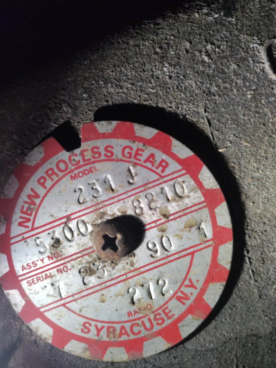

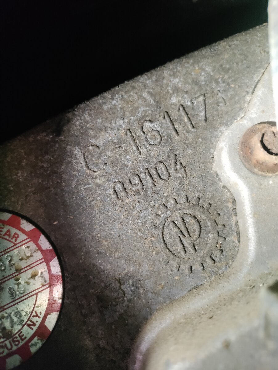

wrong transfer case bought. year., he put in a way newer box. NV321-J

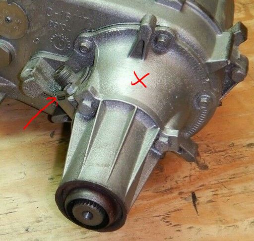

the question begs, can the tail shaft housed be swapped. old over new,.

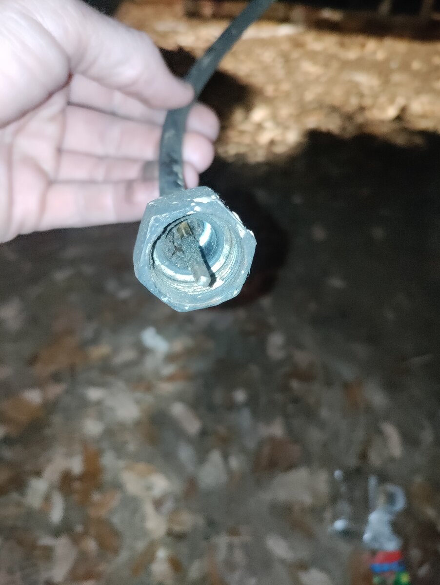

GPS speedo';s work but are laggy as we all know, and why.

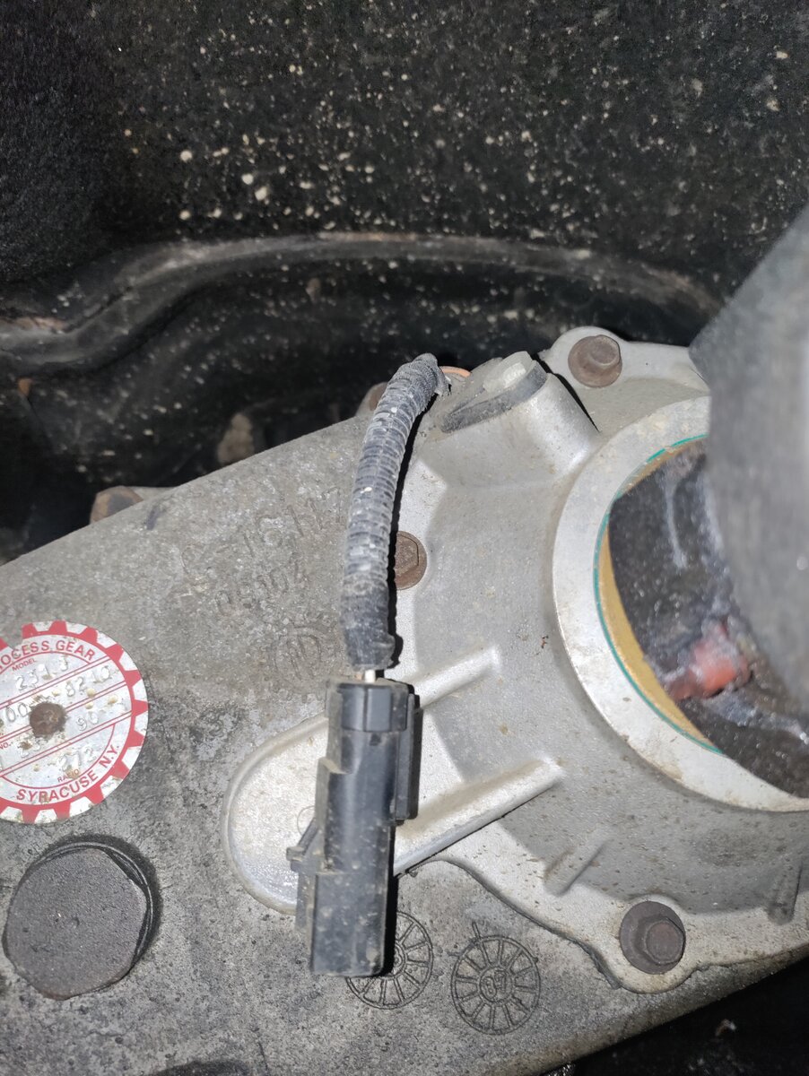

my 95 is electric VSS.
missing this, can be super hard to cure, lots of changes beside , this part happened.
mine is electric , vast sellers of xfr case (all) show cable 231 fits 95 and does not.
NOVAK web site names the truth here
Early 231s from 1988 through 1991 (had mech, speedo cables)_ also changed is vacuum controlled front axle.
the input splines are also , key factor on xfr case swaps, back then,. or HD version of NV231.
can 90 5 bolt rear housing fit your way newer transfer case. mech over newer electronic 231 case? IDK.
