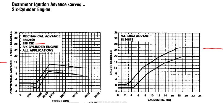

the stock BBC 4.2 runs ,a dizzy mech, pure advance so you keep that and run ECU with no spark controls?
so planning to run the stock DIZZY
here it is , FSM quote
if yes, a fuel only TBI system can be tuned, (and if not using a EGR valve , stopping ping can be hard, the simple sure is running richer fuel maps) the CR is 9.2:1 compression ratio. so not too hard to avoid ping.
the static time is 9 D-BTDC (below is engine degrees not dizzy on a test stand)
if the dizzy rusts in side, the fly weights inside jam and no advance and power is now weak
same goes for cracked vacuum advance diaphram. we look at that first.

but 1000 new TBI will never fix the bad DIZZY , ever. (those $1600 kits are zero spark ECU)
try a new VAC advance first and clean the advance weights and the rusted do zero spring bad or missing.
