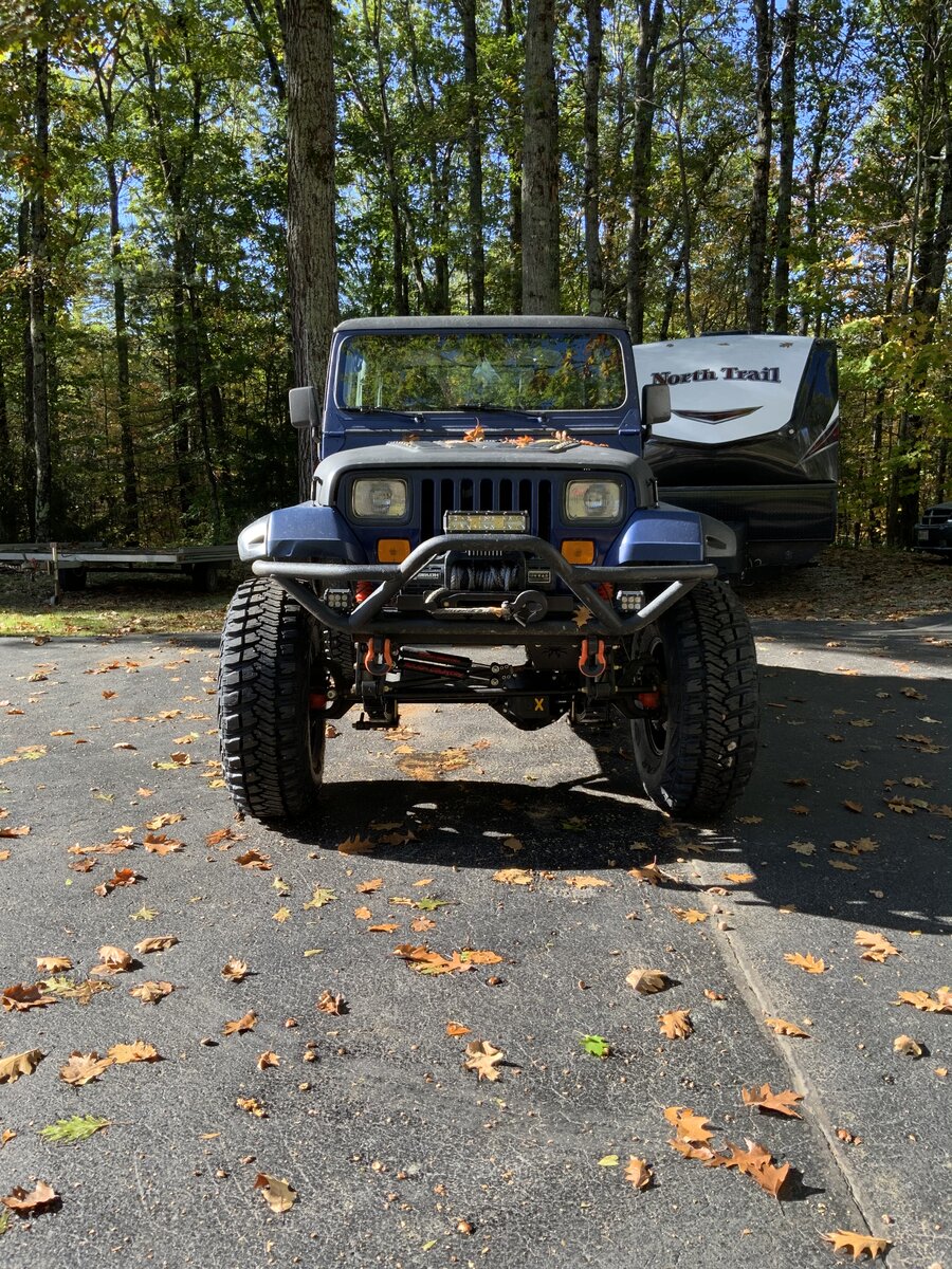

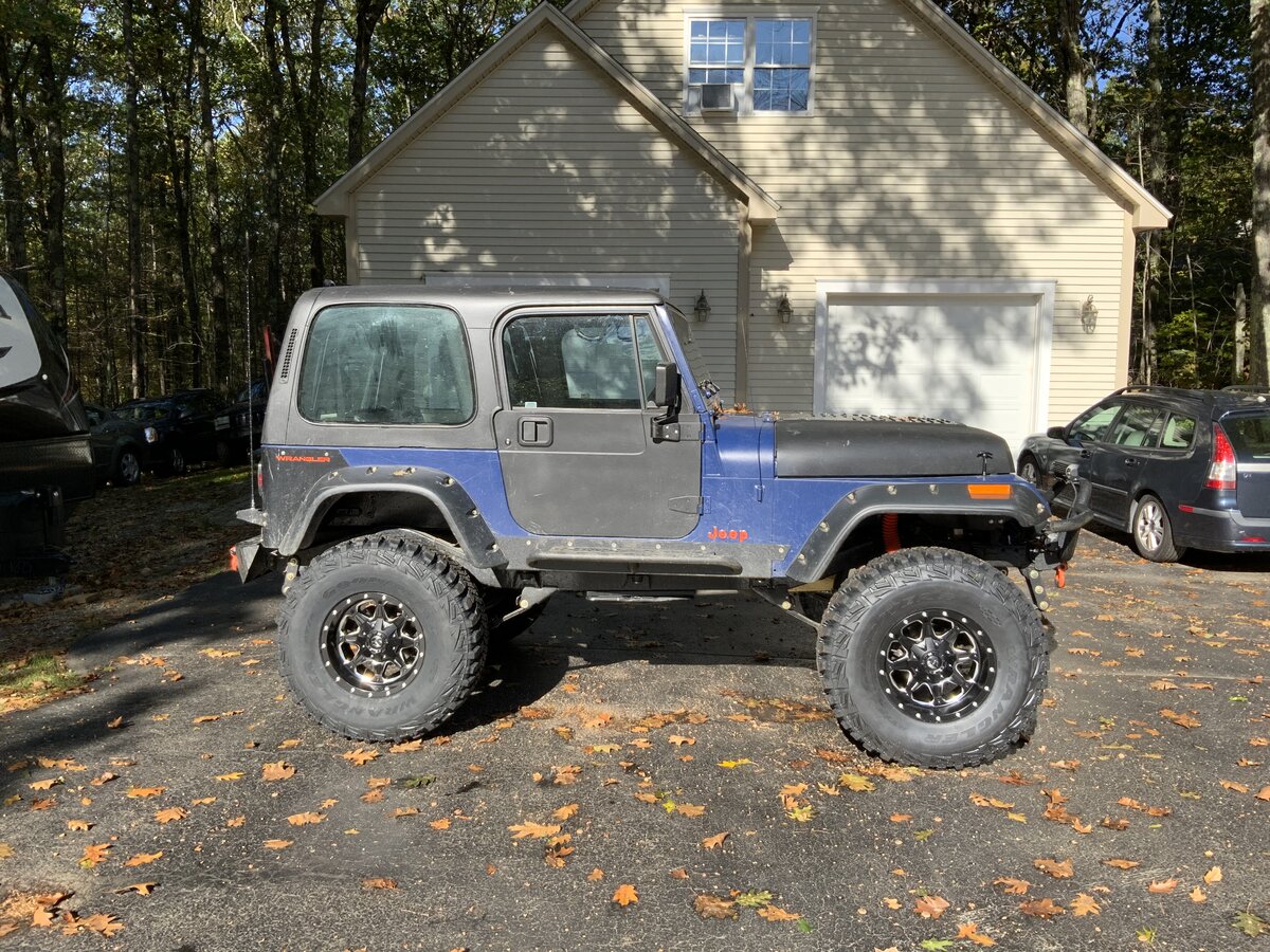

This is what she looks like
Looks great! Not sure where to start with the RPM limit.
