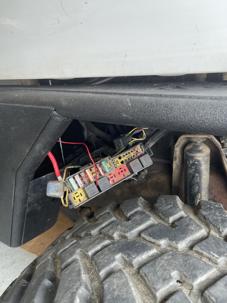

So I few weeks back I put new fenders on my Jeep YJ. The fenders are flat and have my fuse box exposed. While making a turn my tire rubbed on my fuse box and my Jeep just shut down. I thought it was a relay or fuse. I checked them all and they were good. I thought it was my neutral safety switch or ignition switch. So I swapped both and still nothing. I finally was able to get it on by running a wire from my starter relay to the positive Battery post. I could get it to turn on but only if I would hold my key to start position. As soon as I let go it would shit off. So I did more digging l. I was able to get it to stay on but only if I ran a wire from my fuel pump relay to the battery post. So I had to run 2 wires from my starter and fuel pump relay to get it to turn on.
Just wondering if anybody can help me fix the issue. It’s a 92 YJ 4.0 automatic
