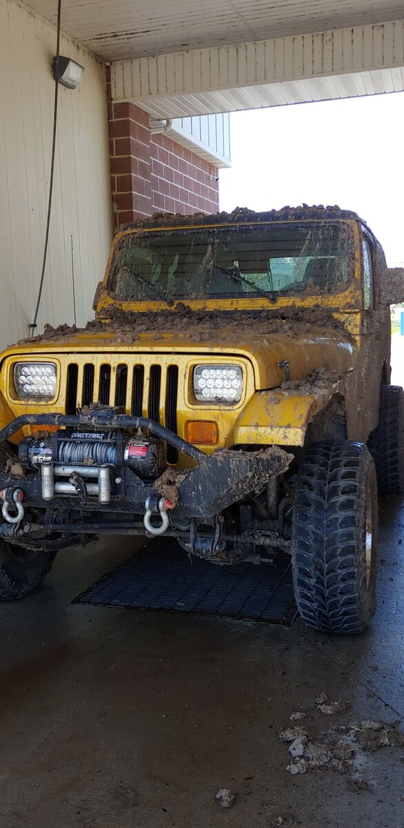

I want to run 35's on my 95 yj 2.5L so I was wondering if I can re-gear my transfer case instead of regearing my Dana 30 and 35 seeing how they are just going to get swapped out in the next year or so? I don't really care much about the high end. I never leave the valley I live in.
