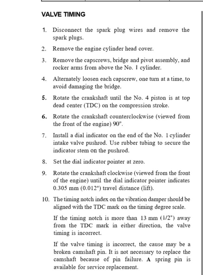

There is a way to check the valve timing without removing the chain cover. It's done by measuring the cam lift on the #1 cylinder INTAKE valve as the #1 piston is at TDC. You will need a dial micrometer.
This describes it on page 65 of this manual: https://oljeep.com/JeepEngines.pdf

Thank you for the input I’ll check that out soon! I did a pressure check a wile ago when I did the fuel pump, filter, injectors, and lines and it was where it should be. but it won’t hurt to check it again. Thank you again!
