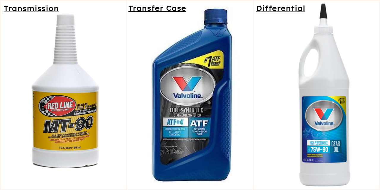

I use Valvoline VR-1 10W-30 motor oil and for the rest I use this.
