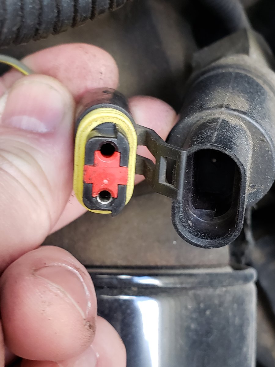

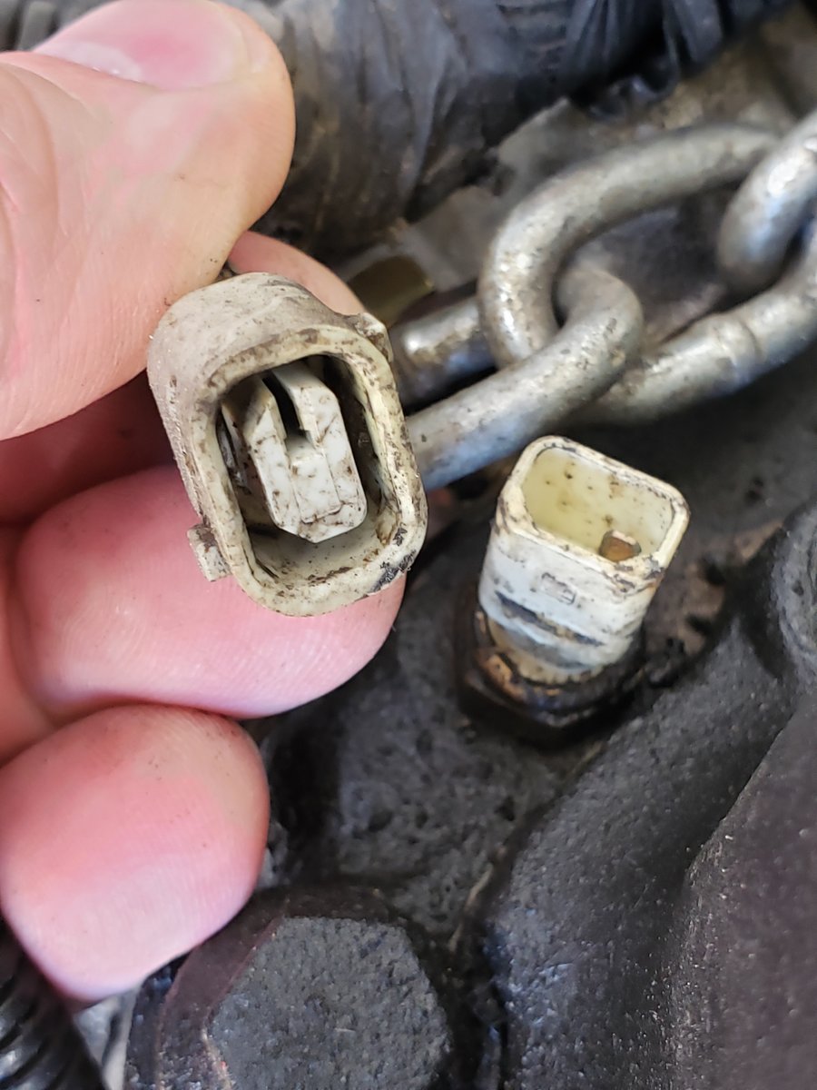

Has anyone had any luck finding connectors for the gauge senders (fuel injected)? No one seems to have these...
Temp (gauge) sender:
And oil pressure sender:
BWD might have both, I believe they have the two wire oil pressure connector even though mine only uses one wire.
Their website search in a pain to use.

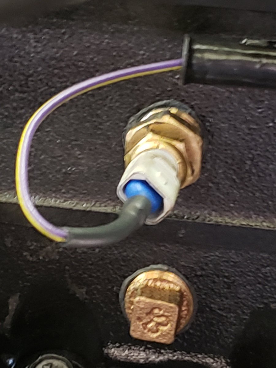

Well, it turns out that the terminal in the temp sender is sized and positioned like one half of a regular quarter inch spade connector, and the housing fits the insulated female spade connector just about perfectly...

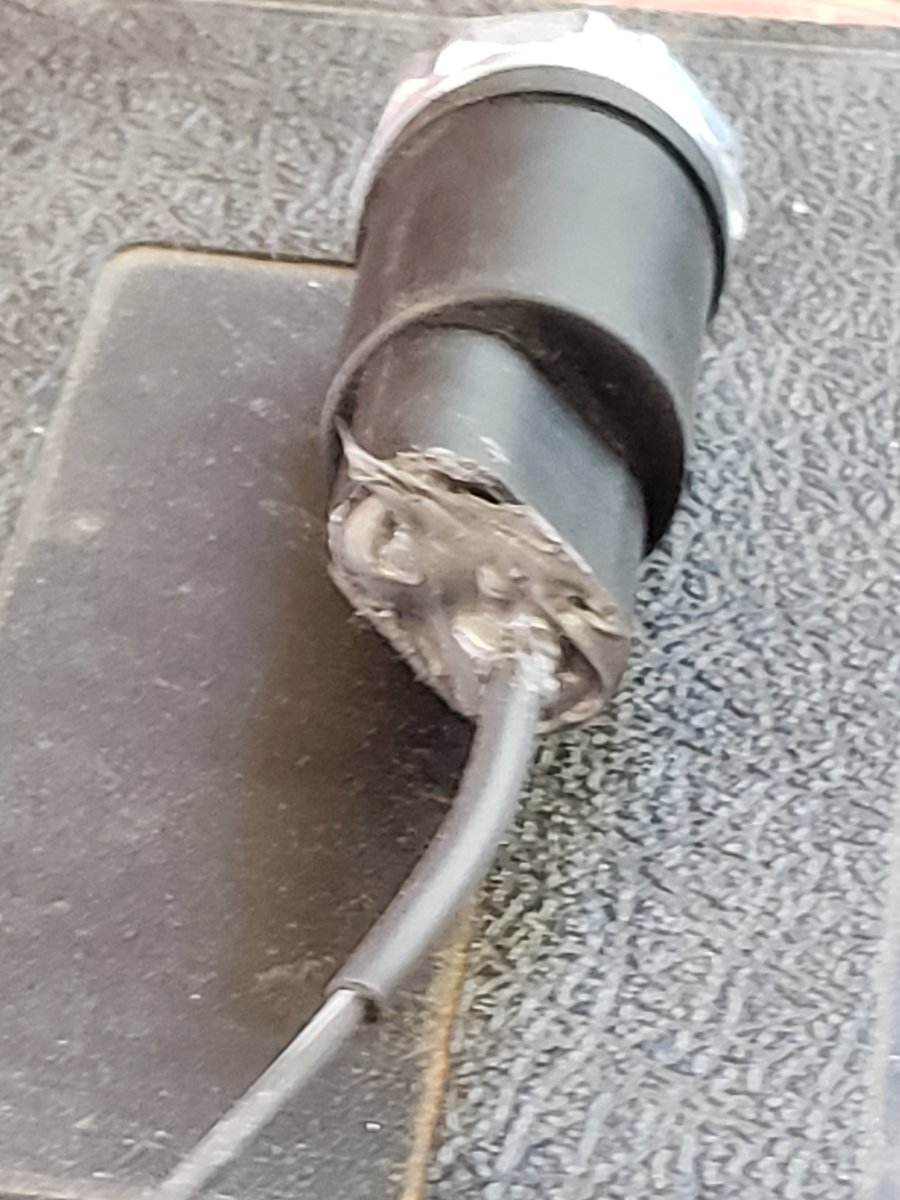

As for the oil sender, it's round terminal is a good fit for a female Weather Pack terminal. Some heat shrink tubing and a little silicone, and...
I'll give it a bit of a pigtail and put a regular Weather Pack connector between it and the rest of the harness. I think it will stay put just fine.
