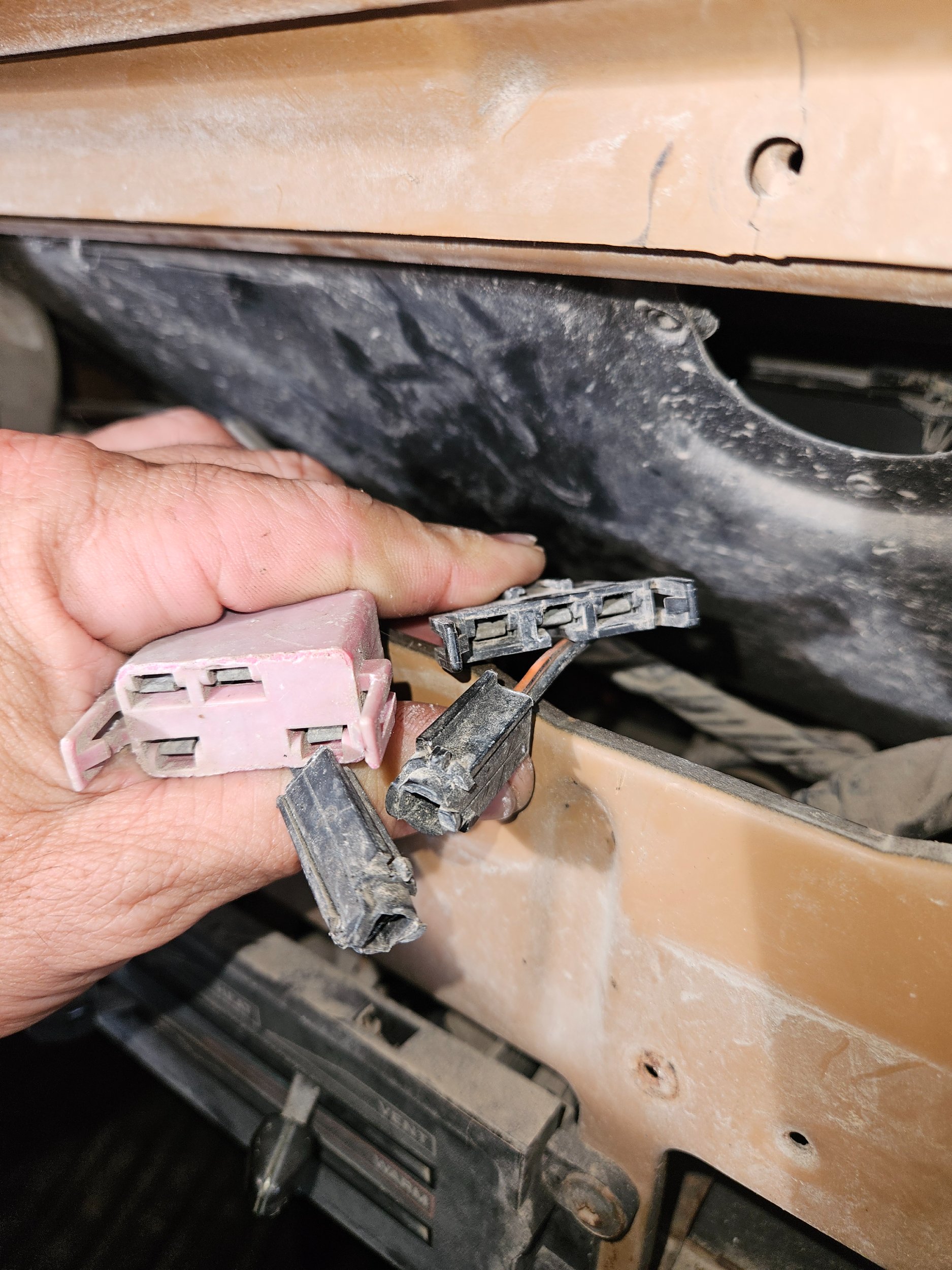

Any idea what these three connectors are for in the Dash, the two small ones are the same.
The big ones are for rear window wiper/washer and fog lights. The smaller ones I’m not 100% but I think possibly for the heater control (blower motor power). The connectors look like they are for that, however the color of the wiring is weird. Does each connector have two wires or is it just a black/orange color scheme on one wire?
I thought blower motor wiring was white on early years and green on later years so that is also part of why I’m really not for sure what the wiring is for in your pic.
Trying to wire in a new stereo and someone previously cut the old connector off so just trying to figure out the wiring and seen these tucked away. Thanks for the reply BTW
Juat black and orange, read something they may be for light bulbs but not 100%
Black and orange one wire or two wires, a black and an orange?
Orange is usually dash illumination but I don’t recall any dash illumination locations using a spade connector like that. Only connection I know of spades is for some door switch wires and the blower motor.
Definitely none of that is for the radio, radio wires will be further down the line to the right. Should be right behind the radio slot.
