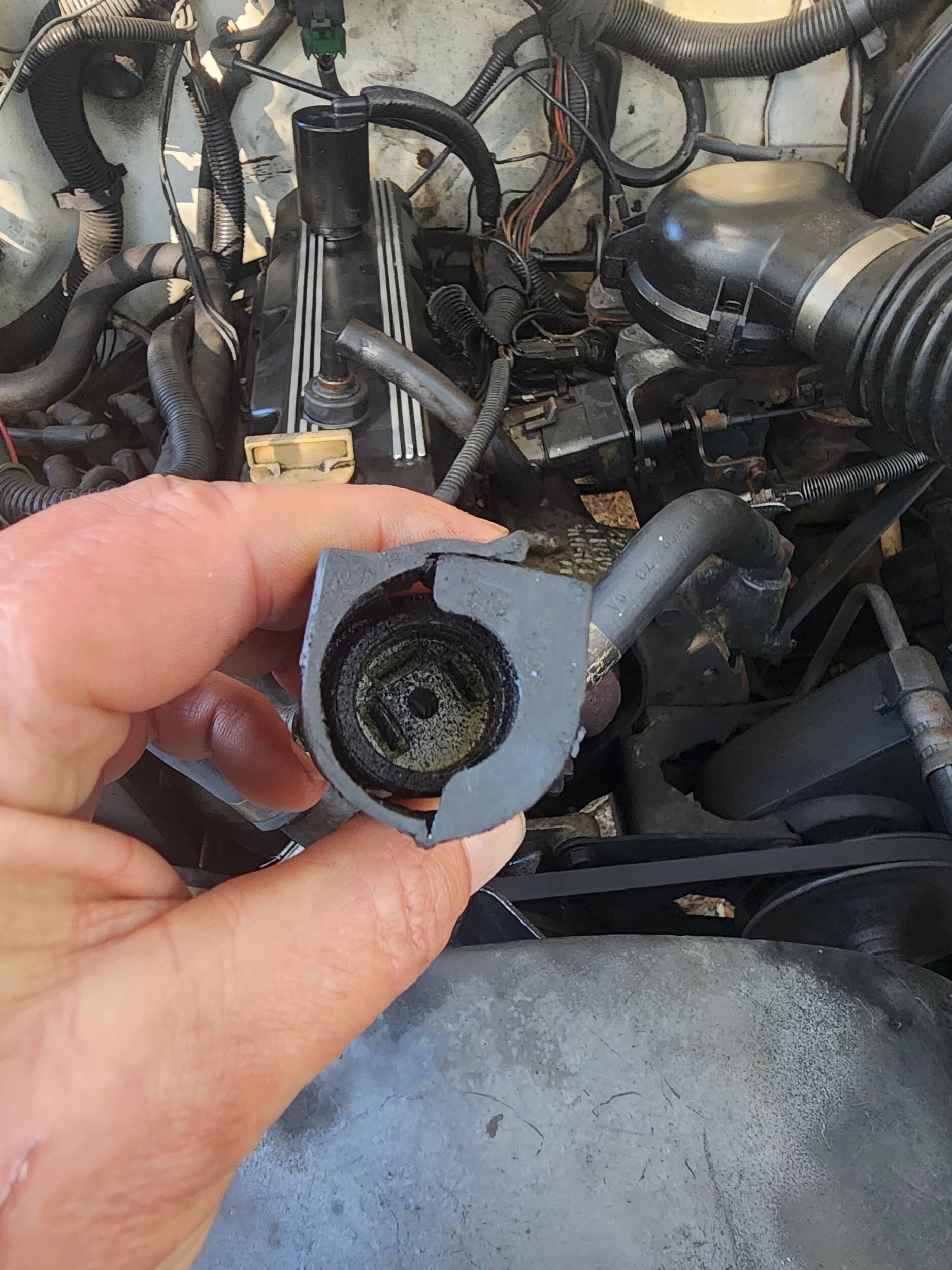

Sorry about the post. I just bought my 1989 yj. I saw this just hanging and unhooked. Its coming off main harness. Can someone tell what it's for. Jeep runs fine. Winch connector ????
AC pressure switch connector. If you don’t have factory AC then it just dangles. Aftermarket AC usually doesn’t use that.
Factory or aftermarket? I know cars. I have zero clue where this would plug in. AC clutch not kicking in.
Looks aftermarket. If the factory shipped a YJ with AC, it had it hooked up to factory connectors. That was different depending on year, later models like 92-95 I believe had a pigtail under the dash to connect to. Doing so allowed the engine computer to run the AC so it could control the idle speed too for smoother operation. I don’t believe 87-90 had any such thing, they all hooked up power to the fuse box no matter what as far as I’m aware.
However, the factory wiring would be that pressure switch connector you pictured. I’m not sure where else a factory AC unit would have hooked up to that, somewhere under the dash probably. But that connector is 100% for a AC pressure switch. The pressure switch would be mounted on the drier.
Some aftermarket ACs (including the one my YJ came with) literally just apply power to the compressor lockup as soon as you turn the blower on. Didn’t have a pressure switch at all. But that’s aftermarket. If it was factory it would have utilized the switch and that connector.

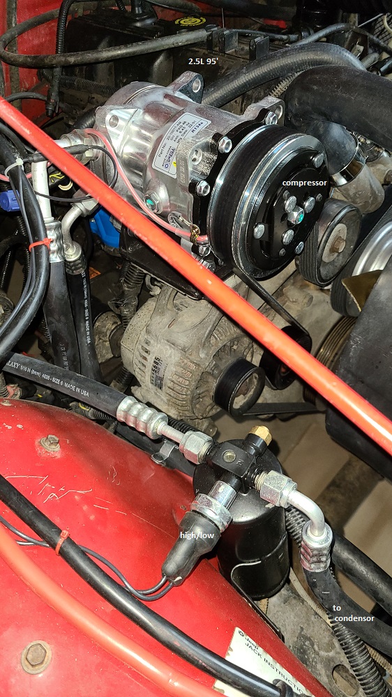

my After market has same dash evap, blower there, I installed mine. (all)
mine has high/low switch right fender on top of receiver driver unit.,(see photo mine) yours is different model A/C)

see the A/C compressor, see the 2 huge hoses. the condenser, up front goes to the receiver dryer, and the switch.
mine is very powerful A/C even on 110f day
