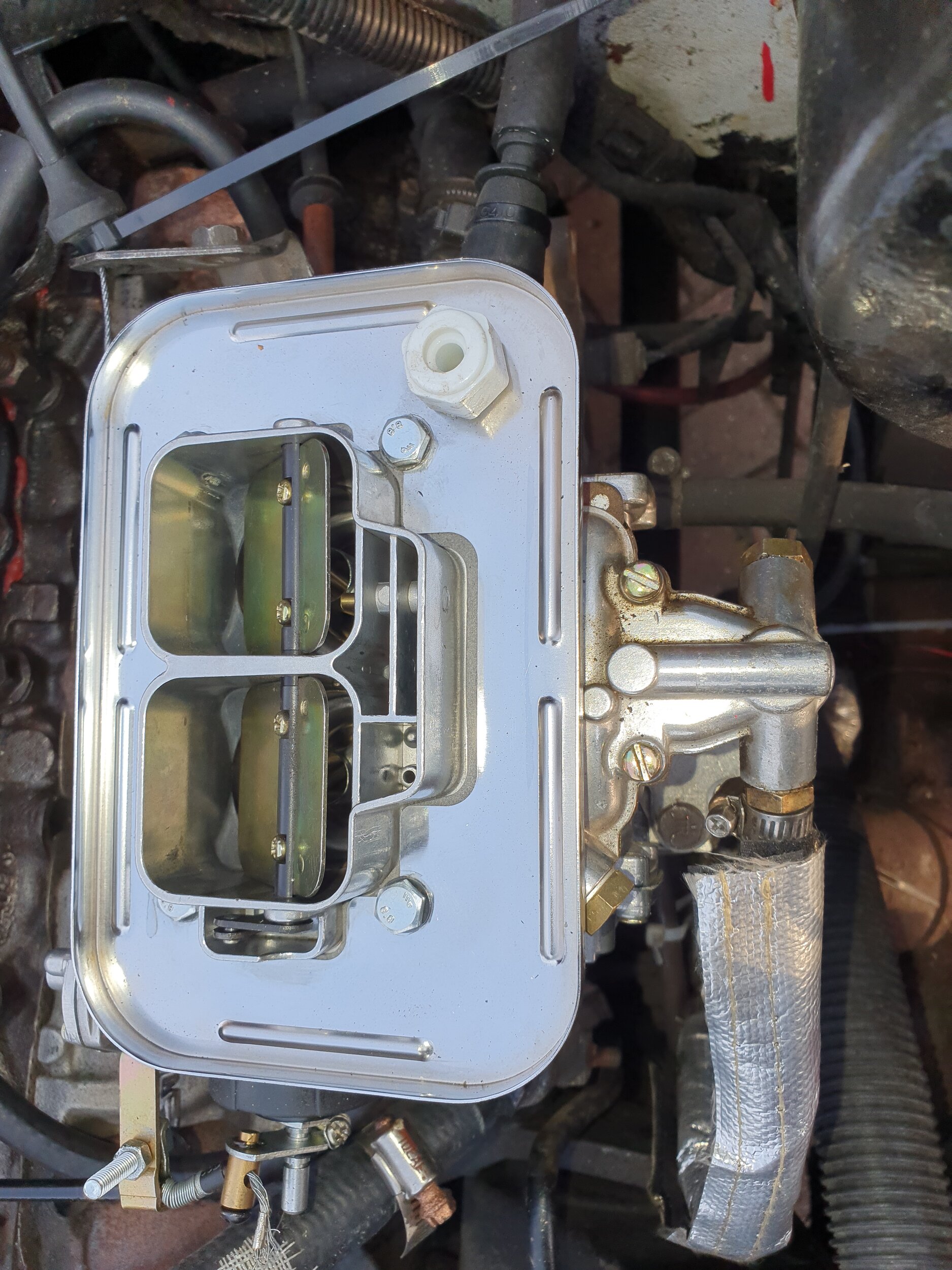

Hi all.
Got round to work on the fixes and spotted this brown stain in the carb. Never seen it before. Put my finger underneath and it was slightly wet and is definitely petrol.
Do I tighten that bolt up? Is it leaking from above and down to that bolt because there is similar brown residue in the assembly too?
What could that be caused by?
Pump is set to 3.5psi as recommended and there is fuel in the pipe hitting the carb opposite the dirty bolt?
Also, with the choke on fully, this is as far shut as my plates go. Is that right as I thought they should be almost totally closed when the manual choke is engaged??
Up date. Fiddled with the low idle and high idle and the mixture screw and for now she is running steady and stays on when I fire her up.
Not totally sure what I did , started from scratch and just tuned screws around until she ran smoothly.
I need a lesson in carb tuning.
I think the screw attached is the high idle.....
That choke looks about right. But the stalling problem after driving for hours at speed doesn’t sound like a problem with too little choke. The first place that I would start is adjusting the idle speed up a little. That may make it idle faster than you want when cooler but possibly not stall when hot. And yes a real Weber carb would have been a safer choice. You are not really sure what you are getting with a clone.
Reactions: jpjeep26uk
Hi YTradio, ill probably start looking into a genuine weber carb soon. I can't seem to find a picture or advice on my particular clone version. Apparently it's from a VW camper van website as they work on YJs with a slight mod to make them fit direct to the intake.
I did what you and other have suggested and yep, raised the idle speed higher and she runs but I feel she's over running at 1200 rpm at lights and stops etc.
Hi, I did that adjustment and yip, that fixed it. I baselines the mixture then adjusted the idle and its now idling at 1200 revs. A lot higher than usual but at oesst she starts, stays on and doesn't stall at every stop sign. I'll buy that for a dollar.!
