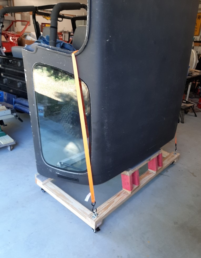

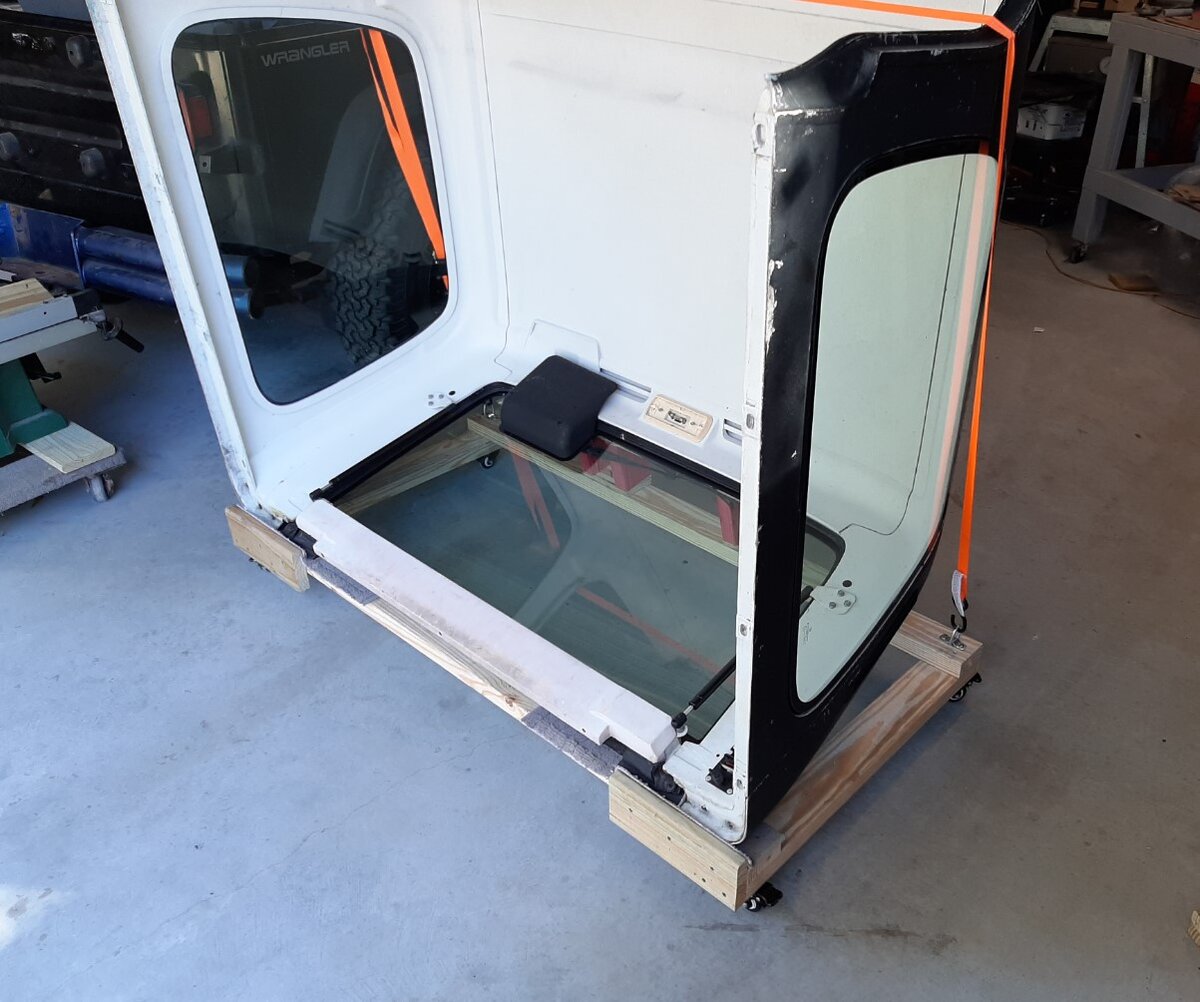

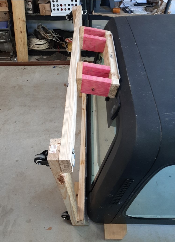

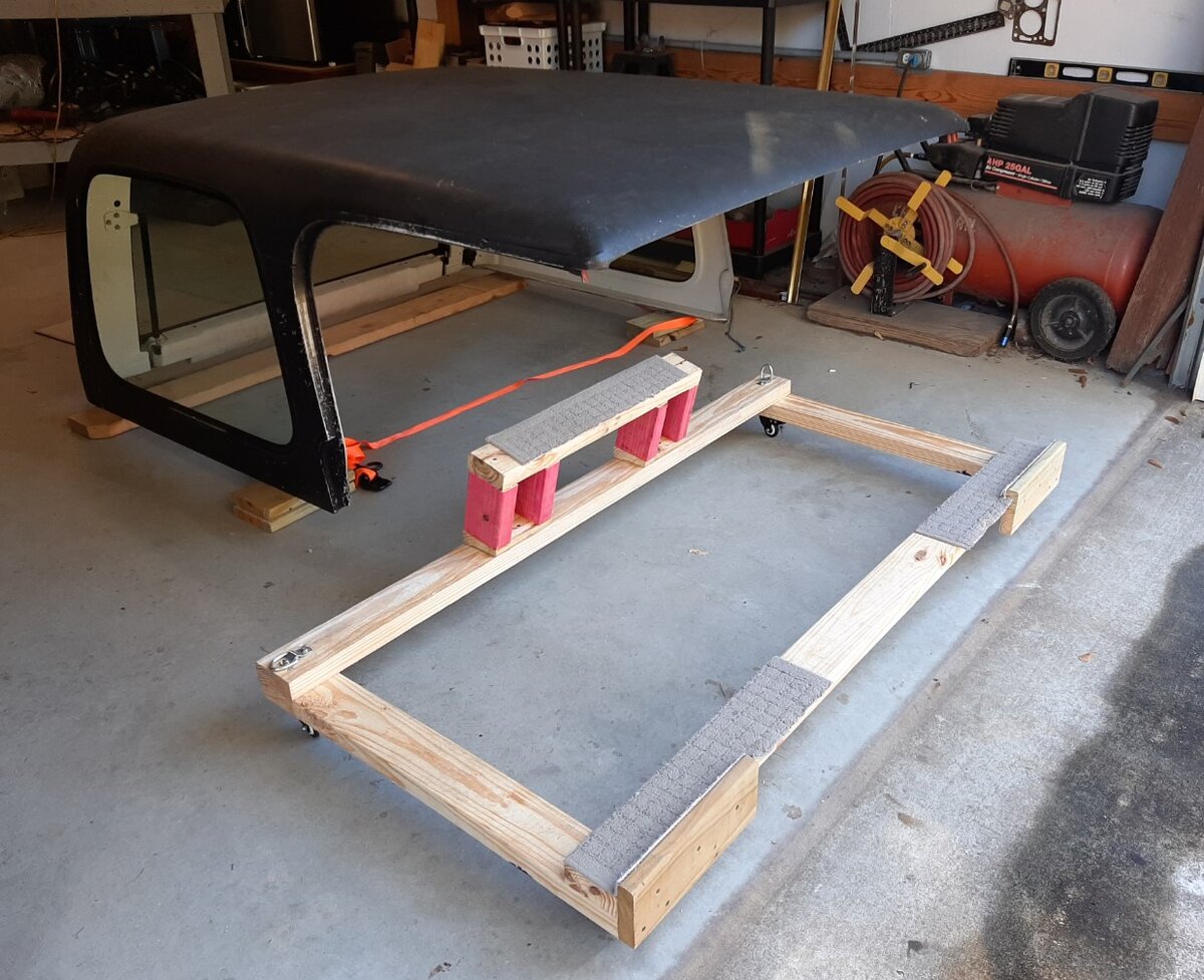

I finished a little project for storing my hartop when not in use. Simple design copied off the internet with a few minor changes. Once the dolly is strapped in place to the top I just raise up the front so it sits on the wheels and roll it off to the side. Lowering it back down is just as easy. This also made it much easier to apply a new foam weather strip along the sides.

Thanks, The way my shop is now I'm not sure the engineered roof trusses can support the weight without doing some modifications to them. It's not a lot of weight to hang but I'll need to tuck it up in the corner if I decide to do that. In the mean time I had all the materials for the stand except for the casters so it was just my labor.
