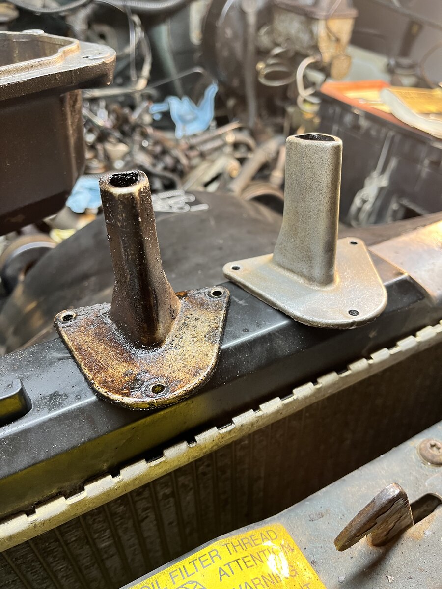

Hi all, had a leaky valve cover gasket and ended up tearing it all apart for a good cleaning but am now having trouble finding replacement gaskets for the “air vents” that are in the top of the valve cover? See picture….
I just used some Permatex gasket cement, the type for high heat and engine oil. Can't recall which one but I think it was Ultra Black. No paper gasket.

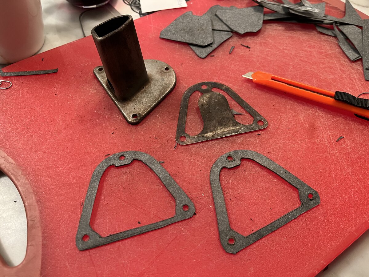

I ended up buying gasket material and made my own new gaskets by hand and will now apply permatex to seal it all up. Not the most beautiful job but it will definitely do the trick.
I made four gaskets, one for each side of the metal “membrane” if that makes any sense at all.
