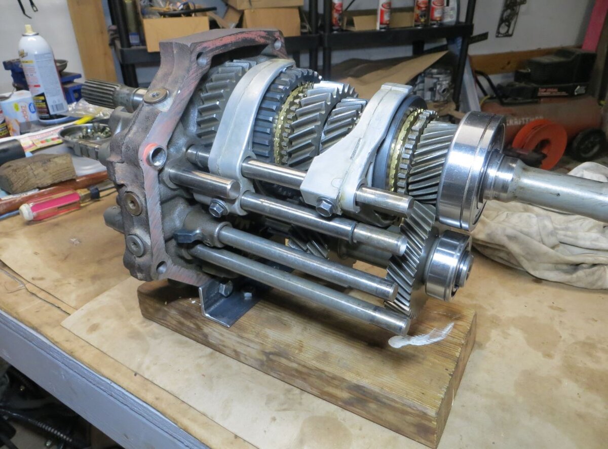

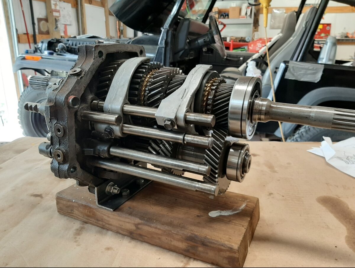

This is the second manual transmission I've worked on and I must say AMC/Chrysler made it very easy by design to take apart and put together. The Factory Service manuals are a must and they do an excellent job explaining each step. The only special tools were a gear puller, hydraulic press, feeler gauge, small pencil magnet and a really good set of snap ring pliers.
For me the worst part id disconnecting everything and pulling it out or getting it back in. Once I had it on the work bench it was easy. You can see I made up a simple angle iron bracket on a wood base to mount the centerplate to which made it easy to move around and keep balanced. Just watch out for small springs and locking balls which tend to roll away faster than a 10mm socket.

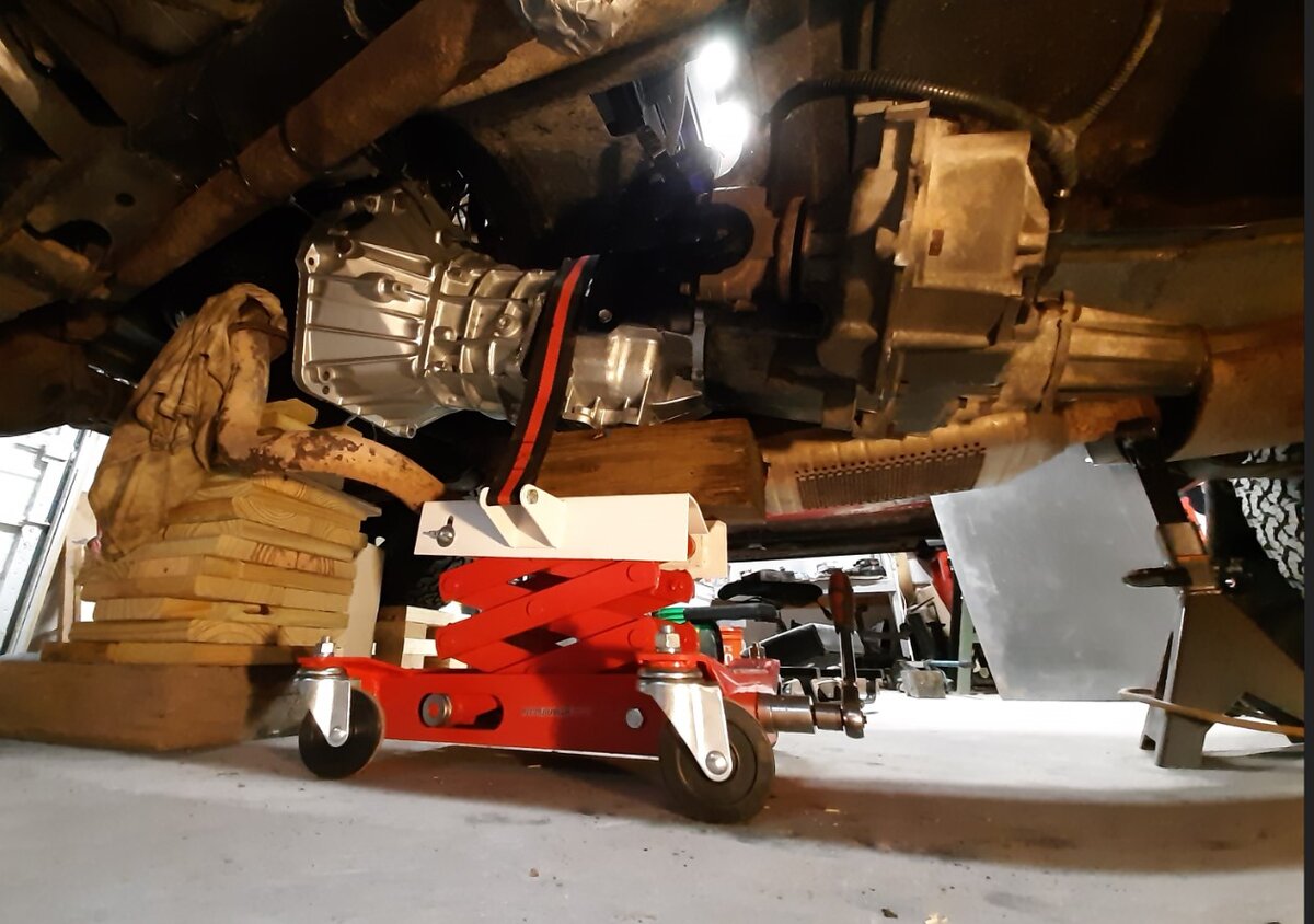

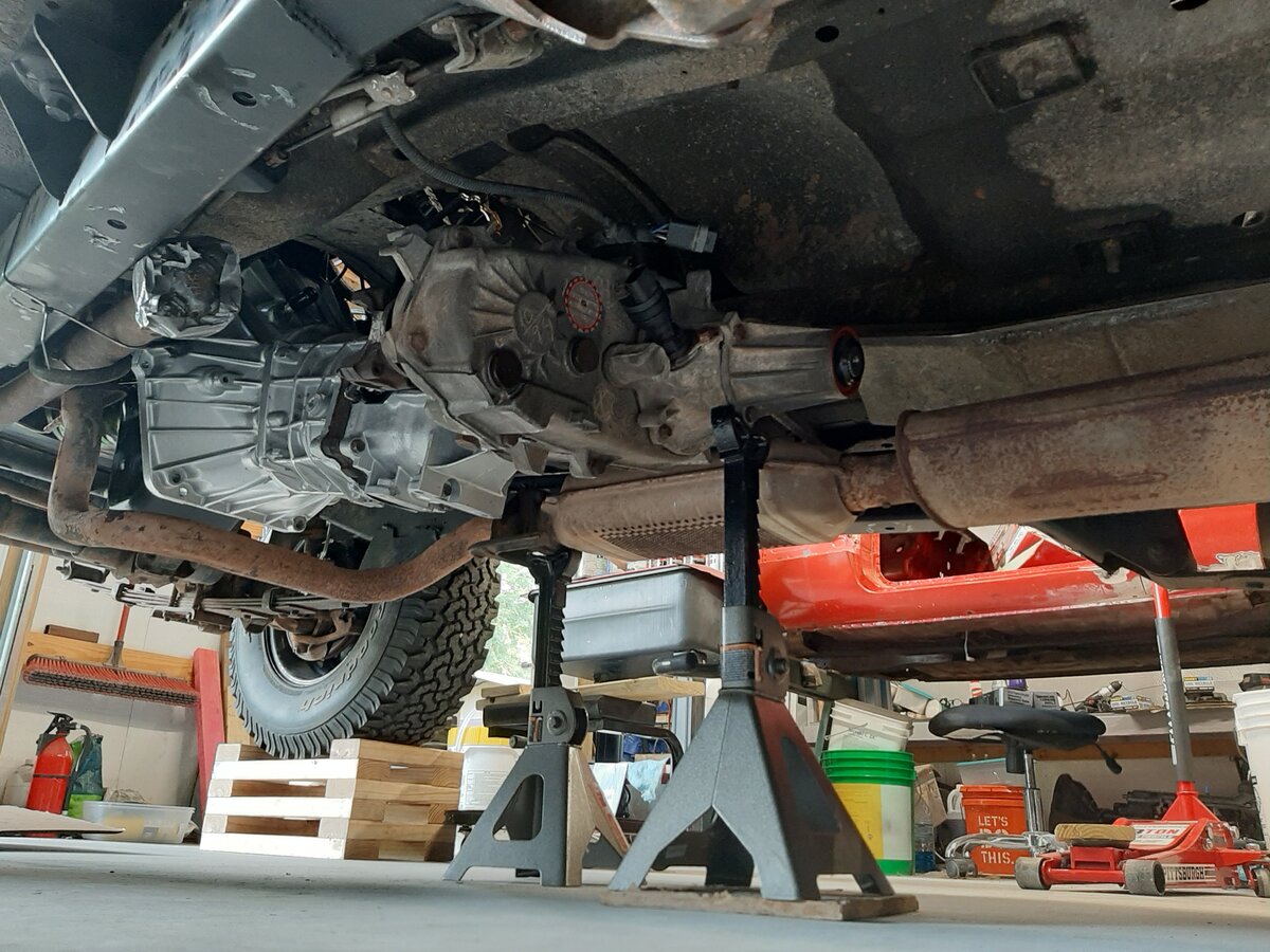

So now I have everything off the transmission and transfer case with fluids drained. I just need to get the jack in place and unbolt it and pull it away. The oil I drained sure looks dark for very few miles. When things settle out I look for gold and silver at the bottom.
The good news for the day was everything underneath looked clean and new and I didn't have a single rusty bolt or nut to contend with. Could not have been easier so far.

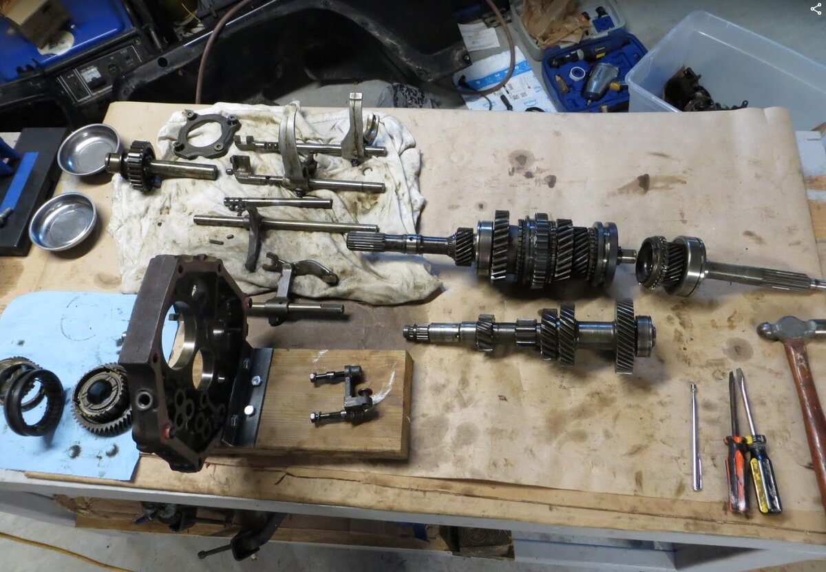

Well dang it. 100% my fault when I put it together last time I left off a retaining clip on the end of the main gear shaft at the end of the 3rd - 4th synchro hub. Without that clip the entire shaft shifted slightly causing the 3 & 4 synchros to bind and 1 & 2 synchros to have too much space.
I moved less than 1/4 inch and I'm glad to find no damage to any internal parts. It just made it hard to shift. Glad I caught it when I did. Gaskets on order, might be together next week.

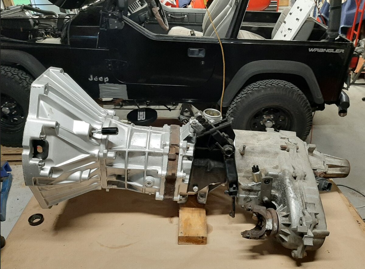

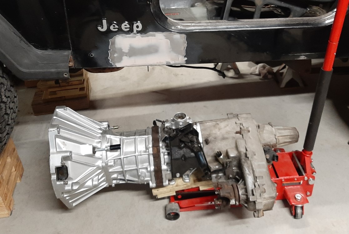

Assembly complete... I said that last time too. Just needs to be back in the case and back in the jeep.
I 'm feeling much better about it this time.

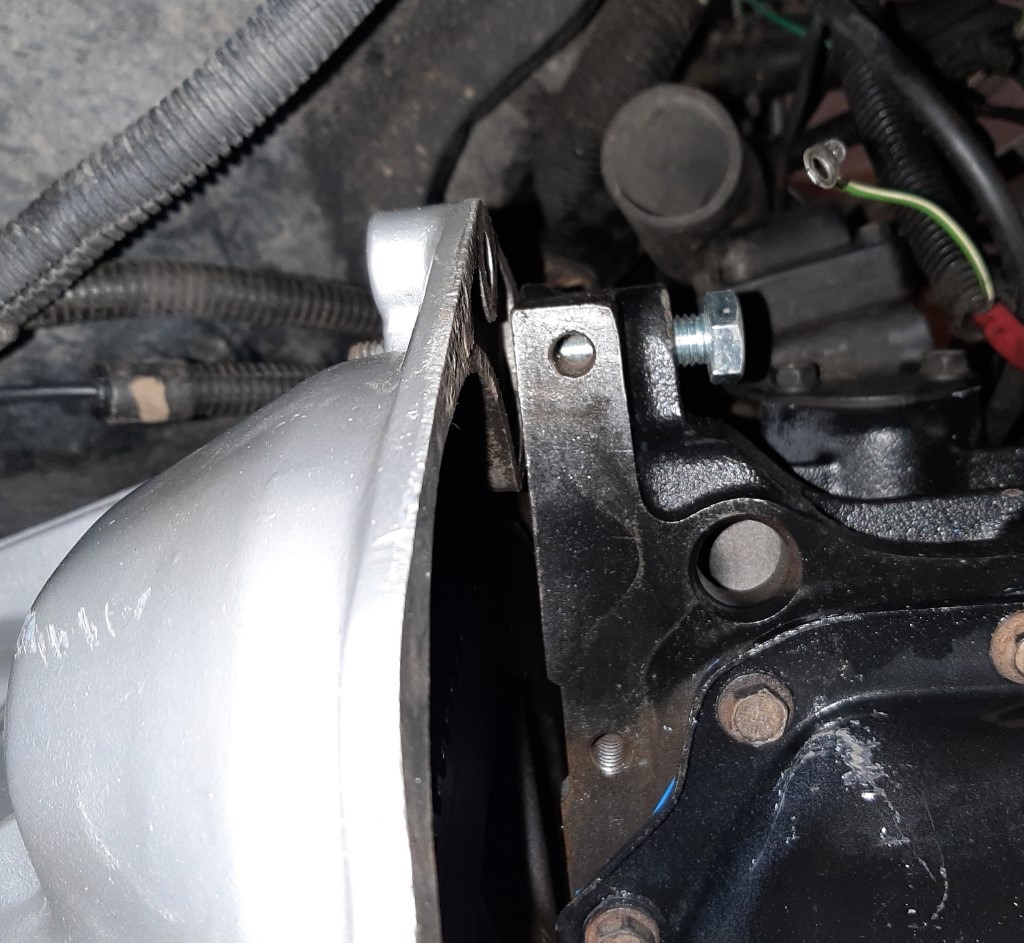

Finally got some free time to get the case on and everything back together.
Tip of the Day.. Before trying to align the bell housing to the engine block screw in a couple of long guid bolts backwards through the block fist so they extend out the back. This makes aligning the transmission 100 times easier than without them.
A few more hours and I'll be done.
