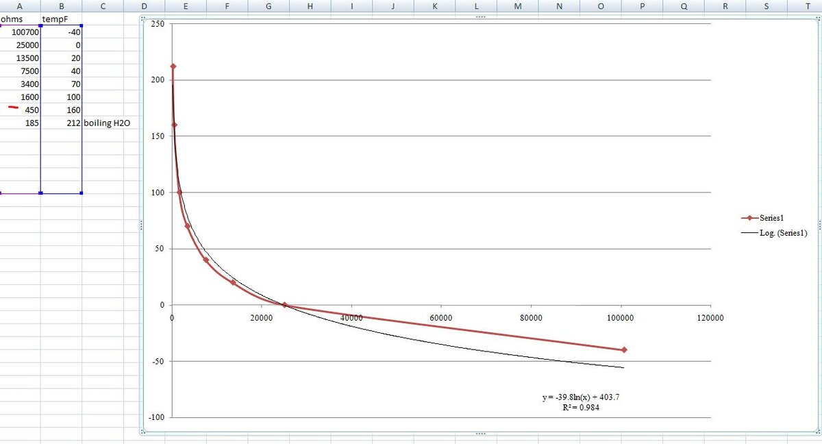

here is my excel full plot. IAT/ECT
the black line is exel doing the logrithmic ,best guess, math. smart as it is. and loved by many, using only jeep data

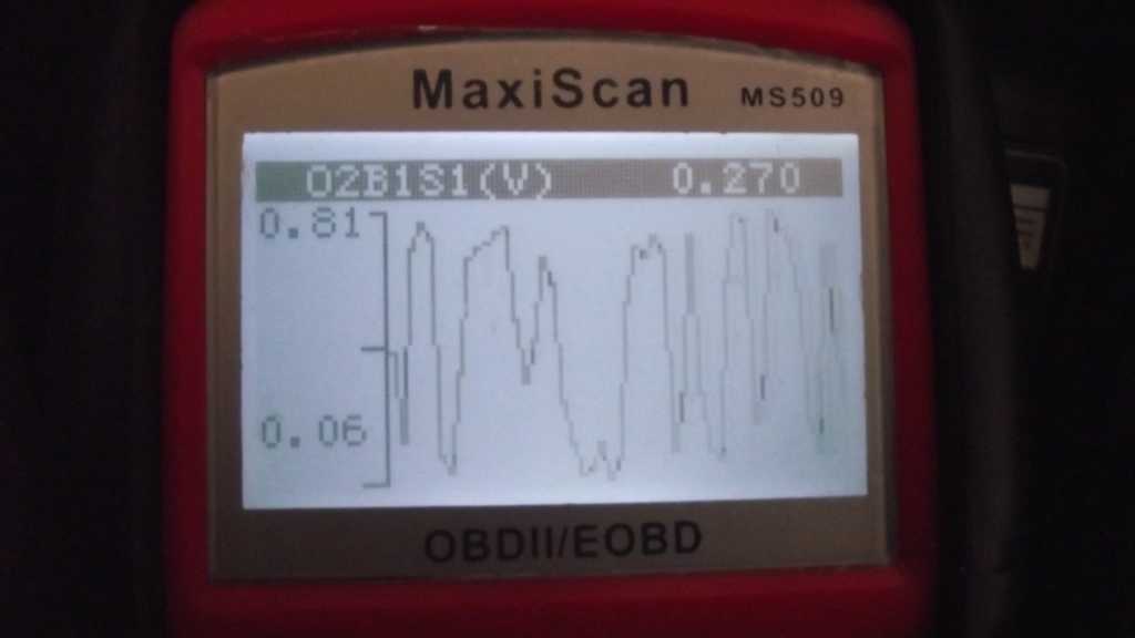

here is OBD2 doing, a simulated 02 scan plot, the O2 output swings fast. (real data on real car) not this car. on 1996+ up.
that swing is the PCM trimming fuel on the fly, fast. 6 times second possible
it swings so fast this cheap tool can not see all the swings, but we know it did
