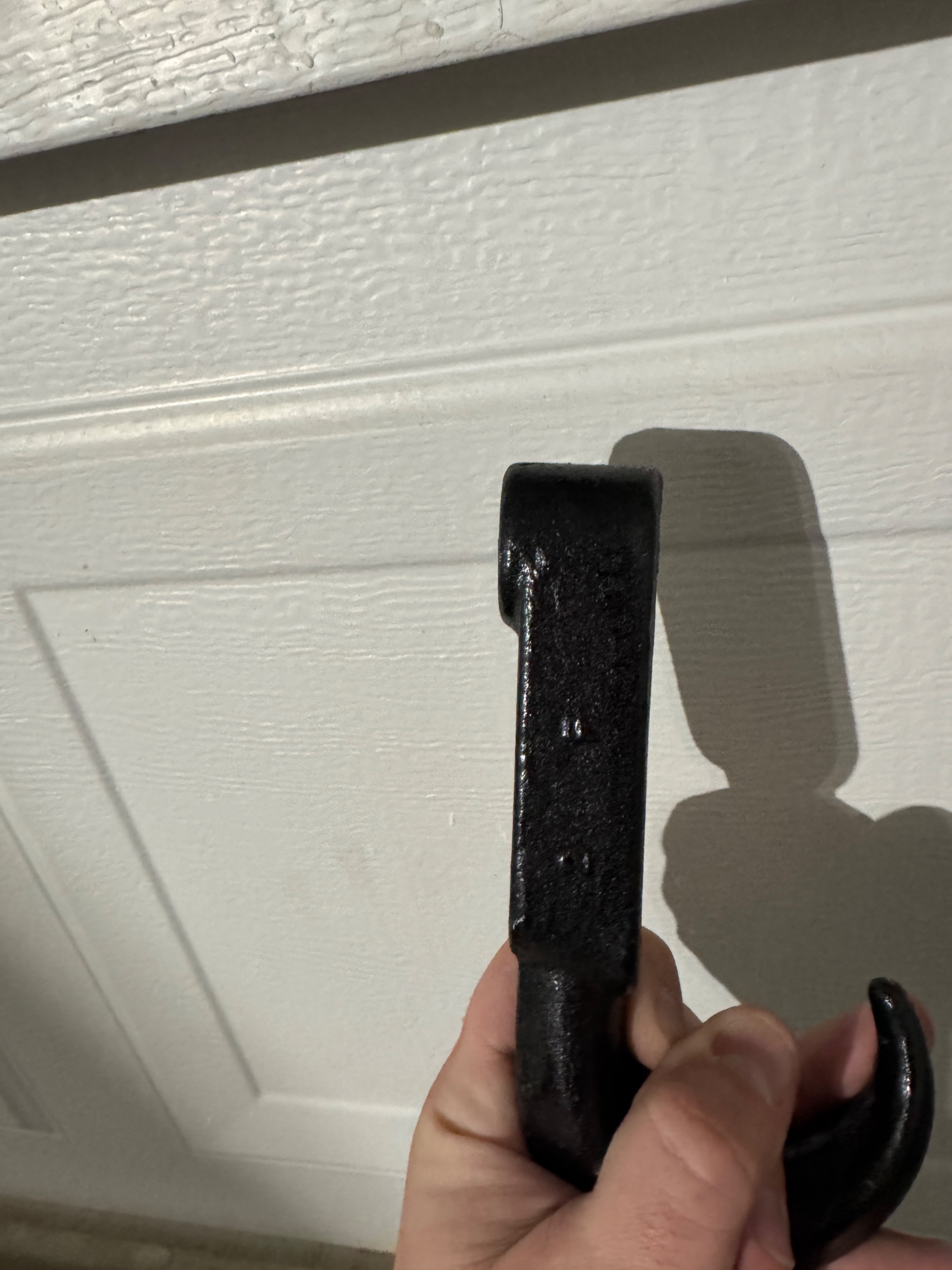

The two hooks use two bolt holes per side. One hole is the front hole that the bumper is using, the other hole is in the frame under the Jeep cover. Other than clearancing the cover, you just need a set of hooks and a set of bolts. I like these for the bolts:
There are 4 each Long Front Bumper Torx Bolts and 2 each Short Front Bumper Torx Bolts in this 6 piece set. (Torx Bit Size T-55 ). Notice this style of OEM torx screw has tapered threads on the end of the screw.
www.ebay.com
Hooks you can find on eBay. I’d recommend stock hooks if you have a stock bumper, because the stock hooks have a step in them so they can straddle the raised portion of
the bumper and the lower portion of
the frame.
