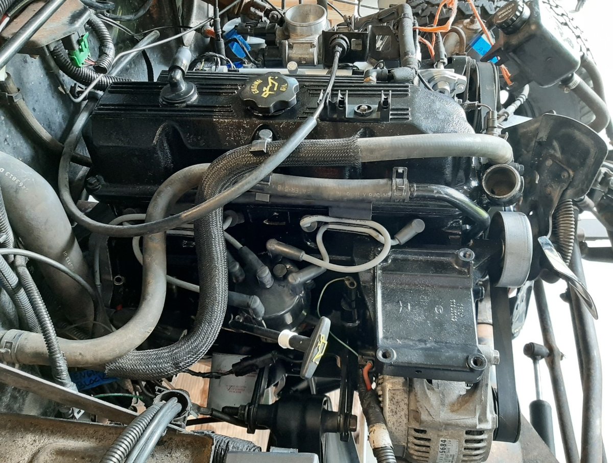

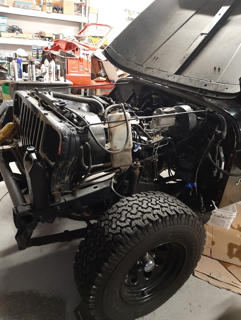

This week I was able to install the engine and transmission, skid pan, new U-joints, and hook up all the wiring, vacuum and fuel lines. Added the fluids and primed the engine oil pump.
Getting closer each day.

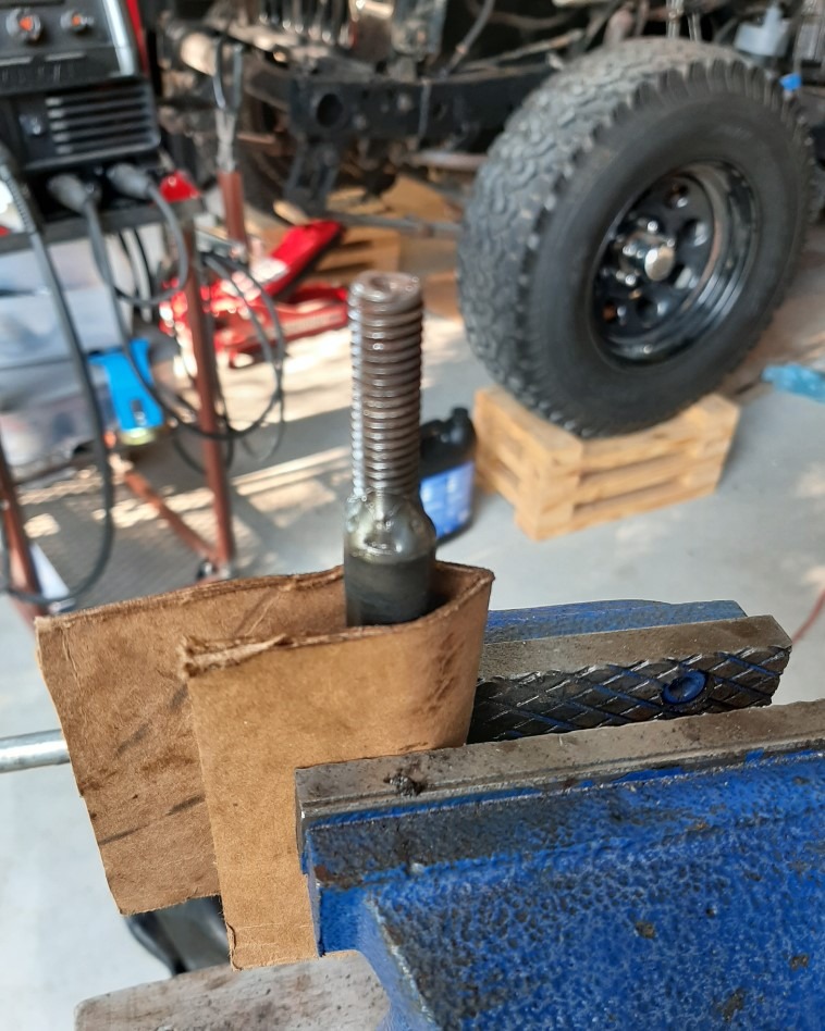

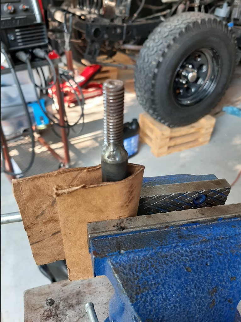

Welded the threaded stud back on the top of the shift lever that I broke off trying to remove the knob a while back. Finally got the stub and lock nut separated from the knob.
Haha... damn, the previous owner shifted so hard he broke the threaded portion of the rod off :LOL:
Yeah that's funny. I figured the AX5 would have come apart first. He sauid he was trying to remove the shift knob and it snapped off. The locking nut and broken stud were still in the knob and was very tight. It needed a few days of soaking and a little heat to work it loose.
Reactions: Chris
Given the fragile nature of the AX-5, I would have to agree that I would have thought the same thing.
If that story is true, that shift knob really must have been on there. Either that or the guy had a hell of a grip!
