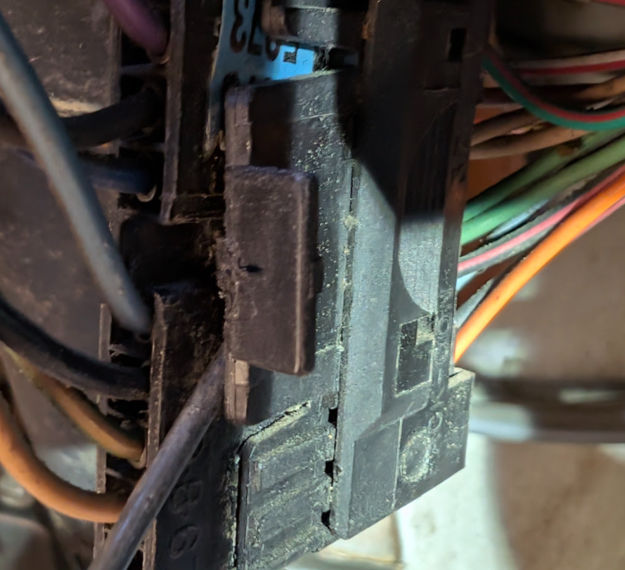

Hi All
Any tips on how to separate this 95JY multifunction switch plug from this socket which is located under the steering column. Its the first time Im doing this and Im not sure how this comes apart and I don't want to force anything . Its very cold outside so the plastic seems brittle. Does that tab "pull/slide up" releasing the plug or do I pry the tab away from the plug and and press the tab down down?

Thanks for your feedback Macho. I'm old so its hard for me to see this plug and socket correctly. Is the tab part of the female socket or part of the male plug. Assuming I have the correct replacement part, the tab looks like part of the female socket.
If the Tab is part of the socket, does the tab move/slide independently from the body of the female socket or is it one piece, I.e molded into the socket body. If it slides independently, I would guess that I should pull up on the tab meaning to the left in the picture towards the switch side wiring. If it is attached to the female socket body and does not "slide" I would guess that I would move the tab towards the right side of diagram as I am attempting to do with the screwdriver, shown inserted under the tab.

The tab should be part of the female connector, you lift it up then pull leftward in the photo to remove the male. The tab is molded in, so don't bend it too far and break it.
Correct, your assumption about it being molded/attached is correct and that is how to separate the two. It may require a decent tug, these old connectors like to get stuck in place over the years.

Woo Hoo 🥳 Multi-function plug and socket are separated. The 4 key steps to success 1) make sure to know how the plug locks into the socket. In this case its a simple tab lock on the socket side securing the plug. 2) was heating up the under dash area with an electric heater to warm the connector so its not so stiff because of the temperature and 3) using a wood chisel with a wider tip width than a screw driver, and 4) hold breath, pray and pull. 😉 Next step is to clean the contacts on the socket side and plug the new switch in and see what happens.. probably tomorrow.
I had to replace the turn signal switch because of a broken cancellation spring but my brake lights are also not working and the brake light circuit runs thru this switch. If the brake lights work with this new switch I am done, otherwise I may have a defective brake switch itself. Thanks Macho for your help with this.
