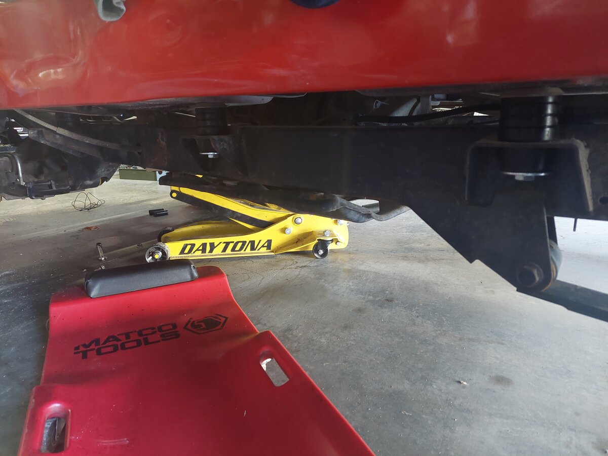

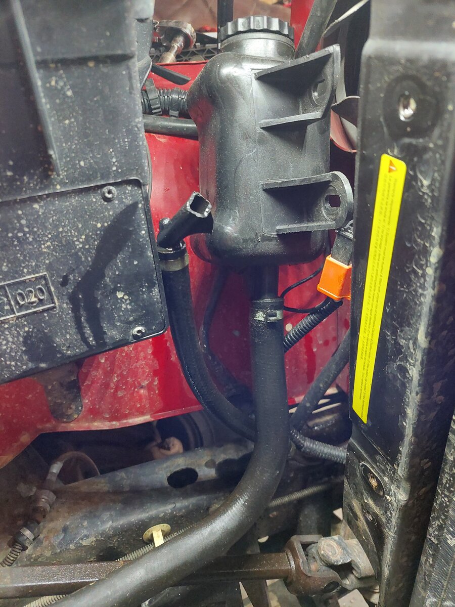

I was installing a Daystar 1" body lift after work yesterday.
...I ripped the bottom out of the PS reservoir :mad:
Can't find one locally, so I ordered from Michigan off FleBay, should be here wed or thurs, I hope.

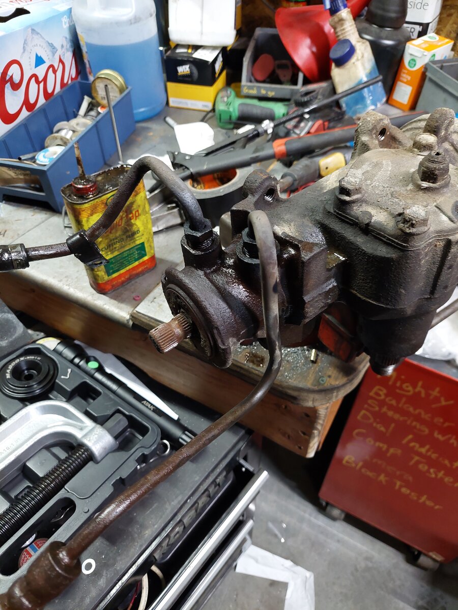

Thought this would be a good opportunity to replace my leaky steering box.
The return hose is absolutely seized and needs replaced.
Can't find one locally, looking on the interwebs with minimal results. might have to build one. still haven't given up looking.

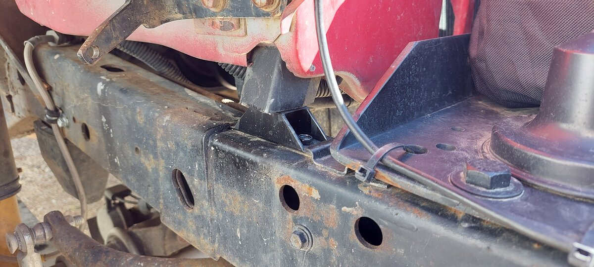

I still haven't figured out how to replace the bumpers that go from each side of the core support to the frame, Thinking about building 1" spacers.

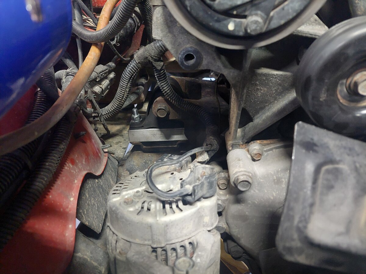

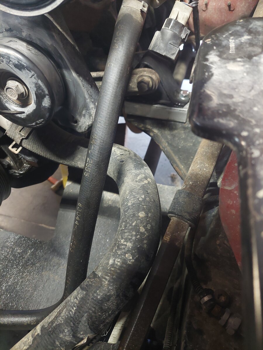

Realized I need to remove the alternator to install the 1" motor mount lift blocks. remove shroud, etc
I slightly wrinkled my driver side rocker panel while lifting the body ...time for some sliders, I guess.
All this because I wanted to get rid of the transfer case drop.
Hope it's together by next weekend. I'd sure love to go to The Cabin Fever run on Silver mountain.
Damn thing was running fine, I should have left it alone.
It went pretty well, I suppose. No more major issues. The body lift is in, the mm lift is in. The driveline angles are pretty good. I also took this opportunity to swap out the leaky steering box with a reman'd unit. As soon as my new ps reservoir and hoses gets here, I can button it up and hit the trails.

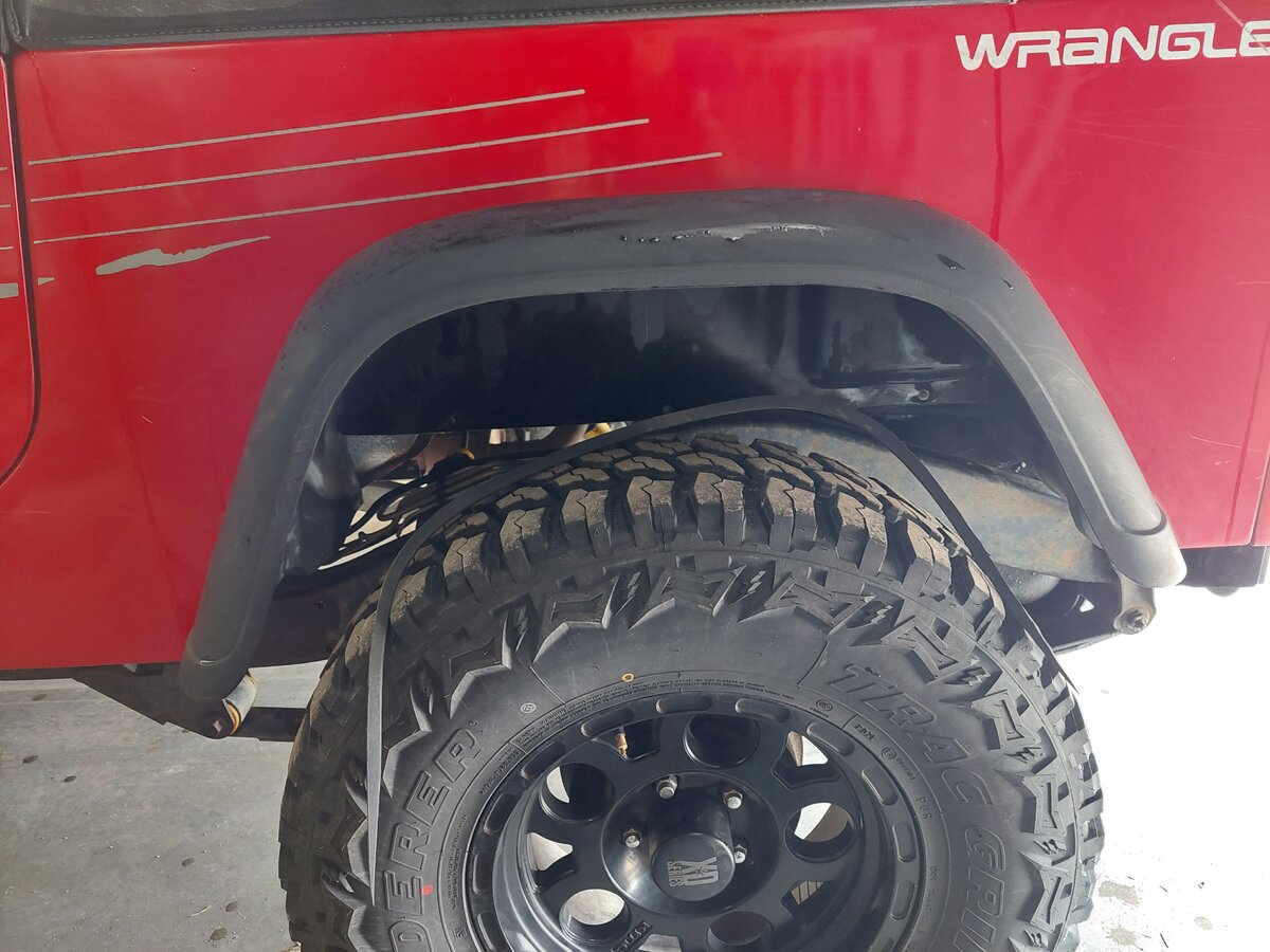

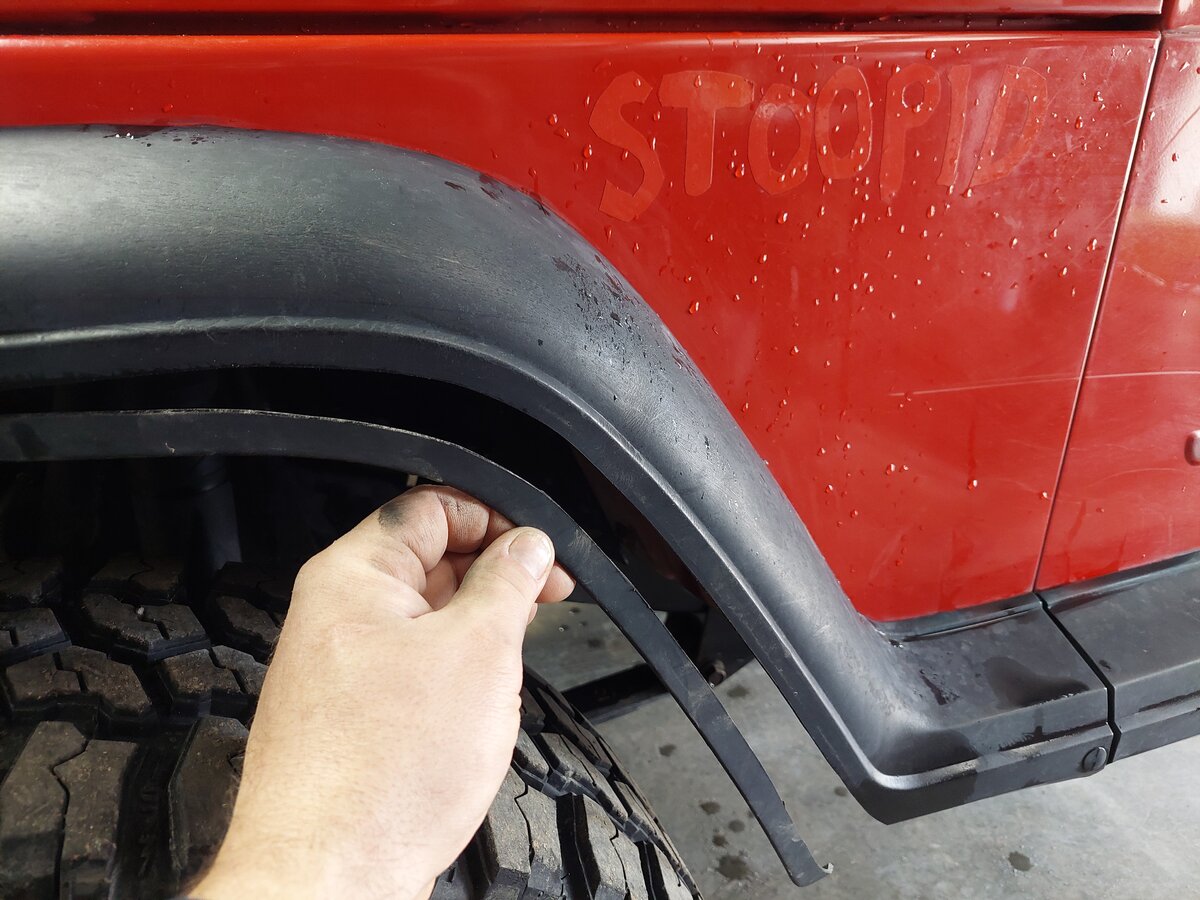

My tires rub quite a bit. The body lift solves this problem (I hope) and gets the rocker panels up an inch reducing the chance of major damage. I figured since I'm in there, why not install a motor mount lift too?
The motor mount lift gave it a better driveline angle, also got the oil pan tucked up another inch (that can't be a bad thing).

The tires still rub a little bit, but only when I'm being extra stoopid.👍

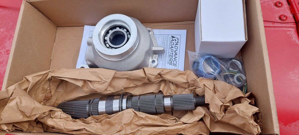

Not sure what's wrong with me, but I just ordered an Advanced Adapters SYE. (An hour ago)
...deeper down the rabbit hole 🙄

I never did bother to install the taller core support bushings for the body lift. I didn't like trying to pull the body sideways enough to access the fasteners, it felt like something might break. I made these 1" spacers instead. A little hokey perhaps, but it seems to be working just fine.

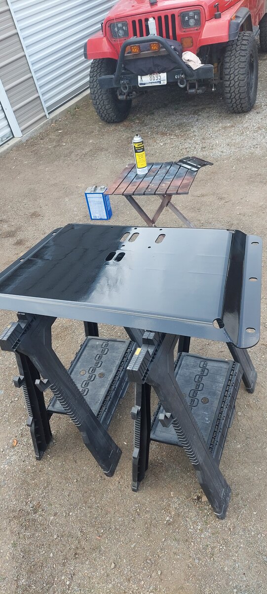

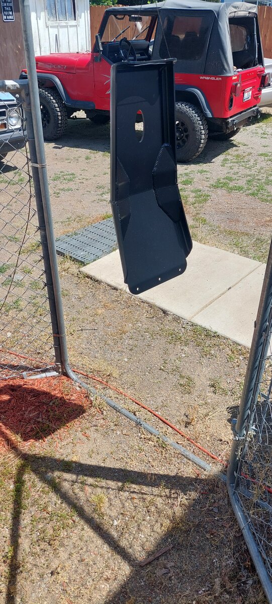

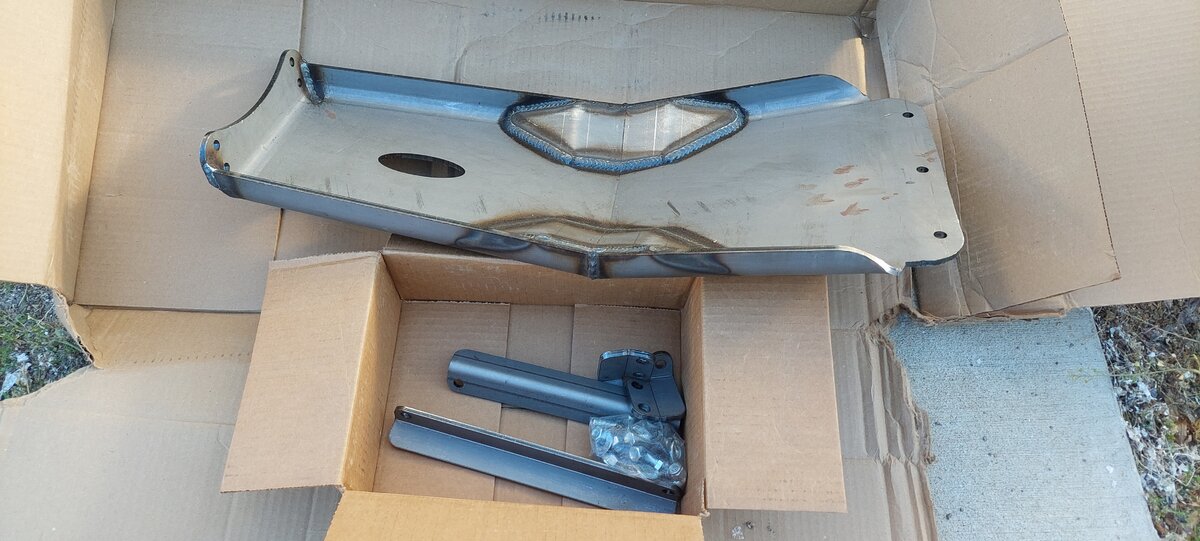

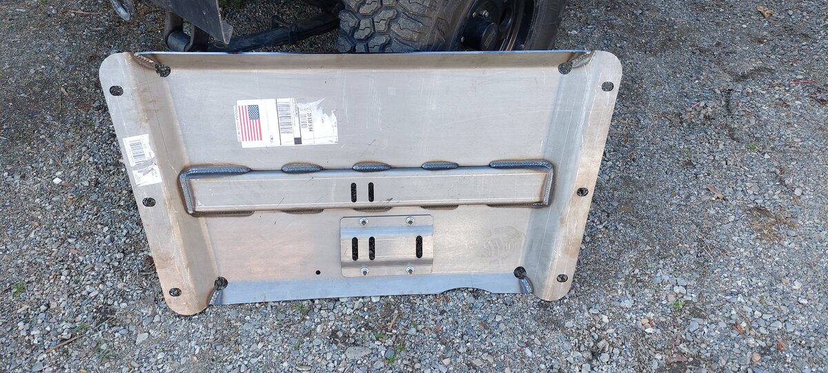

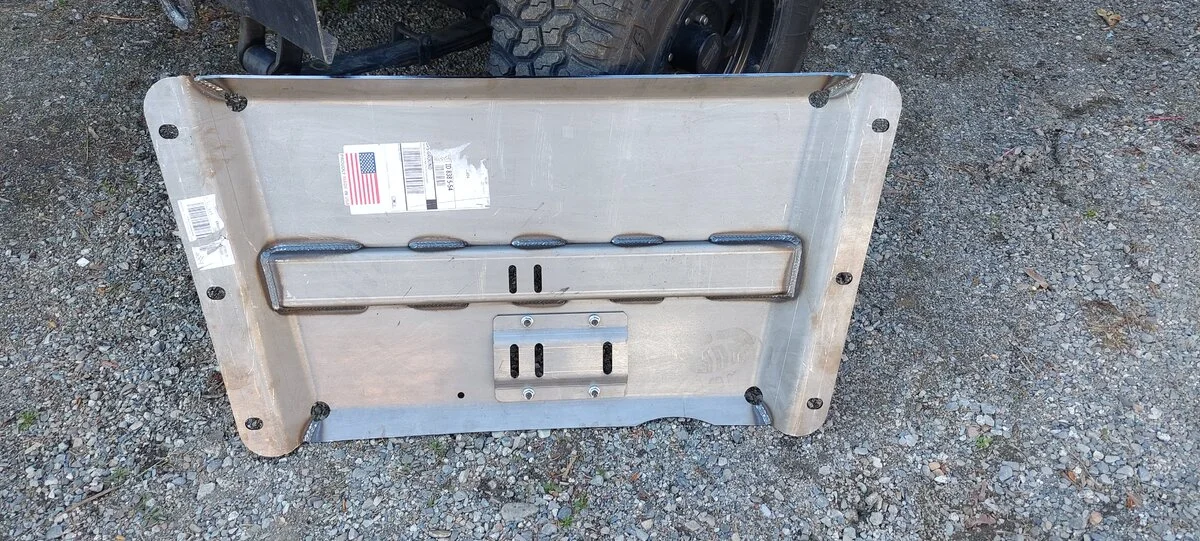

I found a brand new UCF extra clearance skid plate on the front porch today after work 😃
I didn't want it to rust, so I gave it an acetone bath followed some primer and paint.
Now the work begins.
Moving right along.

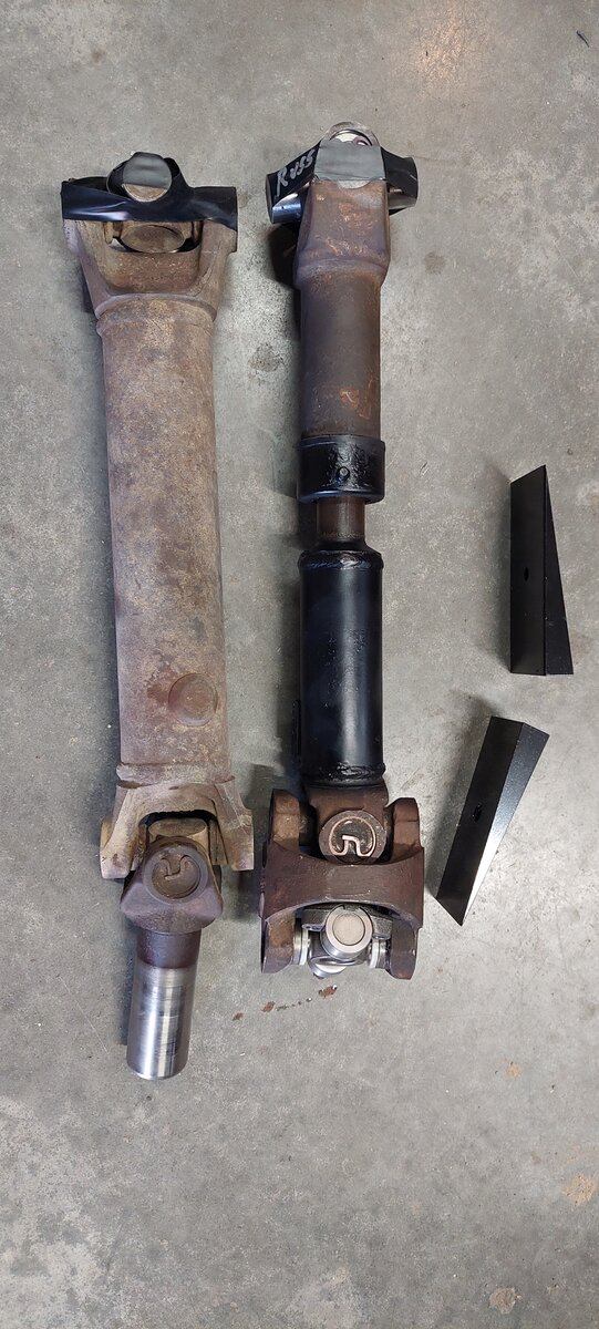

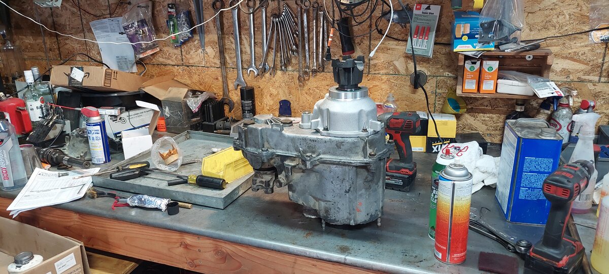

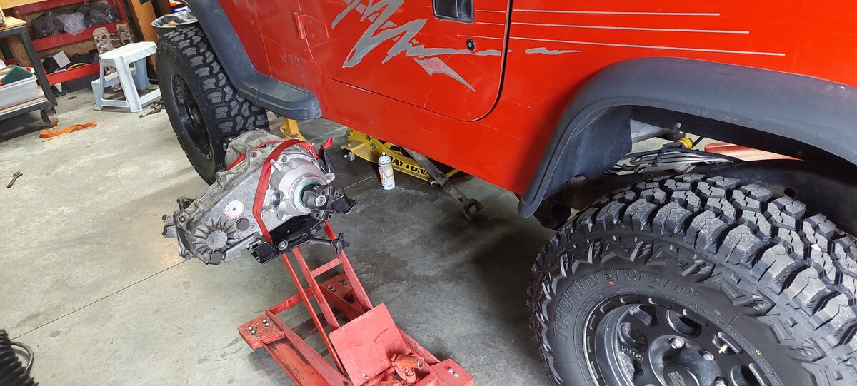

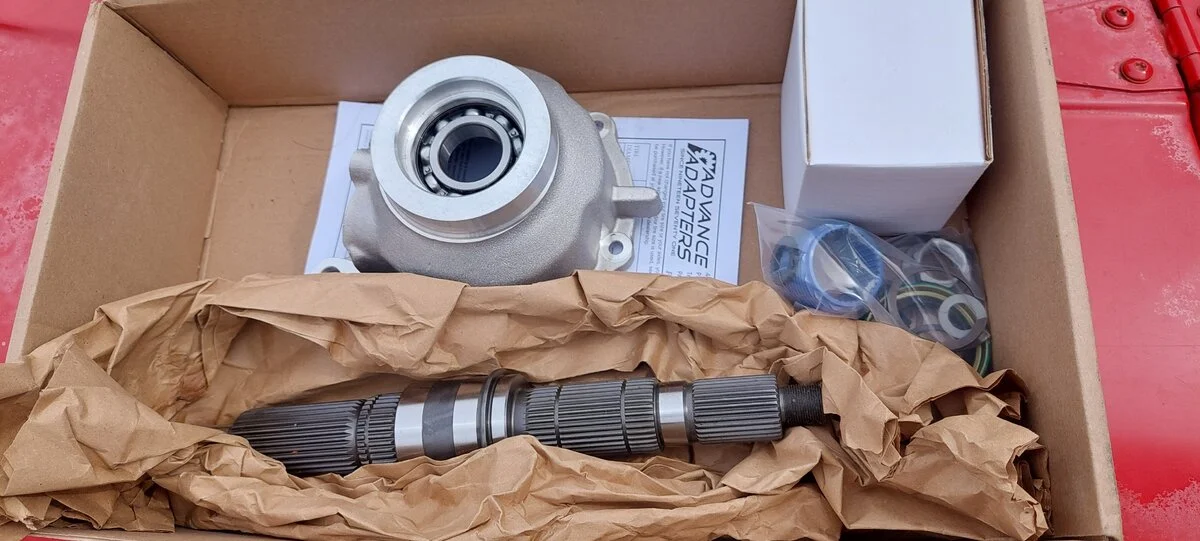

Today, I got the SYE installed and got the gear box reinstalled in the Jeep.
I'll order the 8° shims and new drive shaft tomorrow.
With the new skid plate installed it ended up having 14 1/2" of clearance at it's belly. The UCF skid plate is way smoother than the factory skid plate too.

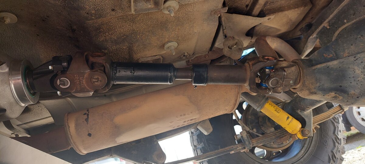

Eric @ Drive lines Inc. Had a nice surprise for me today. He cut down and rebuilt a driveshaft out of a K5 Blazer. Double Cardan, custom length, Spicer U-Joints. Sixty bucks😃
**edit**
One new spicer u-joint, one old spicer u-joint and one new Neapco U-joint. Still though, Sixty bucks for a custom driveshaft 🤘 !!
The local 4WP had 8° shims in stock. Driveline angle is perfect. ZERO vibrations at any speed. Gonna try to hit a trail this weekend and put some scuffs on that Purdy new skid plate.

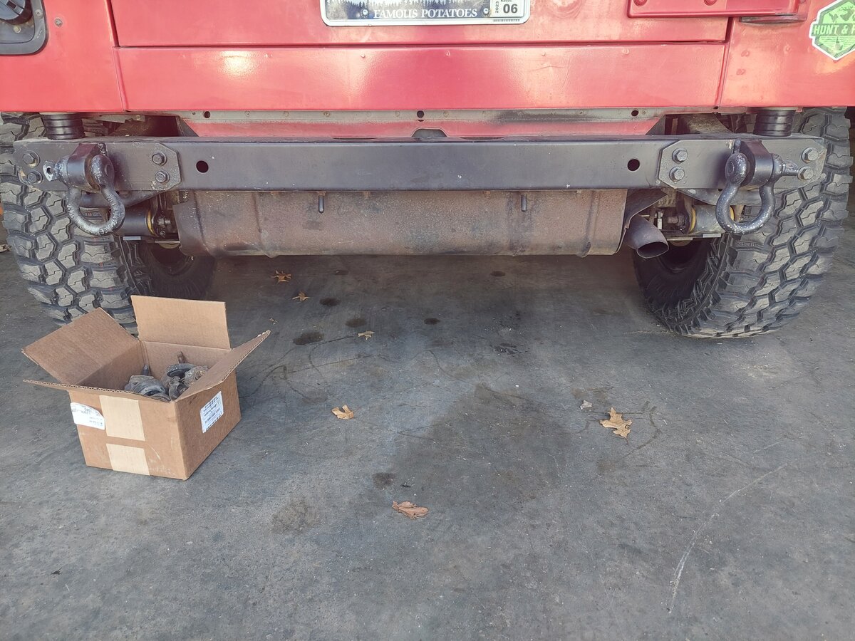

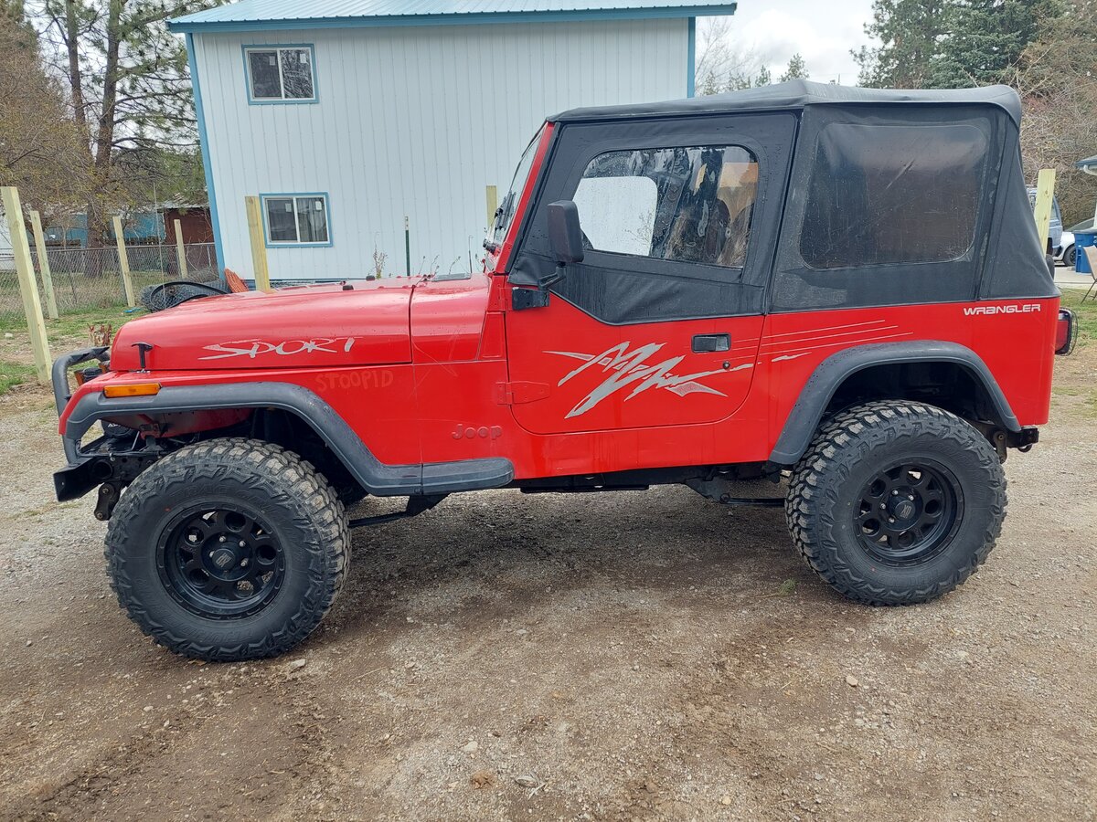

Well, I think this little project is about done.

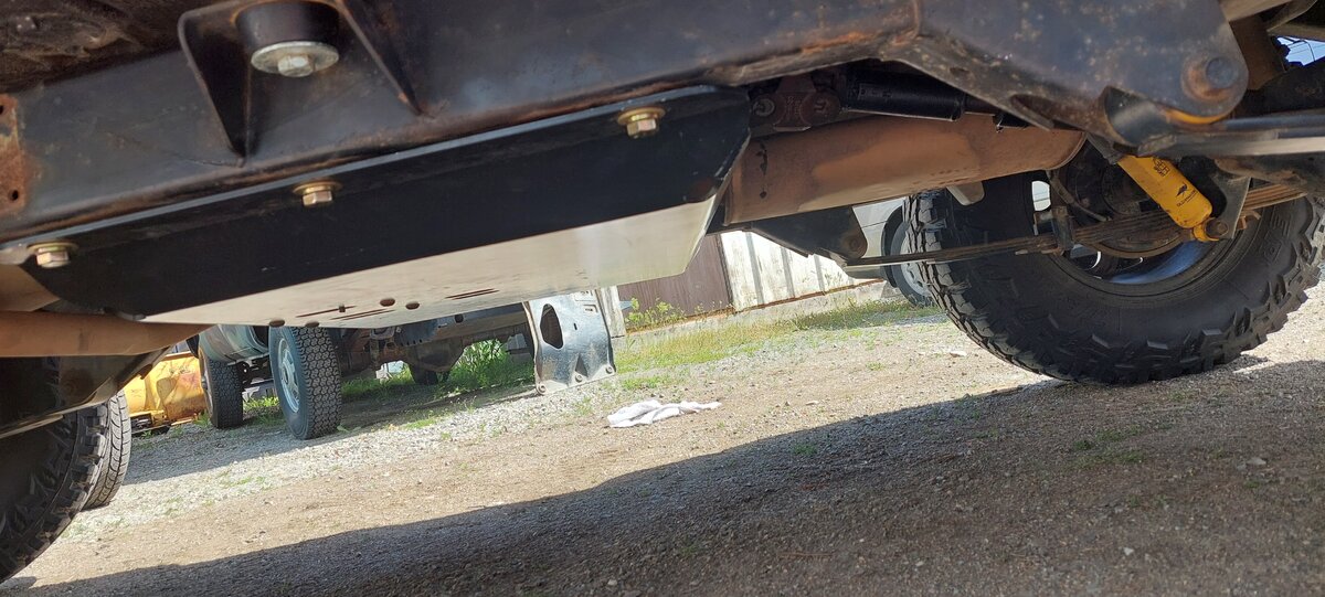

UCF does sell a 1" tuck gas tank skid plate, but I'm not sure I need to spend $406 bucks for it. I haven't had issues hanging up on the factory unit as of yet.
Here's a couple shots of the finished product. Overall I'm pretty satisfied with the results.
...I might add the UFC engine skid plate in the future. Probably not a bad idea.
