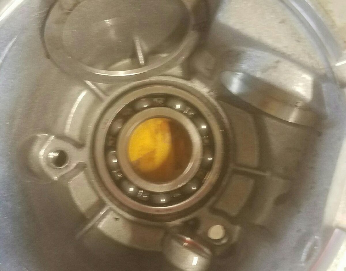

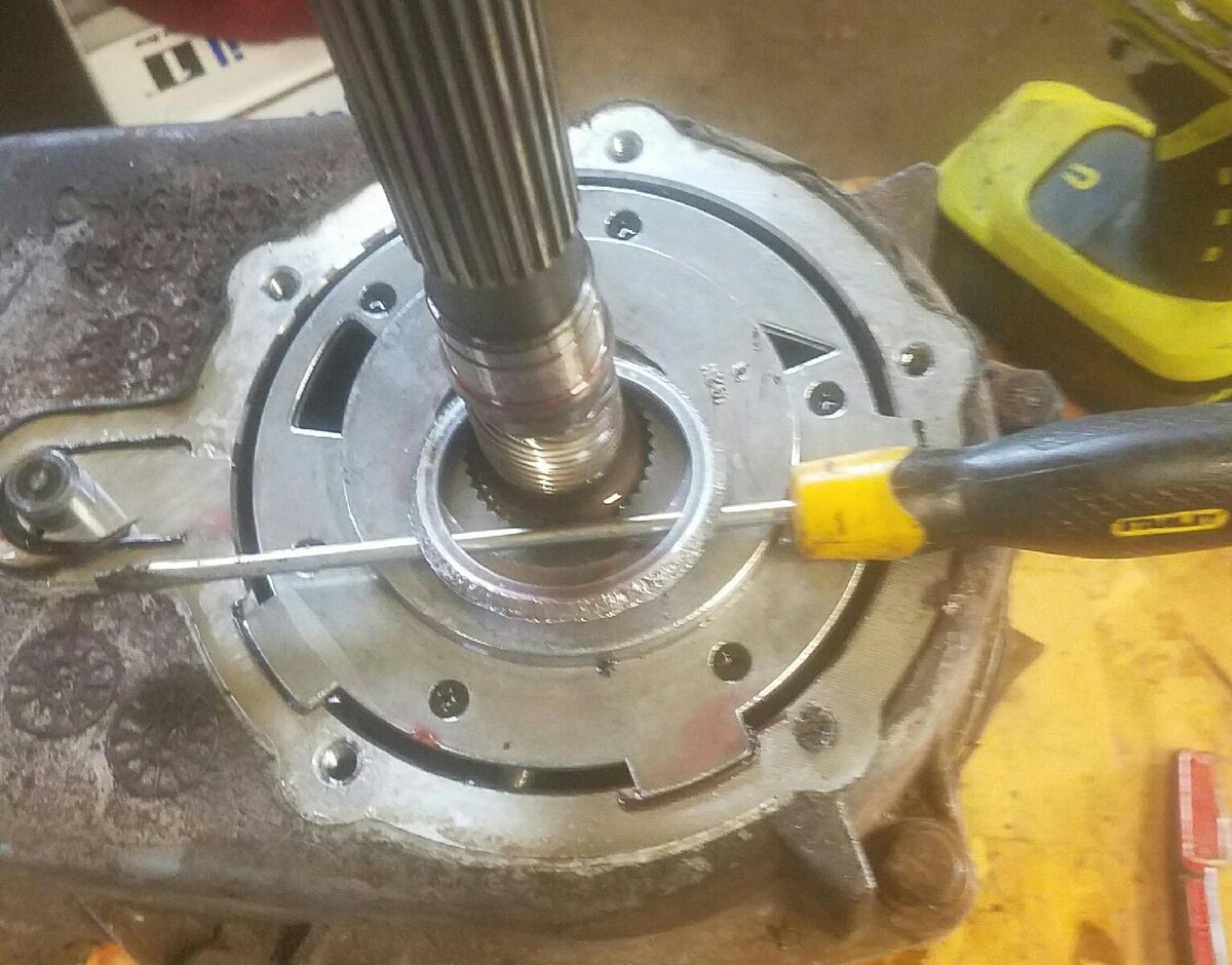

Well I didn't have to go too deep. Last guy got overzealous installing the bearing in the speedometer housing and broke the flang off on the inside. Looks like I need a new speedometer housing... I went ahead and replaced the chain, filter and cleaned stuff up while I was in there.

I found a used case on ebay for $38 delivered, should be here end of the week. Of course if I knew what it was I wouldn't have gone as deep, but this way I replaced the chain and cleaned up some other stuff. Next weekend it should be back on the road! This is my first Jeep and I really like it. I always wanted one but with my work commute in the past it just wouldn't work out.
Usually when a bearing is replaced, the housing has to be removed in order to remove the old one, would think they'd noticed it.
