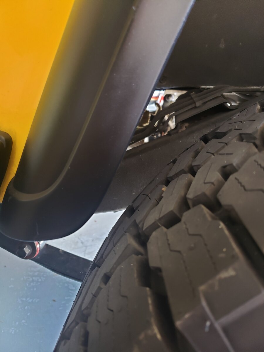

Hey I just put 33's and a 4in lift on my 87 Yj and the factory fenders rub in the back when I go off road. Can I have some recommendations on flares that would be good and have enough space between it and the tires? Thank you

Yes, it looks like your wheels are sticking out past the flares, which is going to cause all sorts of issues.
I would try and fix the backspacing issue as much as possible. However, if you want a more durable flare that isn't going to give you issues, the GenRight tube fenders would be a good choice:
They aren't cheap, but they're durable as hell. With them you'd open up a lot of room for the tire.
Of course all of this is a moot point unless you have your bump stops set correctly so that you hit the bump stops before the tires smash into your fenders.
