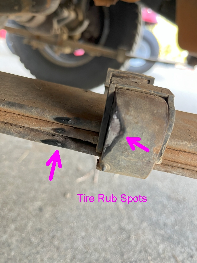

Next was the discovery that 225 tires are hard to find, have poor selection, and are expensive. So I did a switch to a slightly larger 235 tire and am happy with them. The problem I found was that when turning to get out of a tight parking spot I heard the tires scraping somewhere on the car! So today I looked into the problem and found that when turning hard both tires are able to rub against the clip holding the front spring leafs straight.

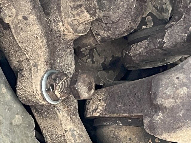

The tire shop said I should look for some offset wheels to replace the 5 Jeep ones. In looking it all over I decided that all I have to do is to back the steering stop bolts out a thread or two until the noise stops. The slight increase in turning radius is negligible. I haven't tested this out yet as I discovered something that looks a bit gooney.

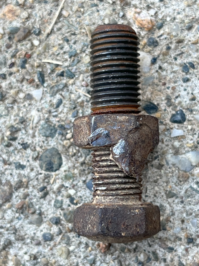

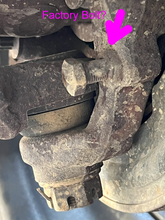

The stop bolt came out easily enough, but the bolt itself looks like a 5 year old welded it up. The bolt is just that, a bolt. It has a stop nut used to keep it from loosing it's setting. The weird thing is that after it went in to place someone thought it a good idea to tack weld it! I thought for sure some d.p.o. (do Jeep owners use the term "dreaded previous owner"?) goobered up the bolt. Checking that theory I looked at the opposite side... same thing! So is this questionable practice a factory quality measure, or a shade tree mechanic aftermarket fix?
Right now I am trying to decide: Fix 1) Add a washer or two under the welded on nut. Or Fix 2) Get a new bolt and nut, Install it and adjust stop position, then tighten lock nut down in place.
What's your vote or alternative?
