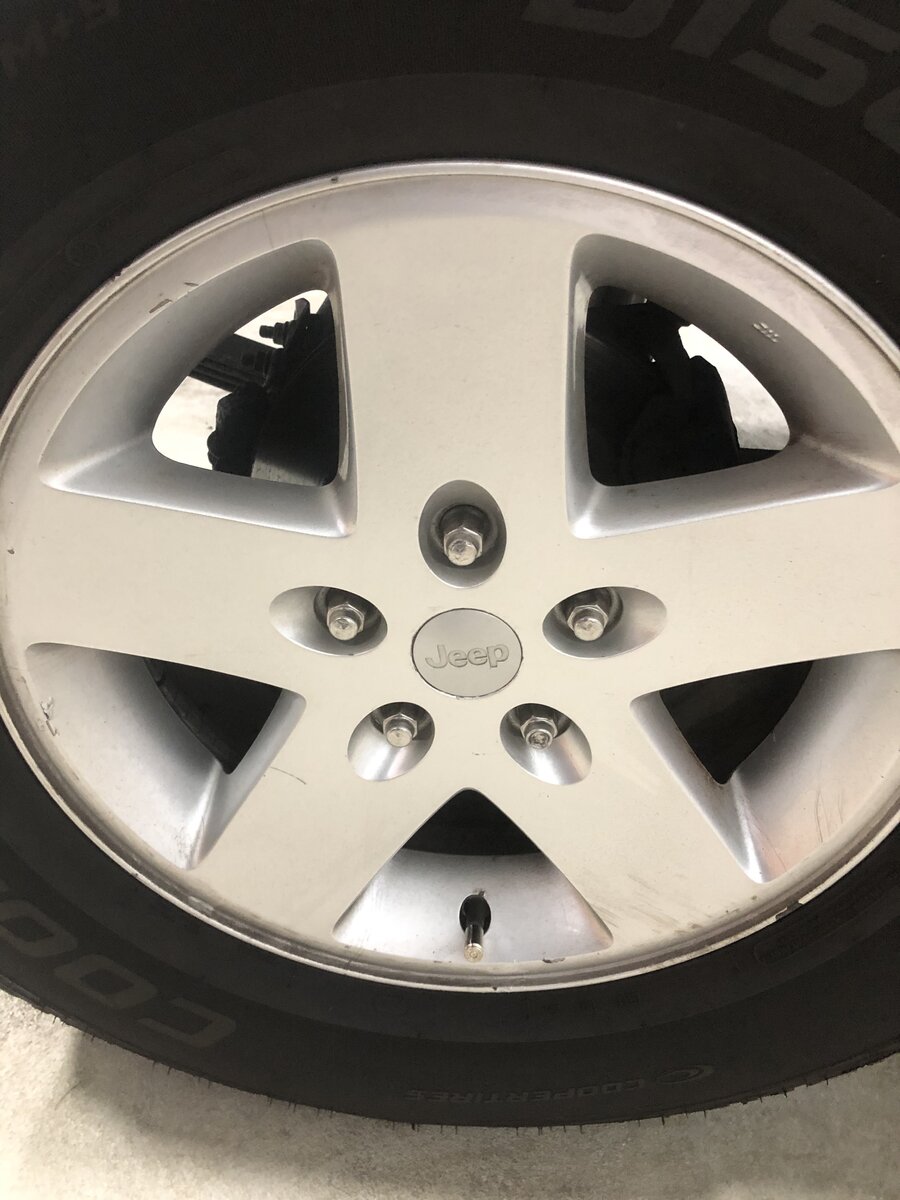

I just bought a 1995 jeep YJ. The rims are not factory to this model. I think they are off a newer jeep. Is it possible someone changed it from a 5 by 4.5 to a 5 by 5?
Definitely looks like JK wheels and probably a 1.25" or 1.5" 5x4.5 to 5x5 adapter to mount them. Nothing wrong with that unless you don't like the looks of that rim.
