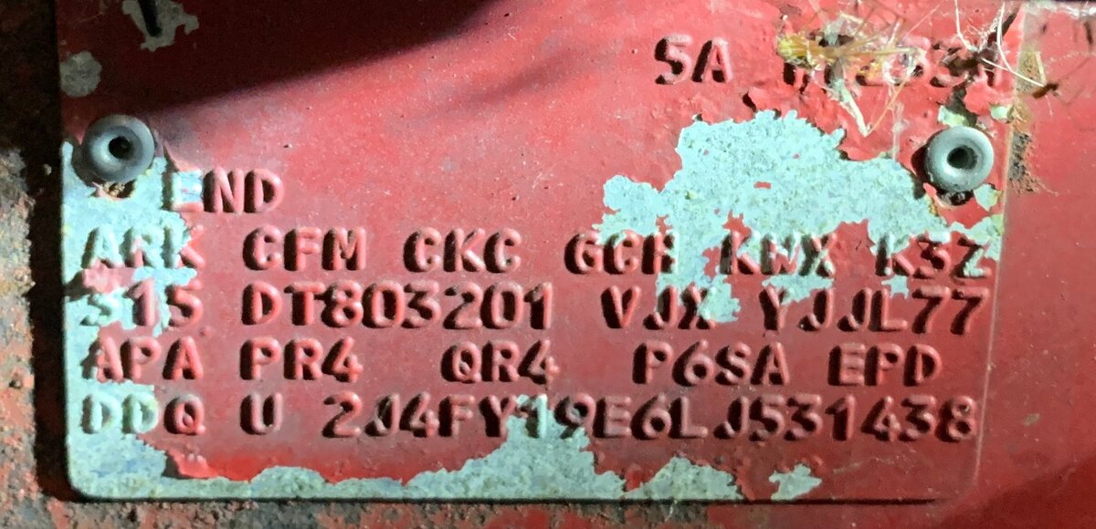

Hi, New user. Just picked up a 1990 YJ as a project the other day and have been doing some research. The VIN decoders I saw out there only listed US (1) as the first digit and mine is a 2 (Brampton Canada after some searching.) Not sure how odd that is.
The main question I have is on the ID Plate on the firewall. That shows a paint code of PR4 which is not a code listed on any of the 'paint code' sites/resources I've seen. The Chrysler build sheet site does kick out a sheet and it shows as Flame Red. Which is PR4 but way after 1990.
So my question is: is a lot of the YJ resources out there incomplete or did Bramption do some things differently ? Secondly is there a good ID Plate decoding site ut there that shows what lines 1 & 2 mean ?
