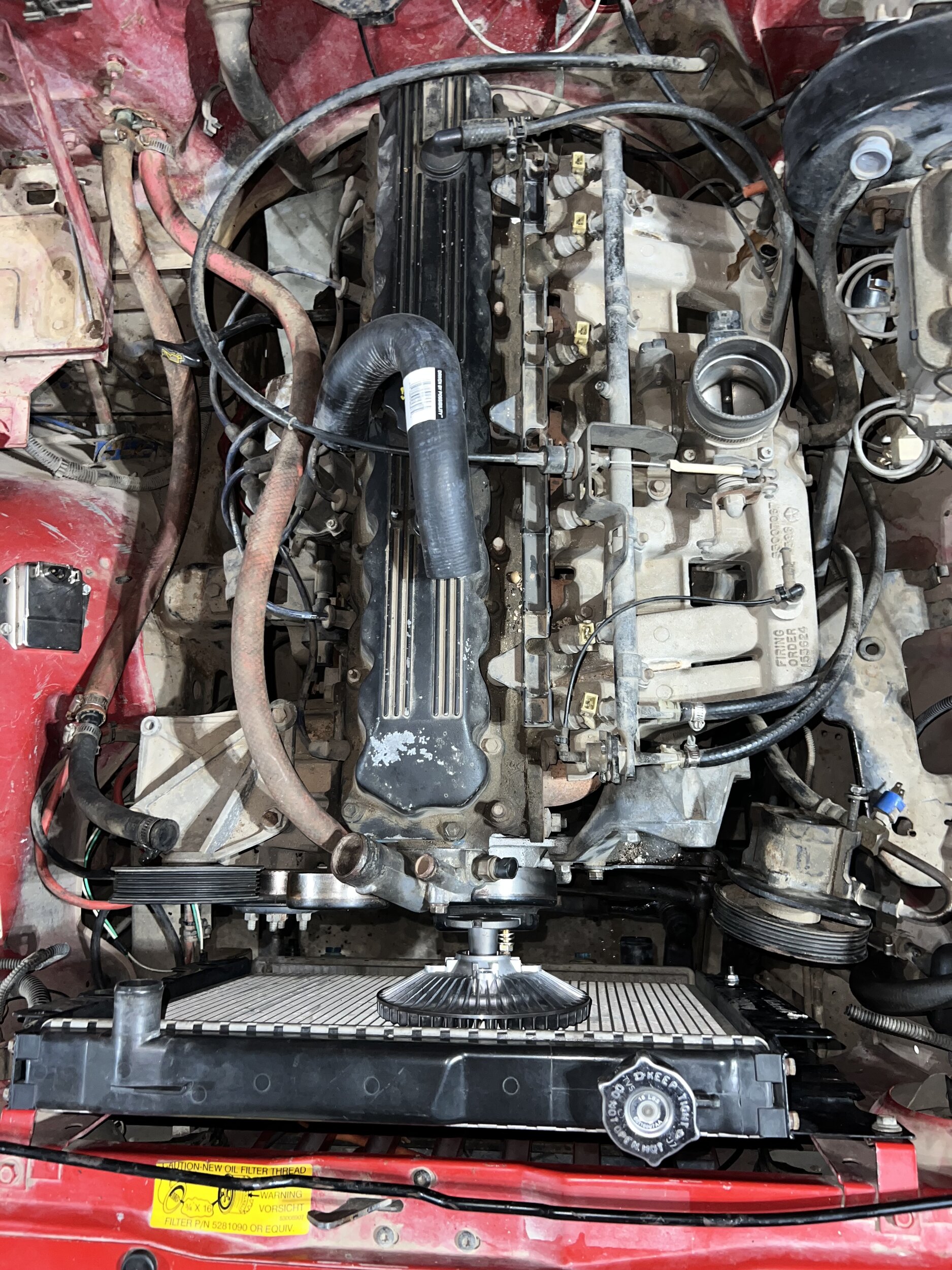

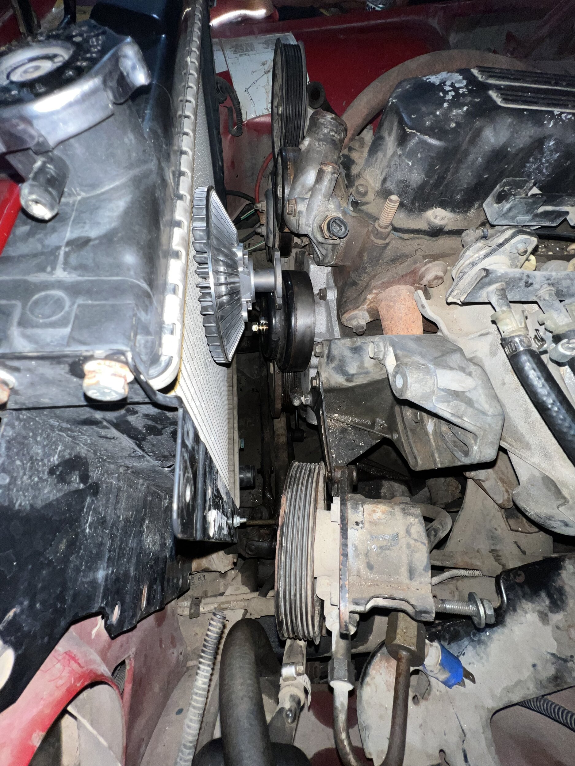

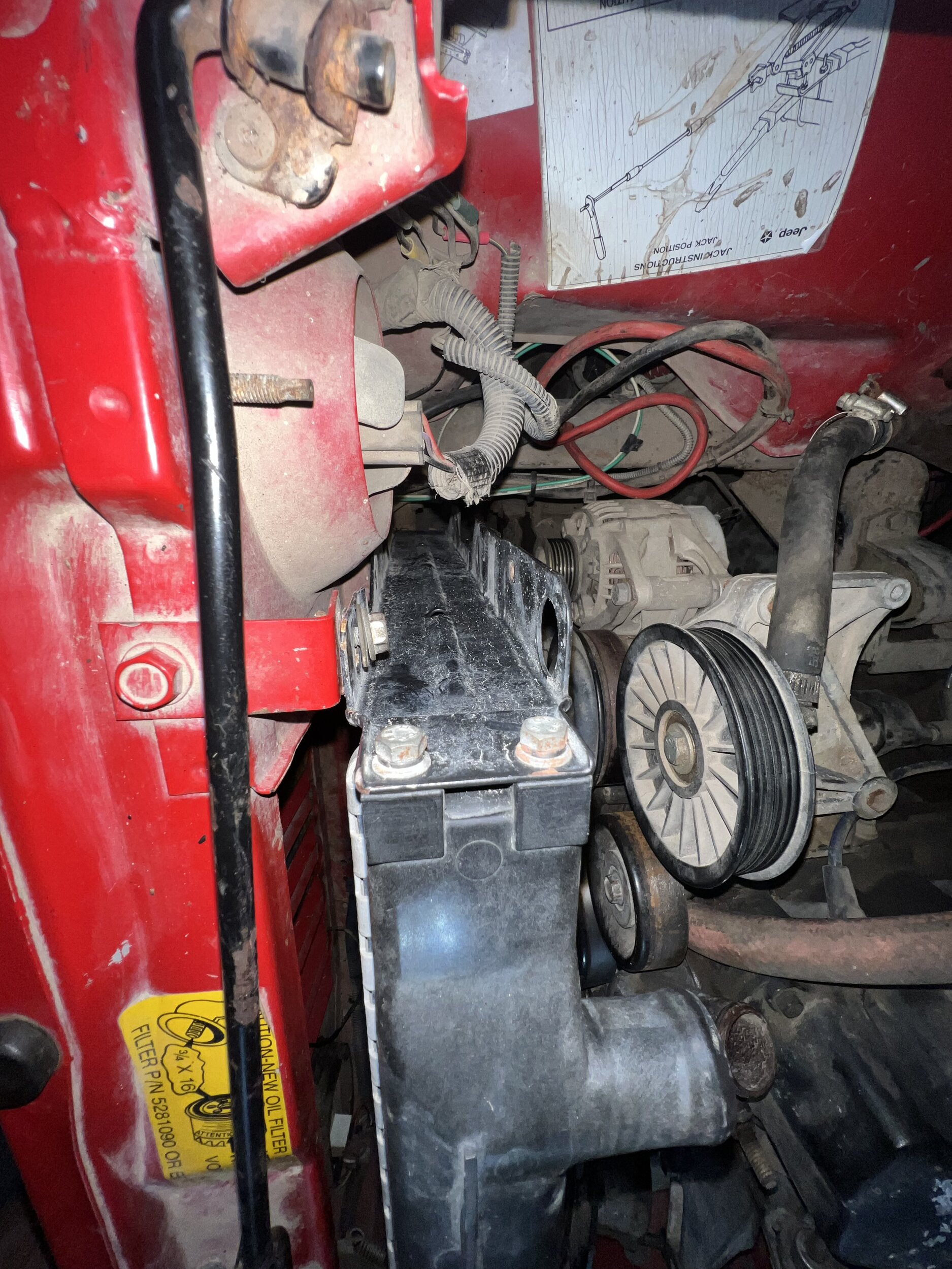

So I have a very strange thing going on, I am hoping someone can possibly point me in the correct direction. I purchased a 94 YJ and found it has a 4.0L i6 blocked dated to 92, previous owner did a swap it appears. The rig had a seized up electric fan on the front of the radiator, I wanted to swap it back to the original motor fan/clutch assembly. I replaced the water pump with a stock water pump, stock pulley (no spacer). I had an OEM fan and clutch assembly ready to install and realized there is not enough clearance to fit the fan/clutch. The face of the clutch hits the radiator. Has anyone ever experienced this? I thought maybe the motor mounts have somehow shifted the motor forward, or do I have an issue or modification on the radiator support that is creating the lack of clearance. Can anyone send the measurement between the face of the radiator and the water pump pulley face? I greatly appreciate any help that can be offered, this one has me stumped.

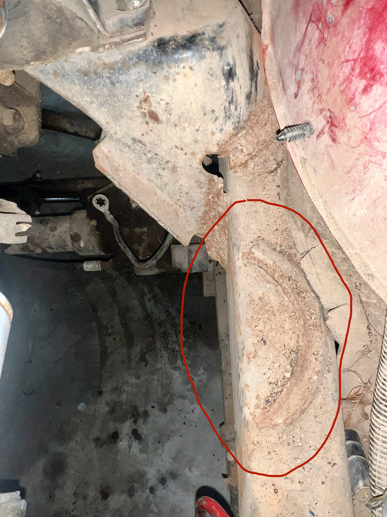

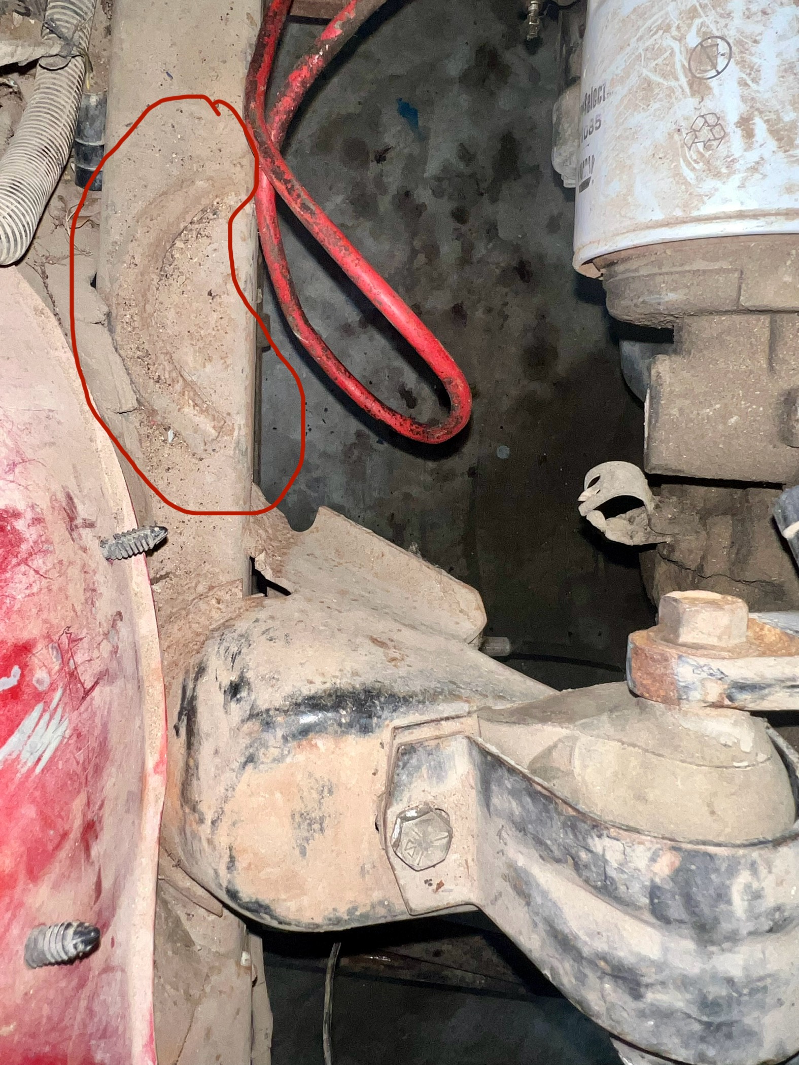

Just feel this weld by the existing motor mount.

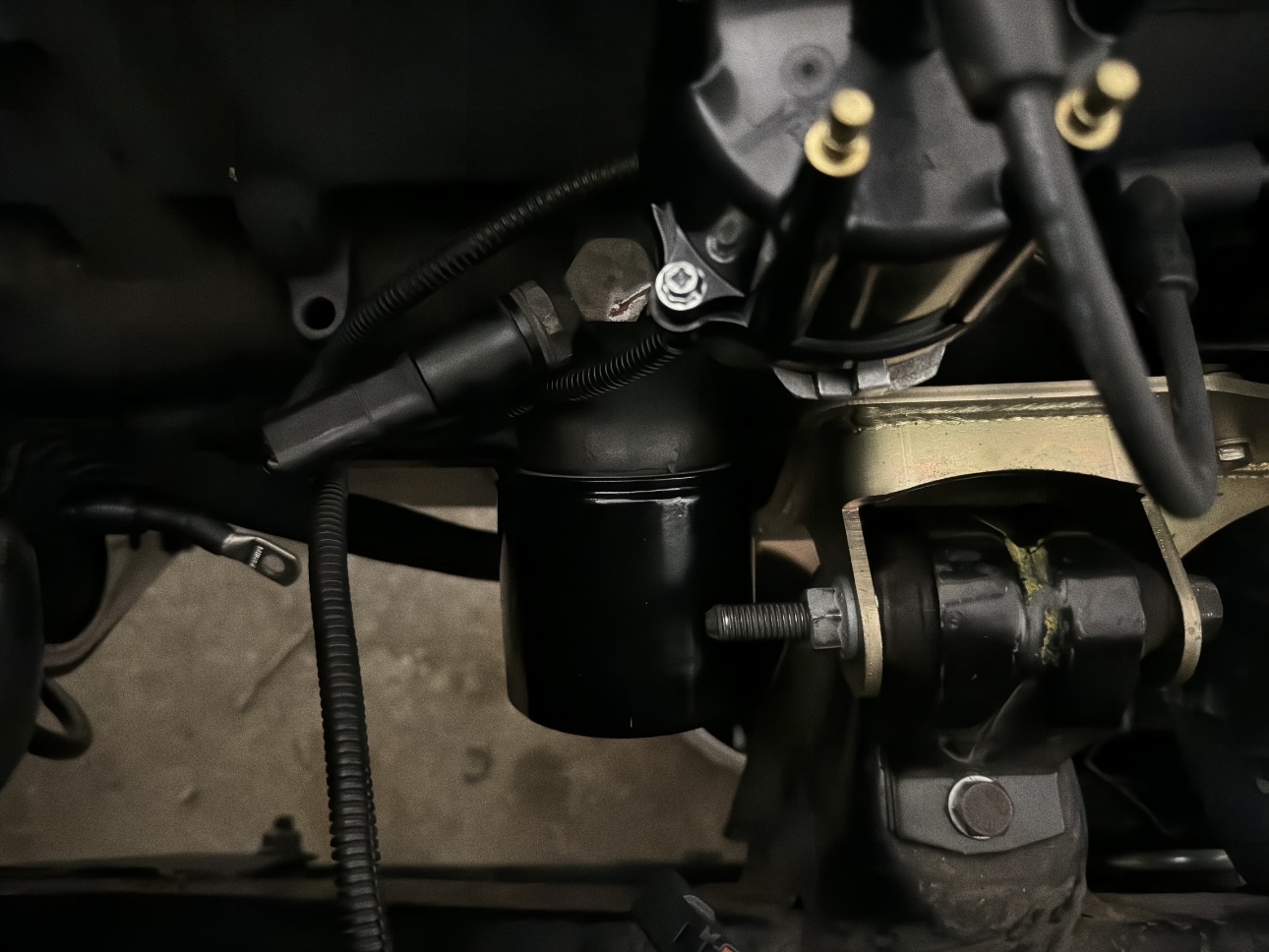

Unfortunately you are dealing with previous owner screwery. For one thing, you have an XJ engine, that is determined by the oil filter pointing rearwards since it is mounted to an oil filter adapter. Only the XJ (and maybe the 91-92 MJ) uses the oil filter adapter on the high output 4.0L (91-95 4.0).
YJ filter positioned below. You can fix this easily by unthreading the oil filter adapter bolt (either 9/16 Allen or T60 torx), and then removing the leftover roll pin from the block. Then after that you can unthread the oil filter hookup on the adapter and thread it into the block. Torque it to 50 ft lbs or so. The oil filter adapter is notorious for leaking, so I’d remove it for sure.

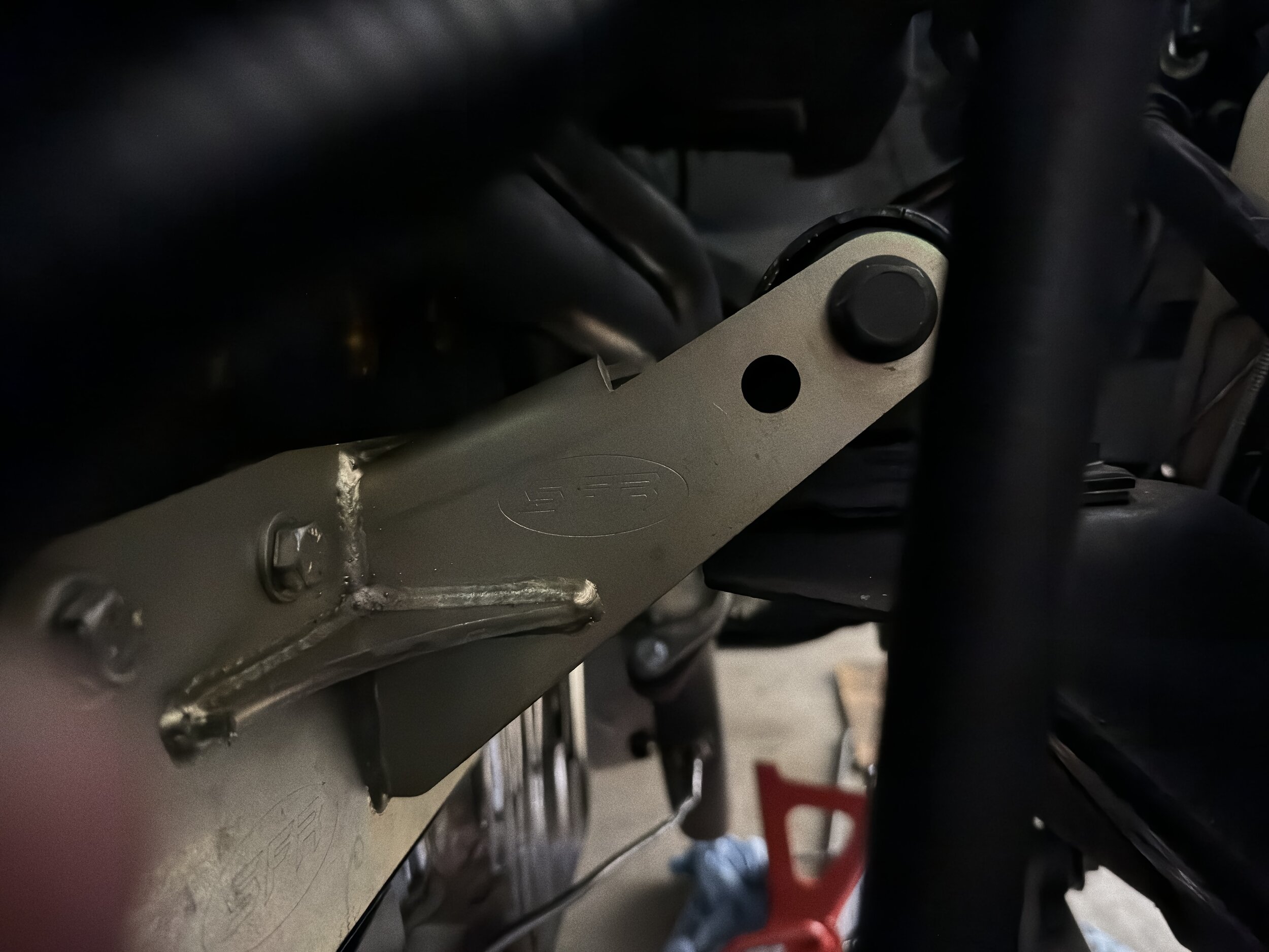

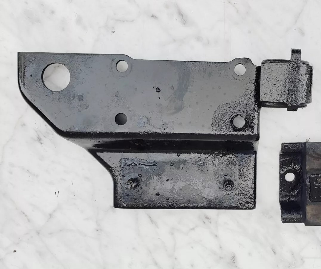

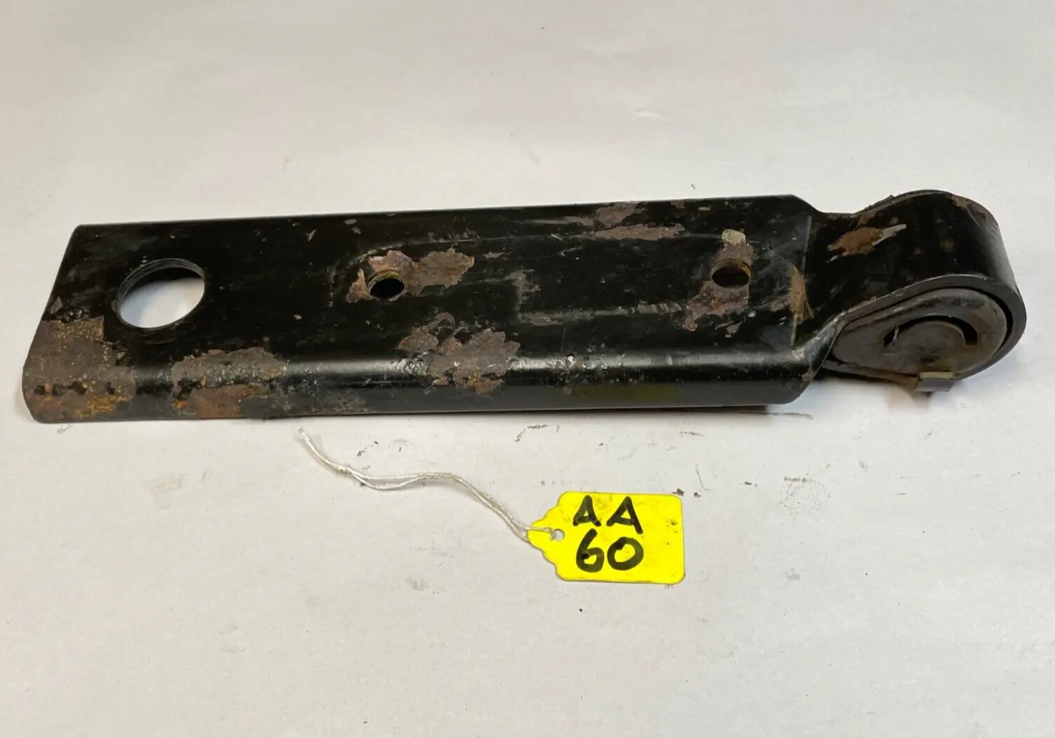

The fact that it is an XJ engine doesn’t mean much else (ultimately the same engine as a YJ) except XJs had different left side engine block brackets. XJs being unibody had less clearance and so the left side bracket had the thru-bolt hole closer to the block. YJ had it further out. You can see this by my aftermarket StinkyFab block bracket which has two holes drilled, one for XJ and one for YJ. I am using the YJ hole, obviously.
Now, why your motor mount is so far forward is not so clear. My guess is they couldn’t reach the frame with the XJ left side bracket and so they moved it further and further forward until they could fab up something and then welded new stuff on. Or, maybe it was a 4 cylinder before and they just did a terrible job of adapting the 6 cyl. I really don’t know. The proper fix would be a YJ left side bracket (or new aftermarket stronger brackets like stinkyfab or brown dog), and rewelding new perches in the right location on the frame. Clearly, whatever they did led to the engine being too far forward and so they mounted a crappy fan on the front of the radiator to “fix” the now screwed up fan clutch location. Gotta hate POs.
I can’t help you with a measurement from radiator to fan clutch unfortunately, as I have my grille out. Someone else probably can.
Bet you have a longer than stock rear driveshaft too…
Reactions: Superbird17
Wow, just realized also that they didn’t bother to convert the belt drive back to YJ style. XJ has some different alternator, compressor, and fan clutch mounting. That won’t help the fan clearance situation, but I would want to put it back to stock YJ as well. I am curious if this jeep was originally a 4 cylinder or if it was always a 6 cylinder, needed a new motor, and got the laziest motor swap ever.

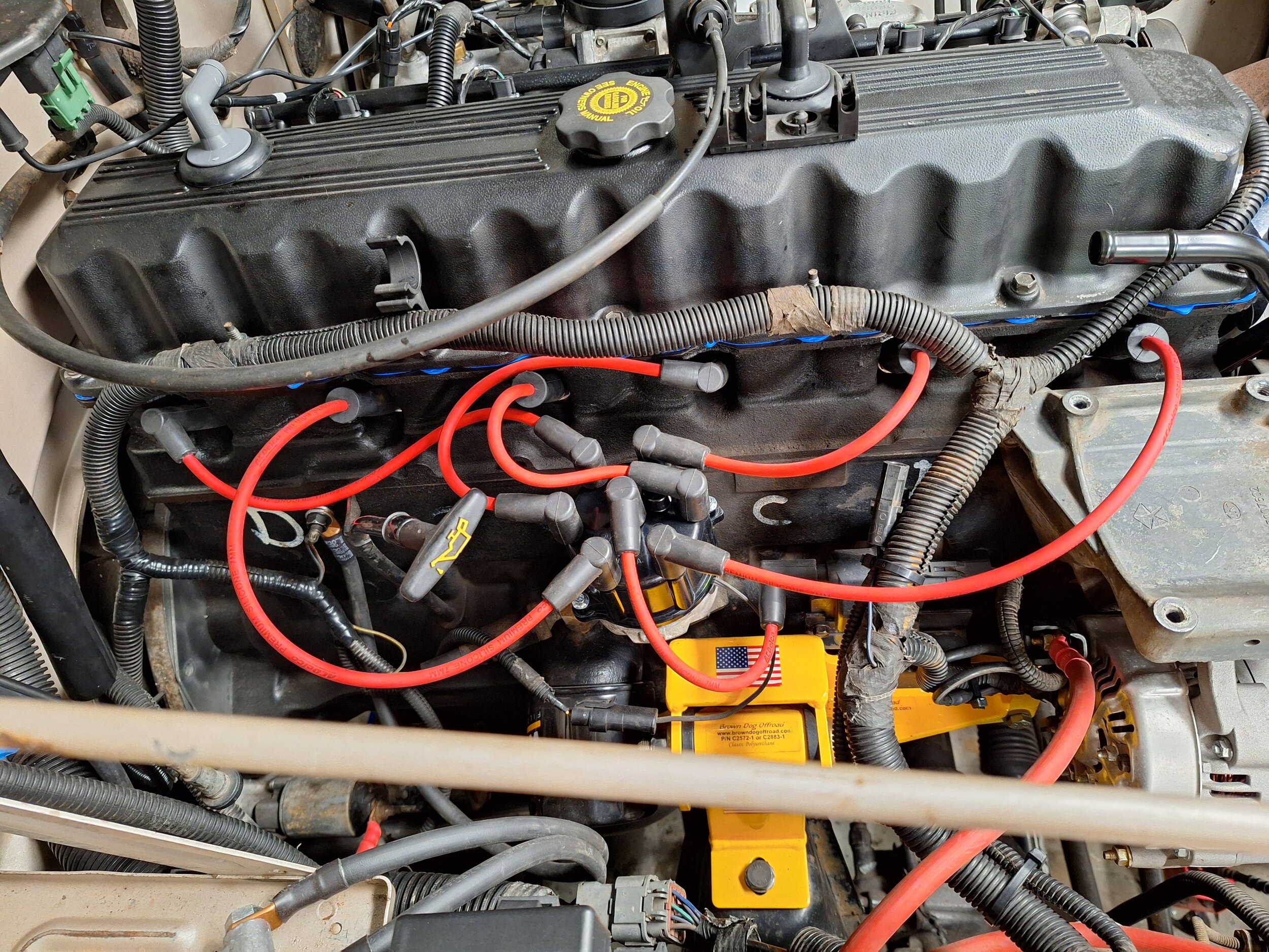

I could see that it must have been a 2.5 before I read that in the post. Besides the welding marks on the frame that shows where the old motor mounts were the clearance between the firewall and the engine/valve cover is further than what you normally see with a 4.0. Typically the valve cover is a lot closer to the firewall and the pic of yours looks strange to me because the gap back there is definitely wider.
You can see how much closer my 4.0 sits to the firewall here

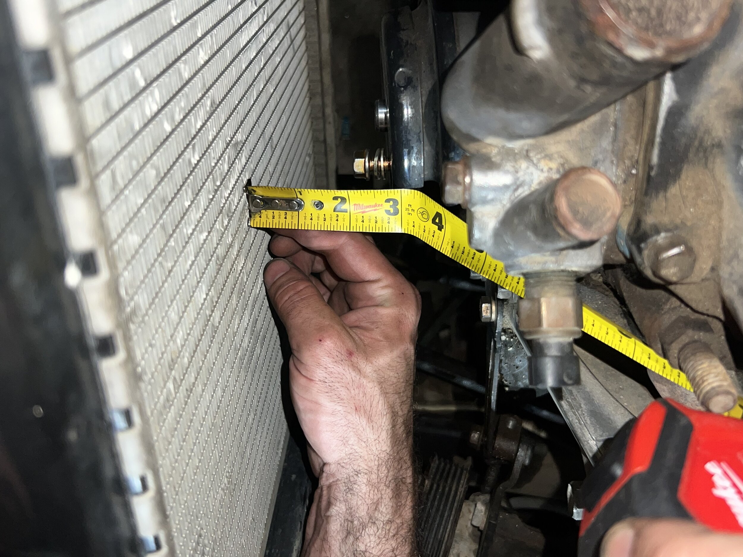

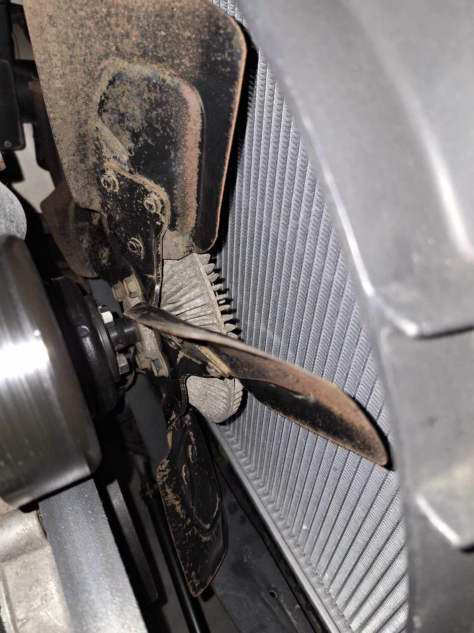

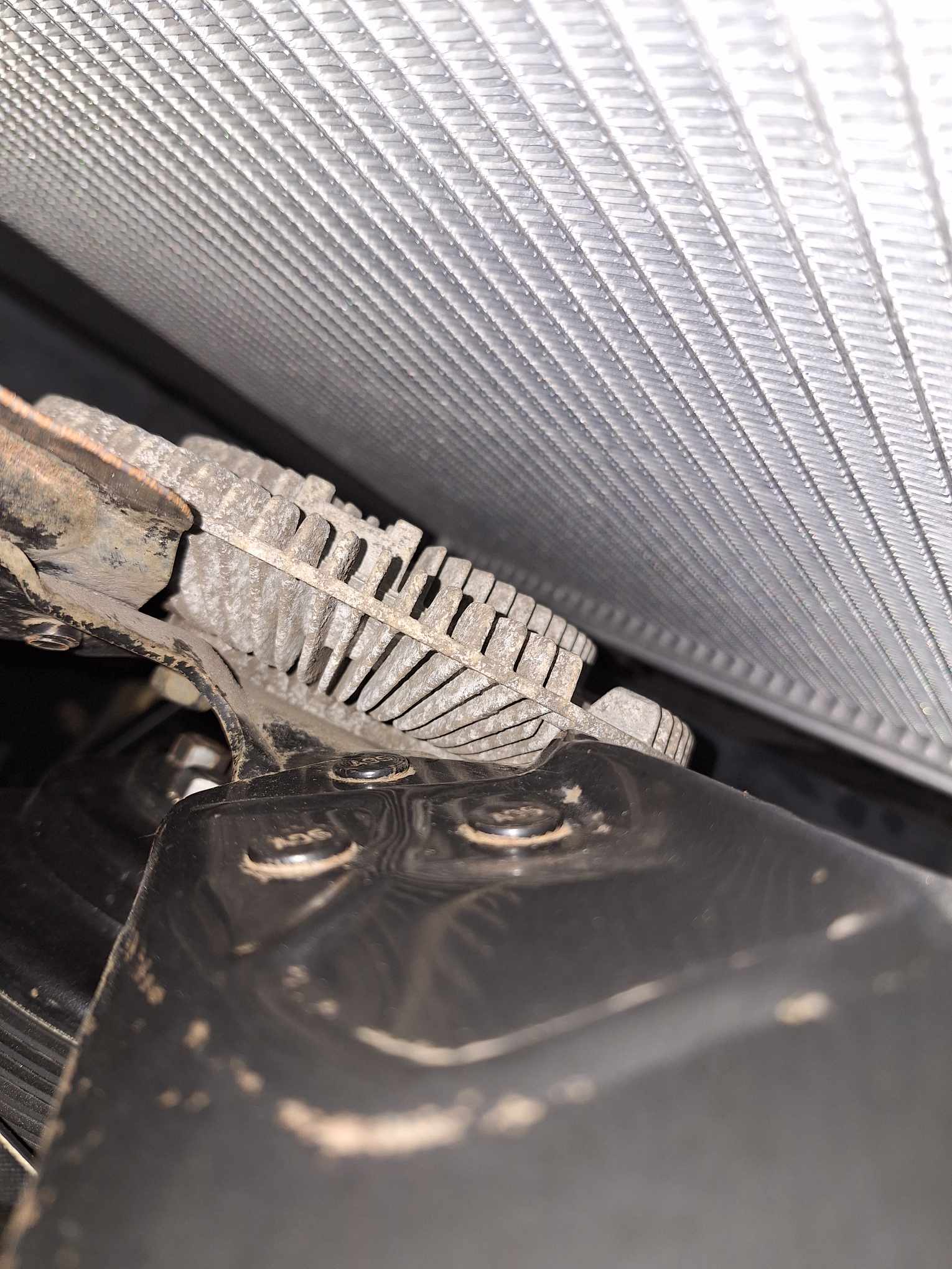

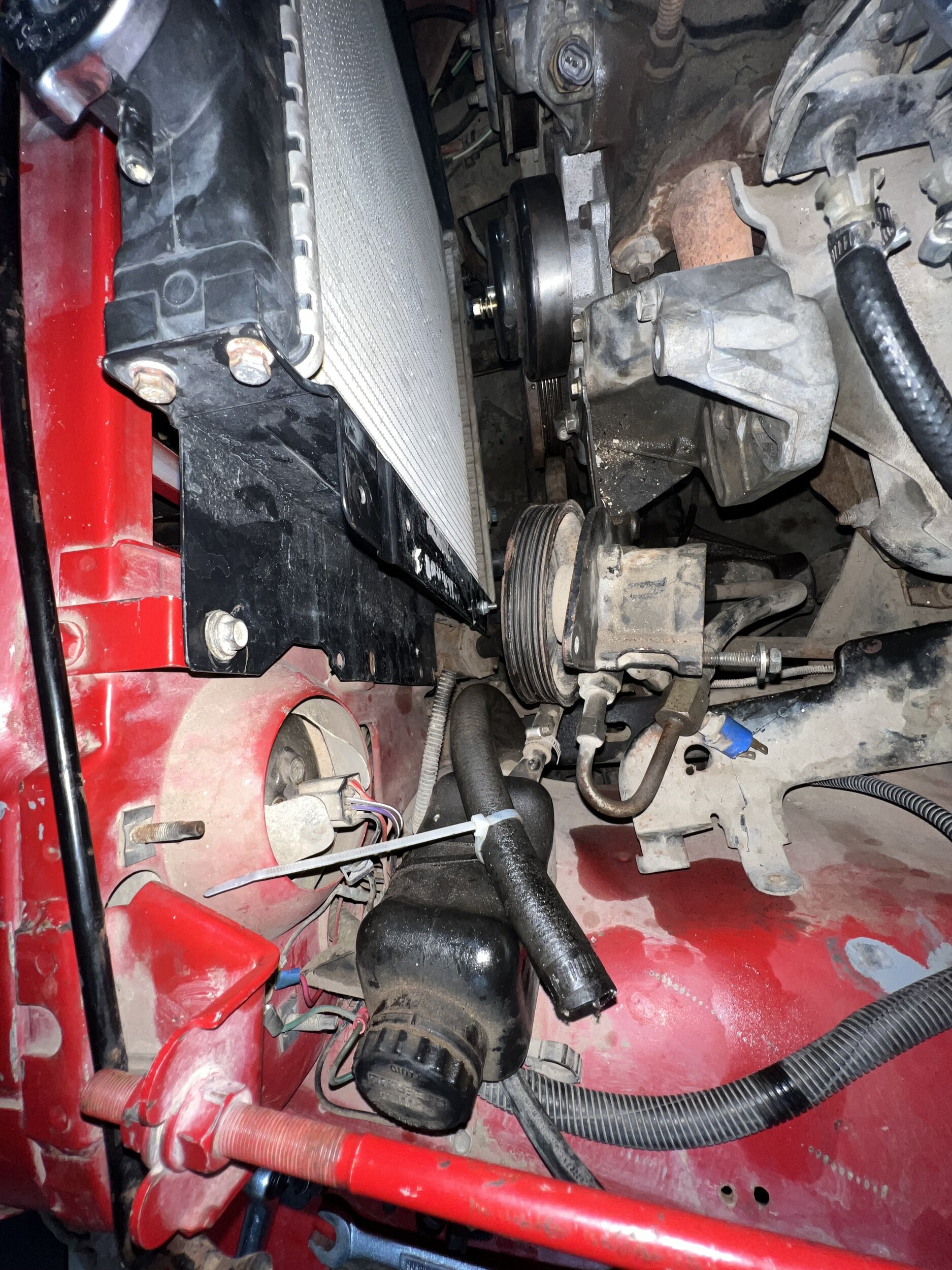

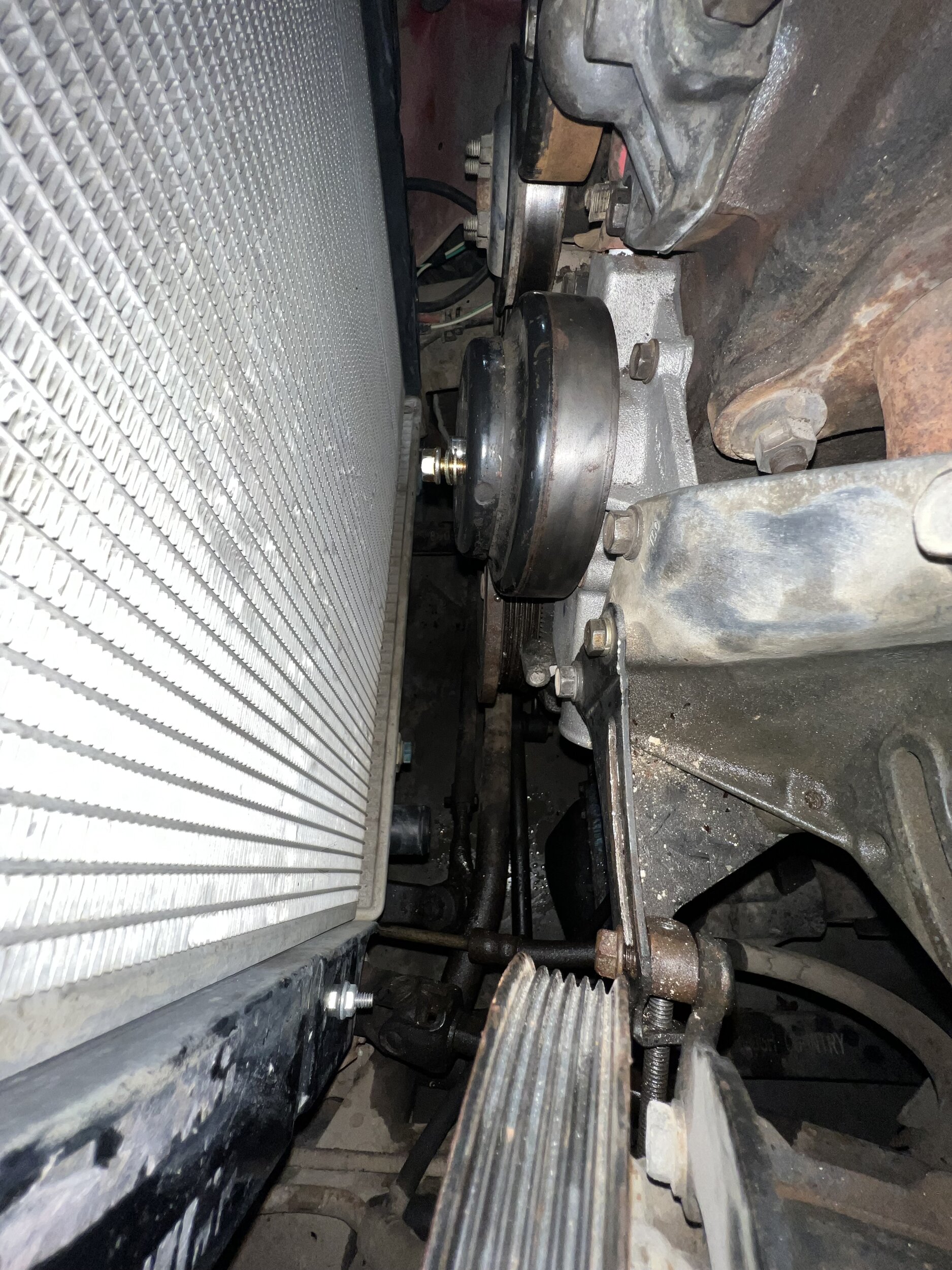

I just grabbed a couple pics in the garage of the clearance between the fan clutch and the radiator. Your radiator looks to me to be sitting just as it should be with the proper brackets, etc..

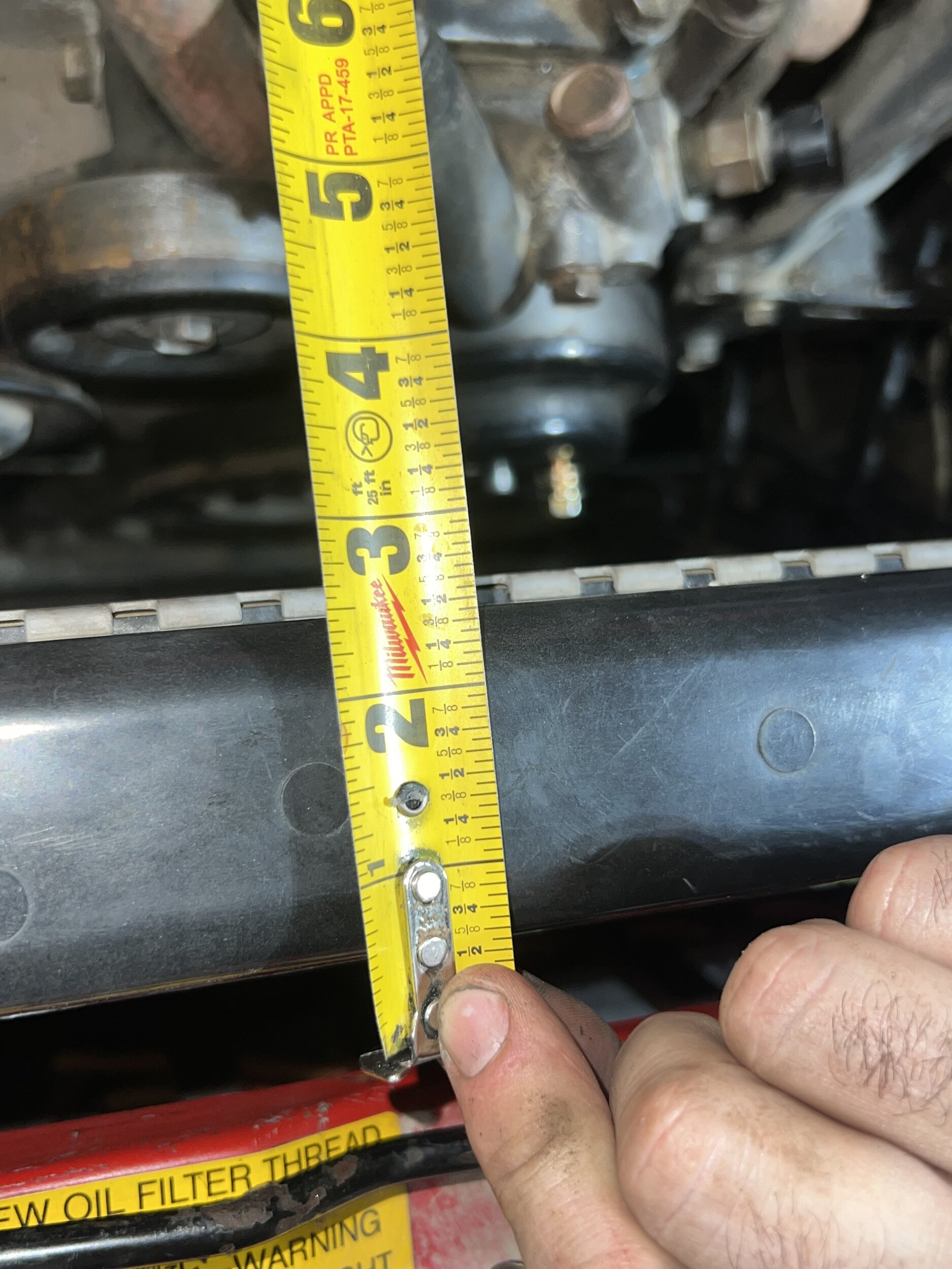

I can stick a tape measure in there if you want the actual distance.

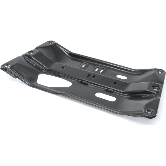

The AX5 does use the forward slots in the skid plate, but this is not due to engine placement or transmission length, it is due to the bracket they used. The AX5 uses the narrow bracket that places the mount immediately below, whereas the AX15 uses the larger bracket that has the step in it and relocates the mount further rear, utilizing the rear slots in the skid. Why they did the mounts this way? No clue. I do know the transmission shifter has to end up in the right spots in order to shift correctly, so a lot comes from that. Doesn't explain why the difference in trans mounts though.
2.5L AX5
4.0L AX15
