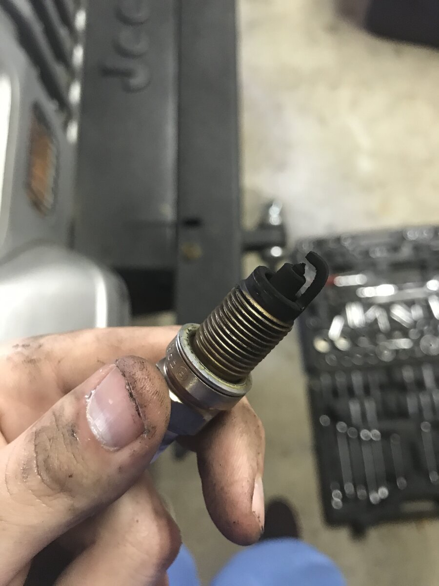

I haven’t worked on the Jeep for awhile but I wanted to send this picture of one of the plugs. This is to me is the worst one of them all. I’m assuming this is oil and isn’t a good sign of the engine. One or two other plugs had the white ashy build up which if my research is right is also oil. But If I remember right 3-4 of the plugs just had the carbon build up like the one I sent before. I’m planing on replacing the plugs and using seafoam. I did put in high miliage oil so I’d hope that would help. I’m thinking this could be a serious issue but I’m just going off of what I’m reading online so I really don’t know. Thanks for the help!
I was confused on why this one was like that and the others weren’t. The engine was low on oil so maybe the engine is burning oil but I don’t know how to tell for sure. I already cleaned the plugs and I’m going to put new plugs in as I said before. The plug looked like the examples of oil fouled plugs but ive never experienced one I knew was burning oil for sure. The people I got the Jeep from had the engine rebuilt by a shop 3 years ago and I’m seeing the shop has mixed reviews so I’m hoping they didn’t do anything majorly wrong. Maybe they just had the mixture too rich but again I’m an amateur here so I’m going off of what problems I can identify.
Unfortunately I'm not sure anyone can give you a straight answer as to what's causing this problem. That engine often goes 200,000 miles so why it was rebuilt early and why it has this problem means something wasn't done right. It could be bad valve guides or a crack in the head that wasn't caught, 100 different things.
When you put new plugs in drive it for 100 miles and check them to see if it's one cylinder or all cylinders. I've seen PCV valves fail and suck a quart of oil into the engine.
You may want to call the shop and see if they have any records of what they did to the engine. Full overhaul or top end only? What a previous owner says and what actually happened is usually different.
