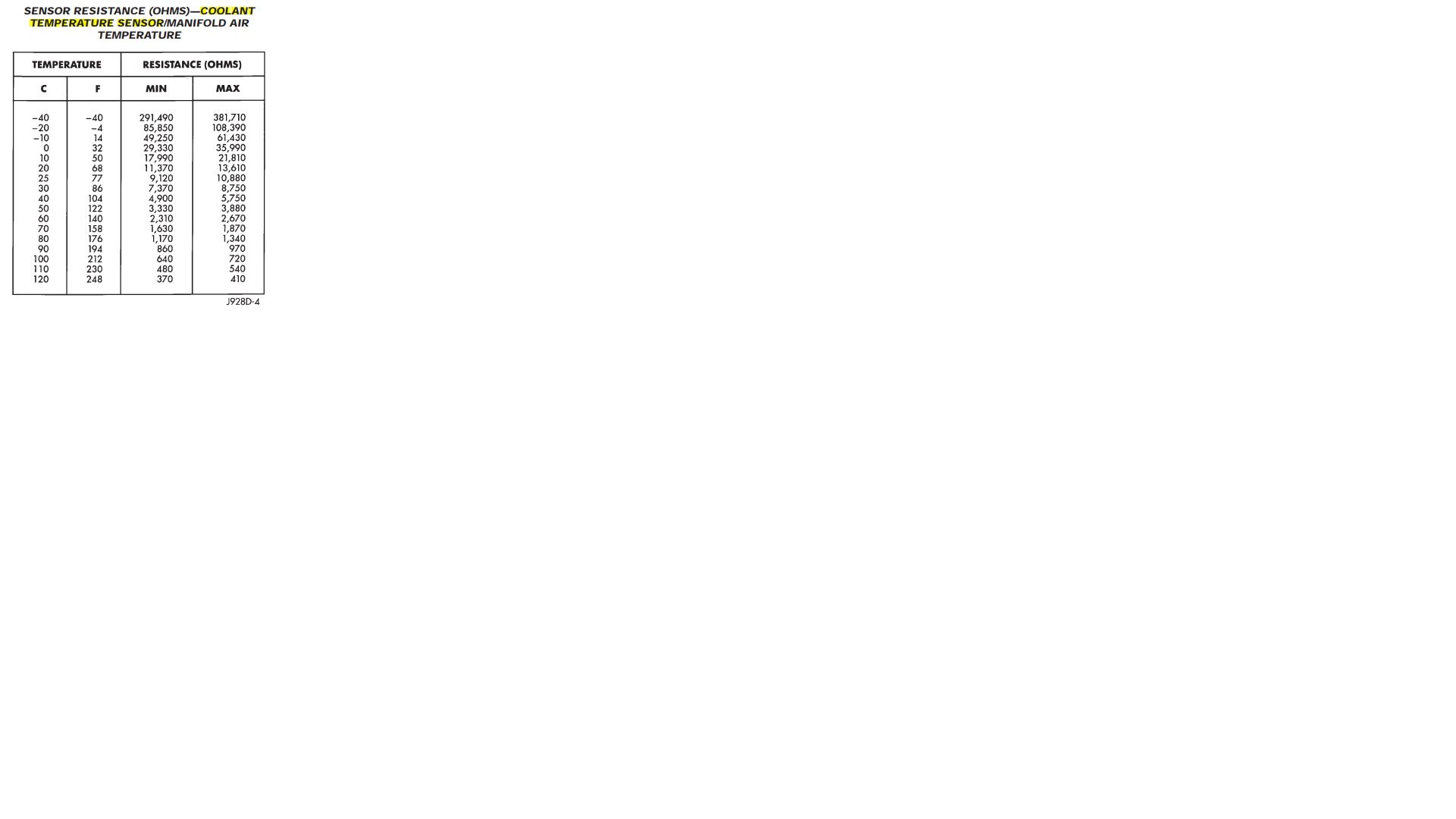

You'll need to put your multimeter on it's resistance setting and get some ohm readings. You can do this with the Jeep off.
I can't find the values for the Oil Pressure sensor in the factory service manual but someone posted their test results using an original sensor and a NAPA replacement sensor.
chapter 8E page 27 covers it in the free FSM

You never read my entire post, do you? Or you misinterpret it. My info is from the FSM with regard to the coolant temp sensor resistance data, that chart I posted is directly from the manual. This data applies to both the gauge sensor and the thermostat mounted sensor. The OP was
The info I posted wasn't even from NAPA. It was from a person that did their own testing on the OIL PRESSURE SENSORS as resistance data for the oil pressure sensor isn't listed in the FSM as far as I can tell, like the coolant and air temp sensors. The sensors themselves being out of range can make the panel read improperly as well.
