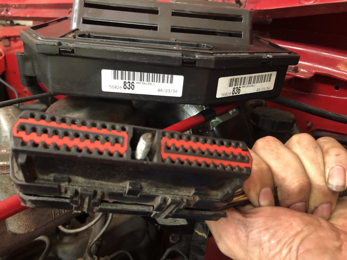

Hi! New in the forum thank you! Doing a engine swap from a 1987 4.2 TO a 4.0 DONOR : 1995 YJ, engine 4.0 with a AX15, ECM, dashboard, fuses box (in-out), gauges & cluster, HARNESS WIRINGS Engine-under Dash,-rear lights. The front lights harness from the 1987.
Actually finished with the installation of the engine 4.0-transmission-wirings under the hood and dash
There are some things that for now I can’t connect:
1- the reverse switch (don’t know how to do it)
2- brake switch connector 4 pins ( can’t do it the old switch 1987 is only 2 flat males)
3.- fuel pump getting a external w/filter to do it soon.
Everything else is hook, I connected the battery to see if it crank .... NOTHING! No click or anything! the only things looks working are: voltage gauge, dome lights, ignition switch turn on the brake light and seatbelt.
Where and what should I check and how.
PLEASE All help is welcome... thank you!
