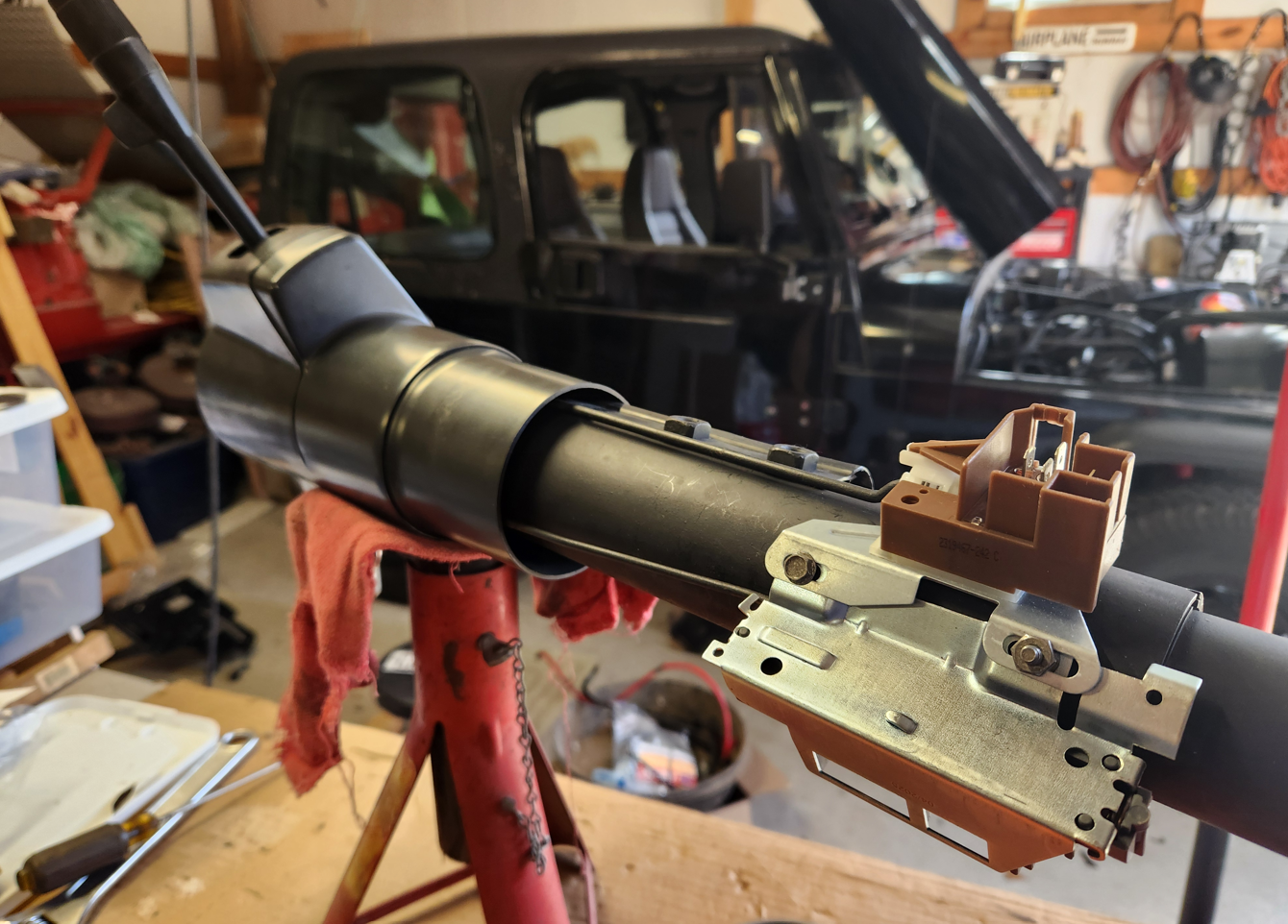

This week I decided to dive in a a lot deeper into the non-tilting steering column in order to access the release lever. This meant repeating the steps I did last time but also, I chose to remove the column for easier access and evaluation. Actually not too big a deal, just a few bolts and nuts, and 4 multi wire connectors coming from the column.

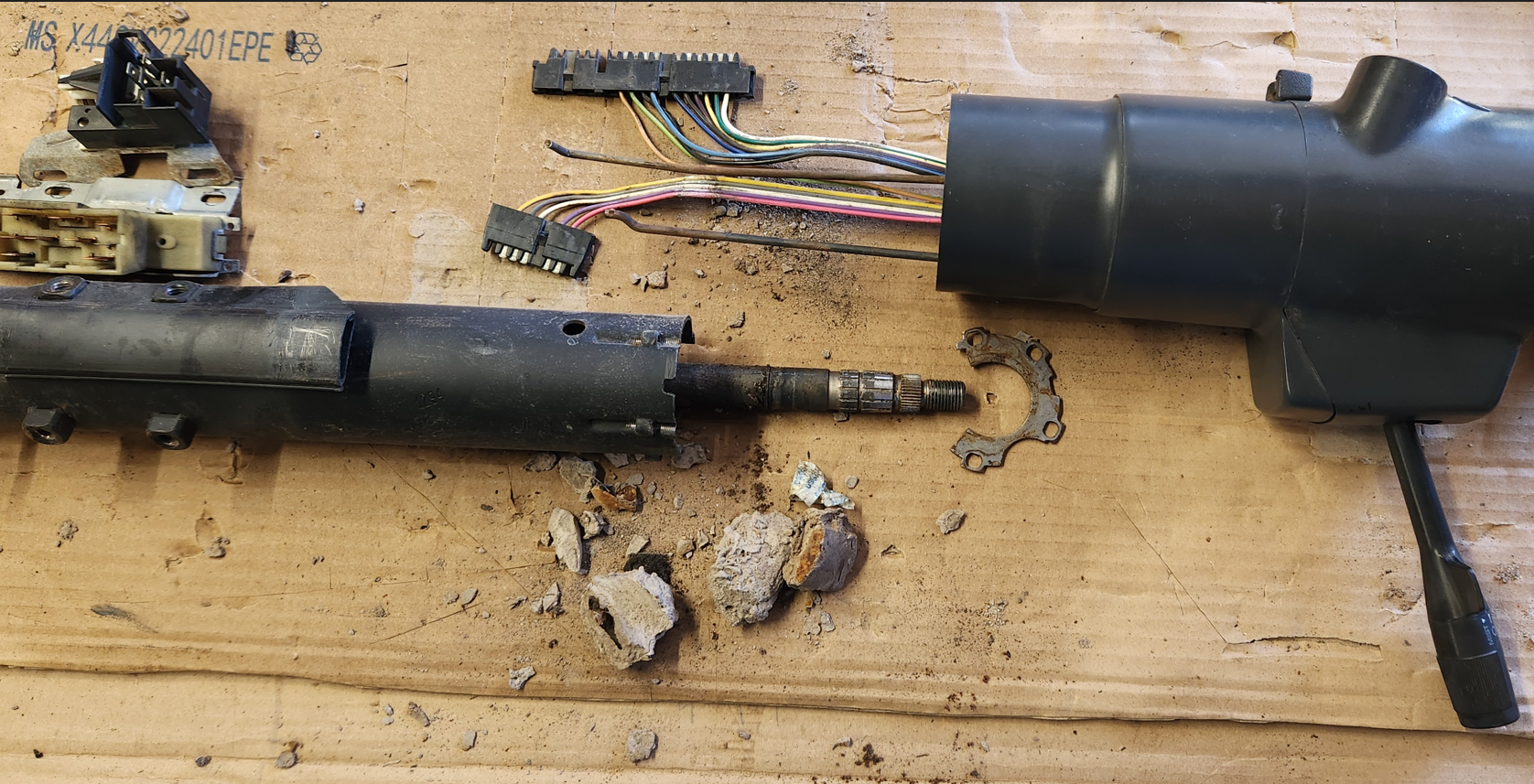

As I was removing the column I notice some dirt spilling out. Ugh.

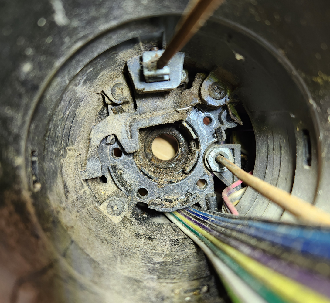

Sure enough, Mud daubers had a huge condominium complex inside the column.
Mud and crust everywhere!
Cleaned it all up, spray painted the metal column and shaft, cleaned and greased the bearing, an add new ignition and high-low beam switches.
All works like new now, nice and smooth.
It's all back together and installed now.
