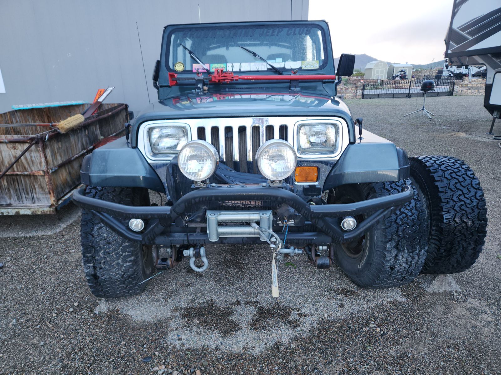

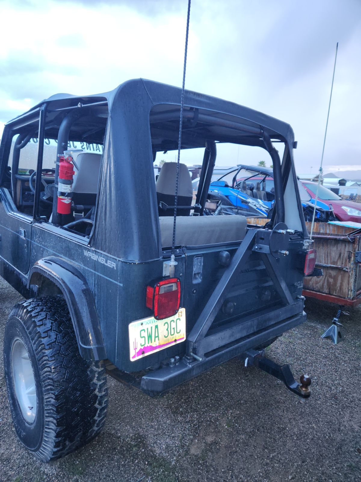

I recently inherited my late grandfather's 1994 Wrangler and I am beginning the journey to bring it back to life the way he would've wanted.
I know next to nothing about vehicles, and even less about mechanical maintenance, but I am 1000% ready to learn these skills where I can on this Wrangler.
Hopefully I'll be able to connect with some of you and get some solid advice on where to start and what to look for.

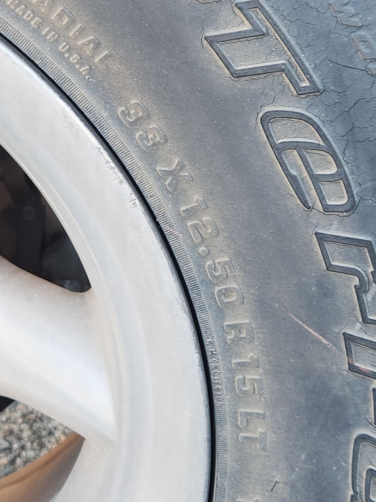

For now, I'm starting with new wheels and tires. The tires on it now are dry rotted beyond use and I would inevitably want to replace the wheels anyway, so may as well do it all now.
That being said, if anyone in the area has the lowdown on where I should be looking to order from or where to take it to have it done, I would greatly appreciate any input you have.
I've attached some photos and the tire size, and suggestions on tire/wheel selections are welcomed also.

Many use an TJ, XJ, YJ, or ZJ stock wheel of choice and fit tires to them. Myself included.
Many (not me) have ran a 12.5" tire on the 8" rim, but you will be dealing with more wear in the center of the tread unless you air down some. Then you deal with a bit more in the lack of handling dept. But, hey, it's a YJ. It's not a canyon carver. It's a canyon crawler.
That said, The backspacing will play a much more important role, so the stockers may not work due to rubbing issues. I have no experience in this dept, so others will probably chime in.

You picked a good one to learn on and by the looks of his jeep club, your grandpa had a sense of humor. My kind of guy. I lean heavily on YouTube like everyone else but beware, they tend to skip over or at least gloss over the hard parts. A 10 minute video can easily be an all day affair.
