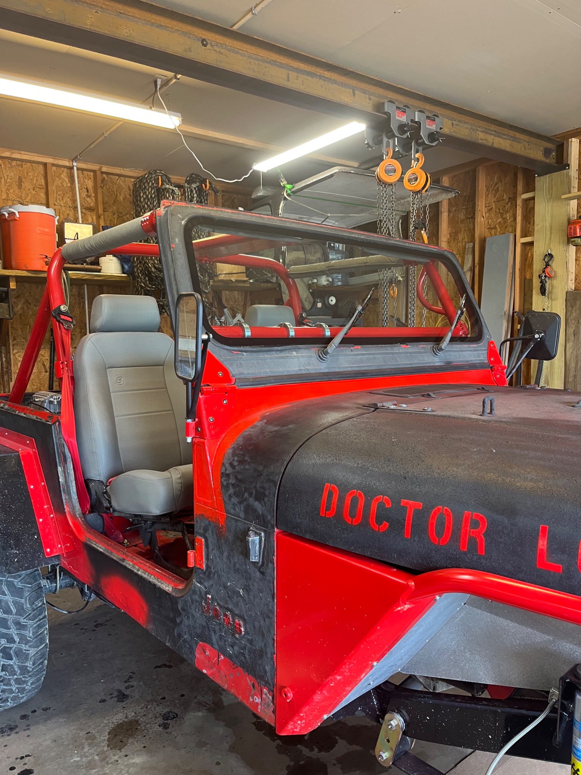

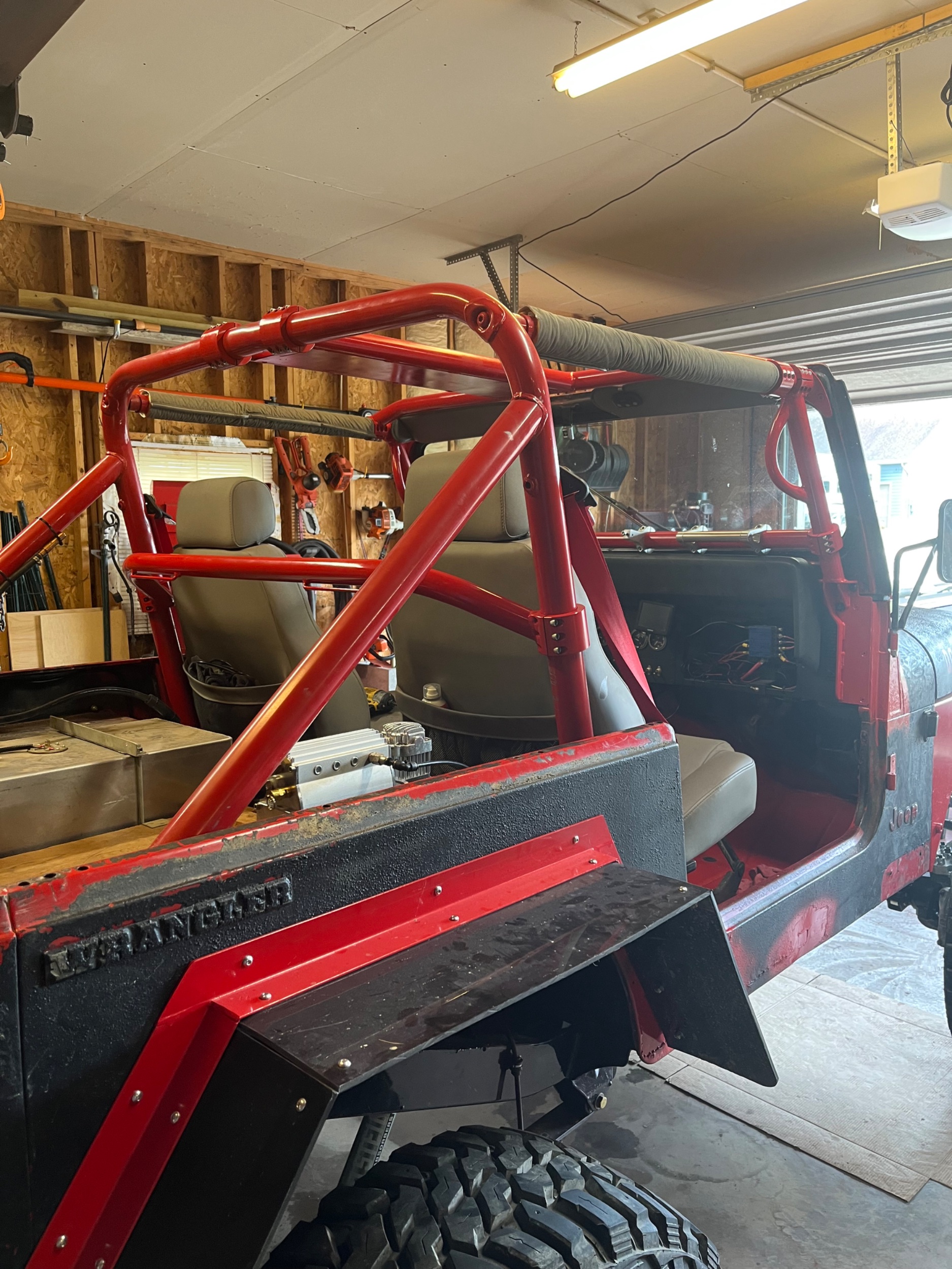

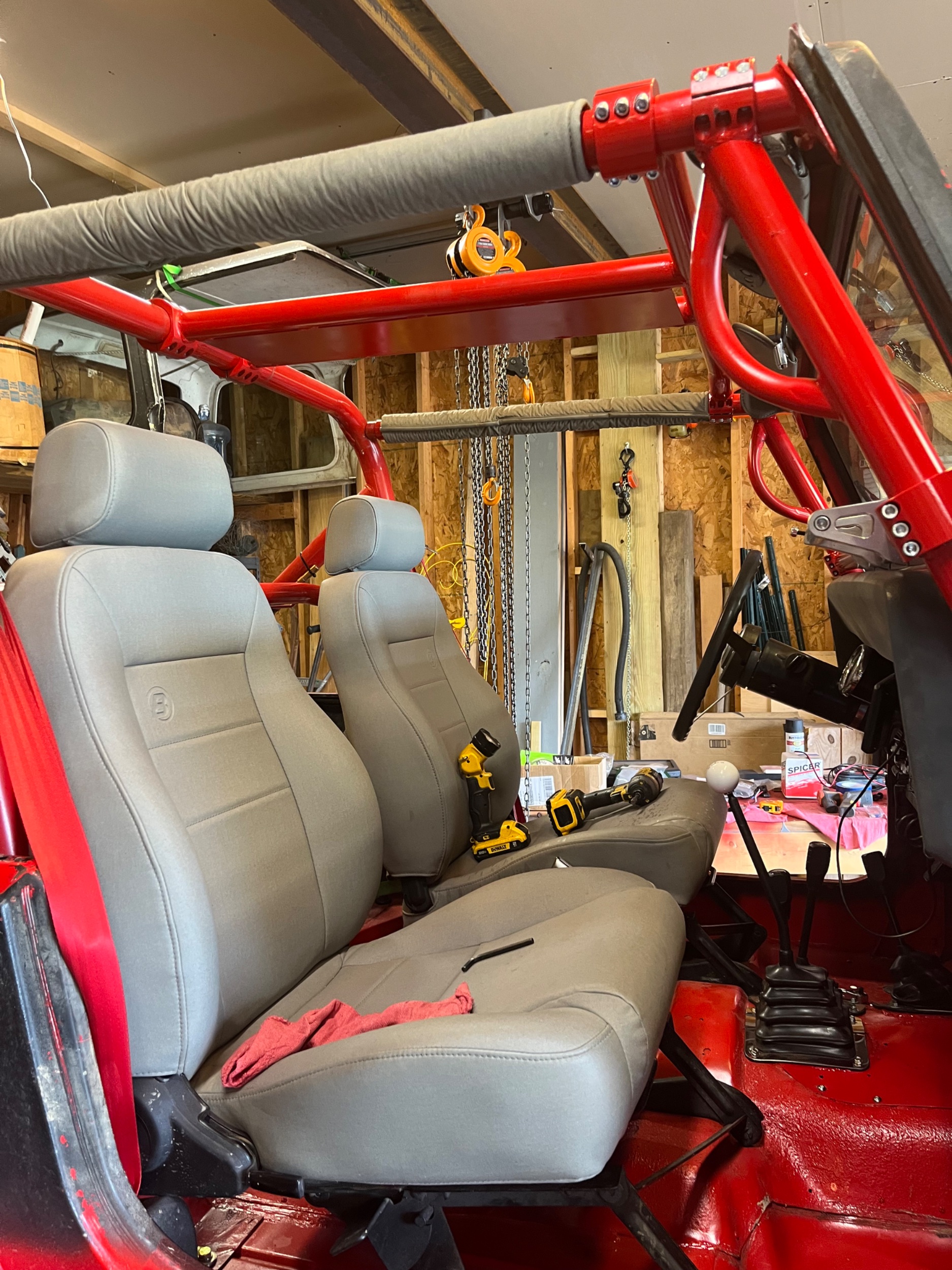

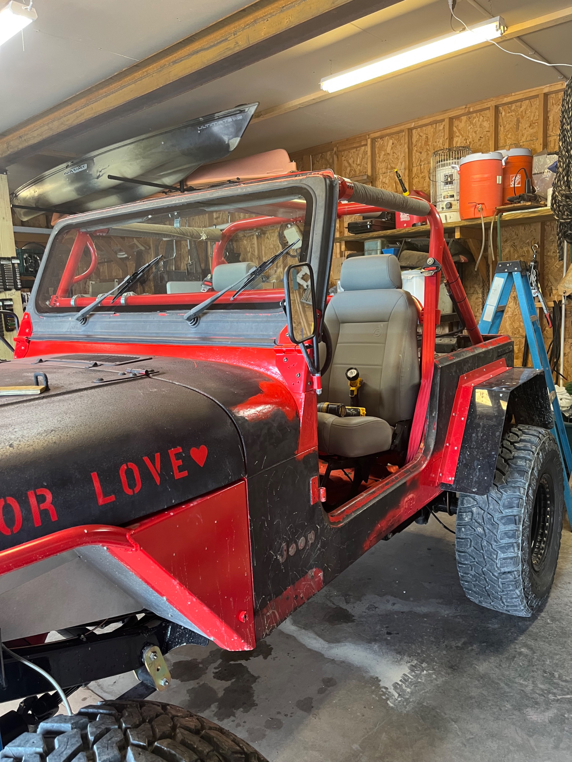

I personally really like it. The main reason for me getting this kit is that it can be removed to take apart the dash. And I am very sure that the dash will be coming apart in the future. Getting the A pillar bars, or at least the second one, on is a challenge. This is because everything is a very exact fit, and I have no doubt that the clamps will do the job. But I did have an overhead chain fall trolley hoist to help. Also at one point I used a bottle jack on the floor to raise the second A pillar bar into place along with a C clamp at the door frame to align the bolt holes side to side. But once in, it fits very nicely. And I would NOT be wanting to take it out and reinstall very often, but the option is there if you need to. With a weld in cage I would be using a saws all and welding back in, that’s doable but not my first choice. And equally important to me is that the weld in cages that I was looking at all had the bar going to the floor that would be in my way. Those also required moving or modifying the parking break. This was what I was looking for.
