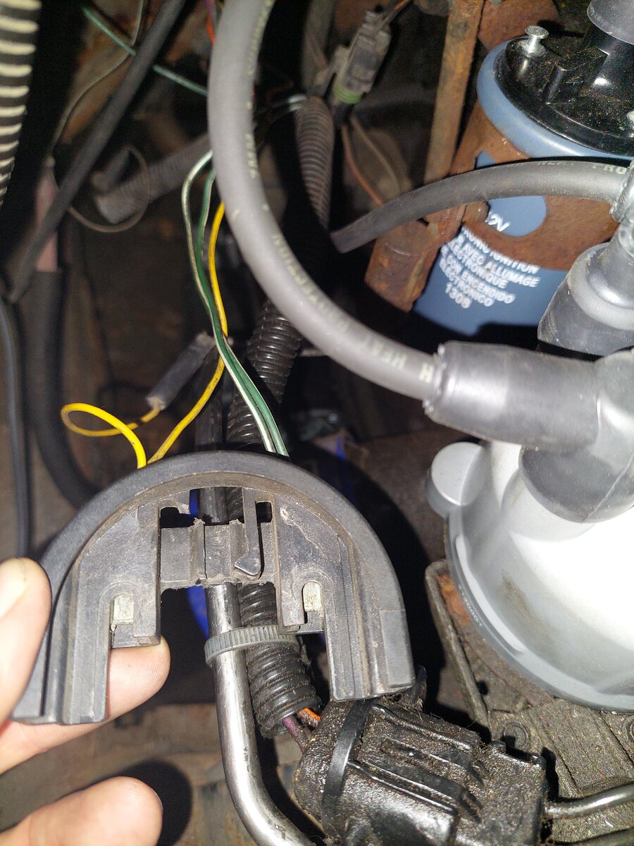

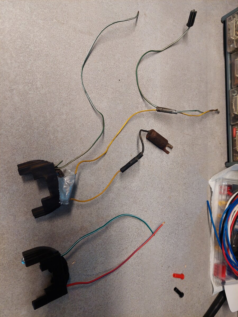

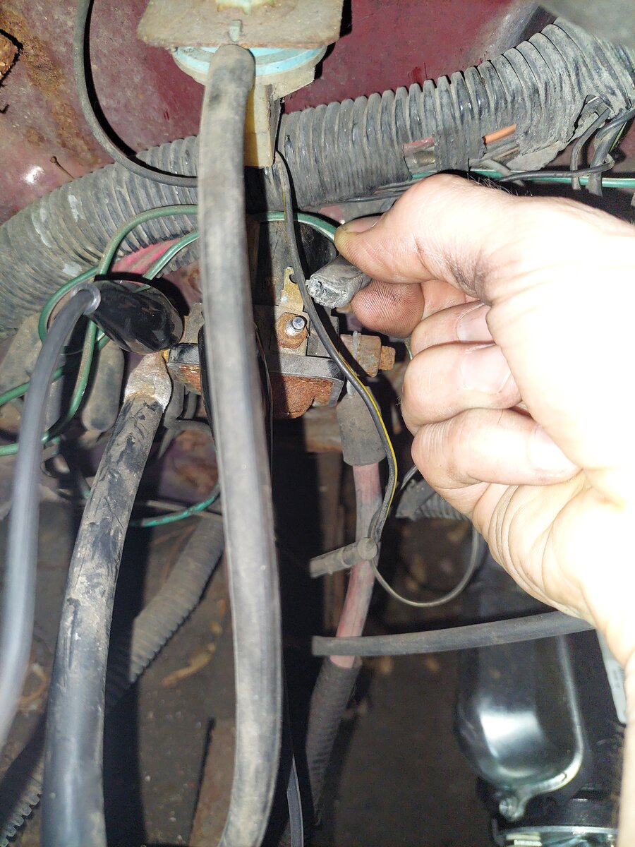

I moved to plugs and was not able to produce spark while grounded. The replacer in me decided to do the plugs, wires, cap, rotor, coil, condesor to no avail producing spark. Looked to Solenoid (firewall mounted type) has 11v off the post to coil, connector on post to coil connector is corroded. Coil connector itself (horseshoe style) has frayed wires going in, is corroded and has a small indent to where the coil posts sit. i was only able to find 12v with key on in a few select areas on the connector lead. All of this looks like it needs to be replaced?

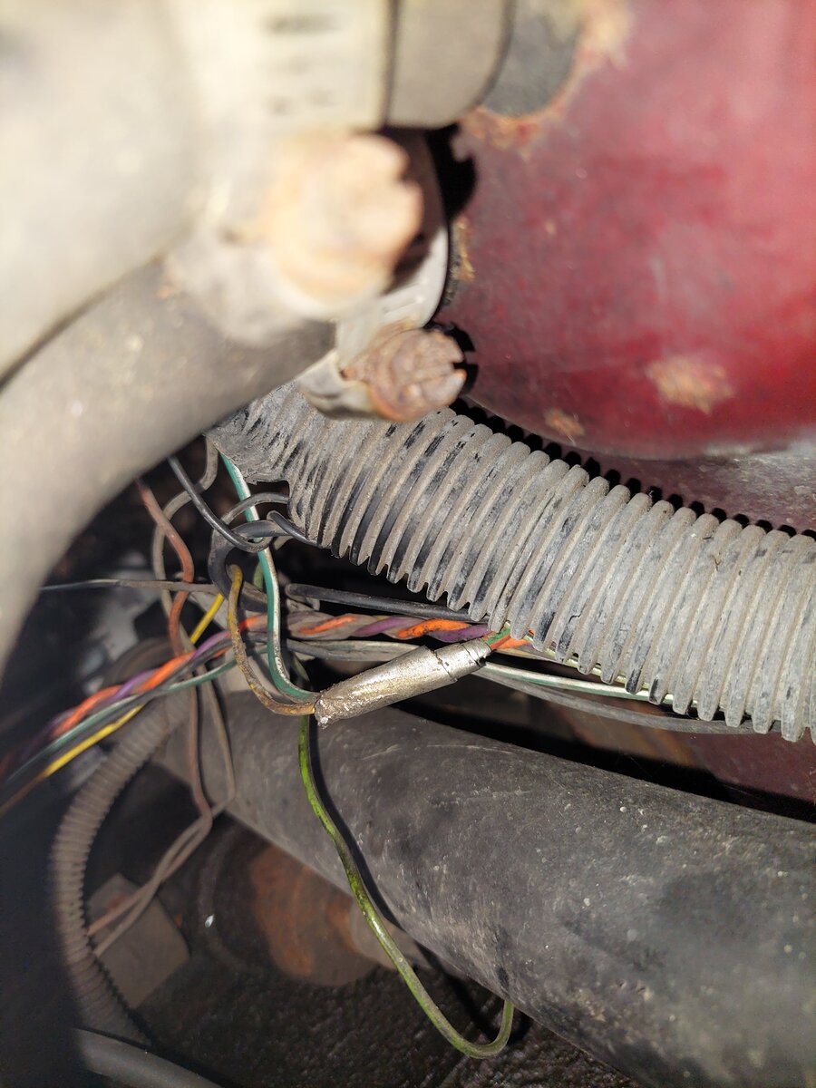

I'm curious if I'm even on the right track, if I am to replace the wiring at the solenoid and the connector- its spliced at the loom near the firewall that goes over to ICM ( in assuming all of this is bypassed due to mc2150), can I run just a new, direct wire to avoid this splice and wire that to the two yellows going into a new horseshoe clip? I was reading there is a resistor wire (that I'm unable to locate). This is where it gets a bit unknown for me.
Sorry this is long and slightly convoluted. I've attached a photo of the horseshoe connector, loom splice and connector on solenoid for reference taken during my tune up and connector cleaning.
