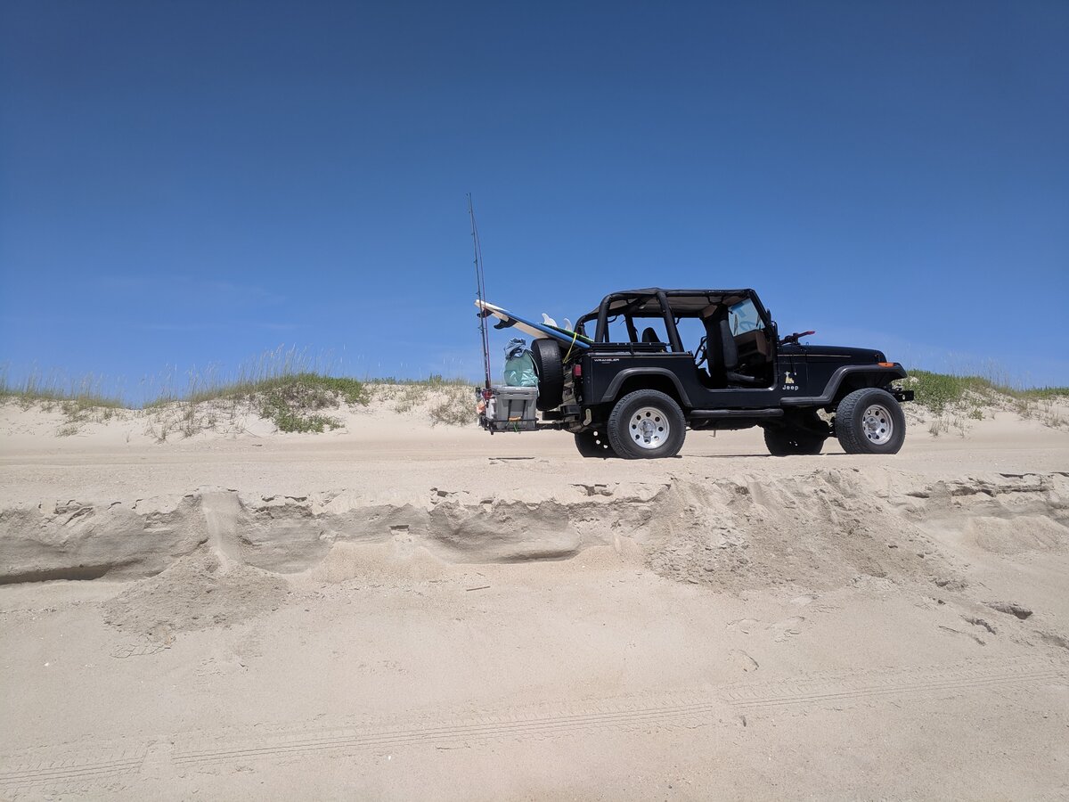

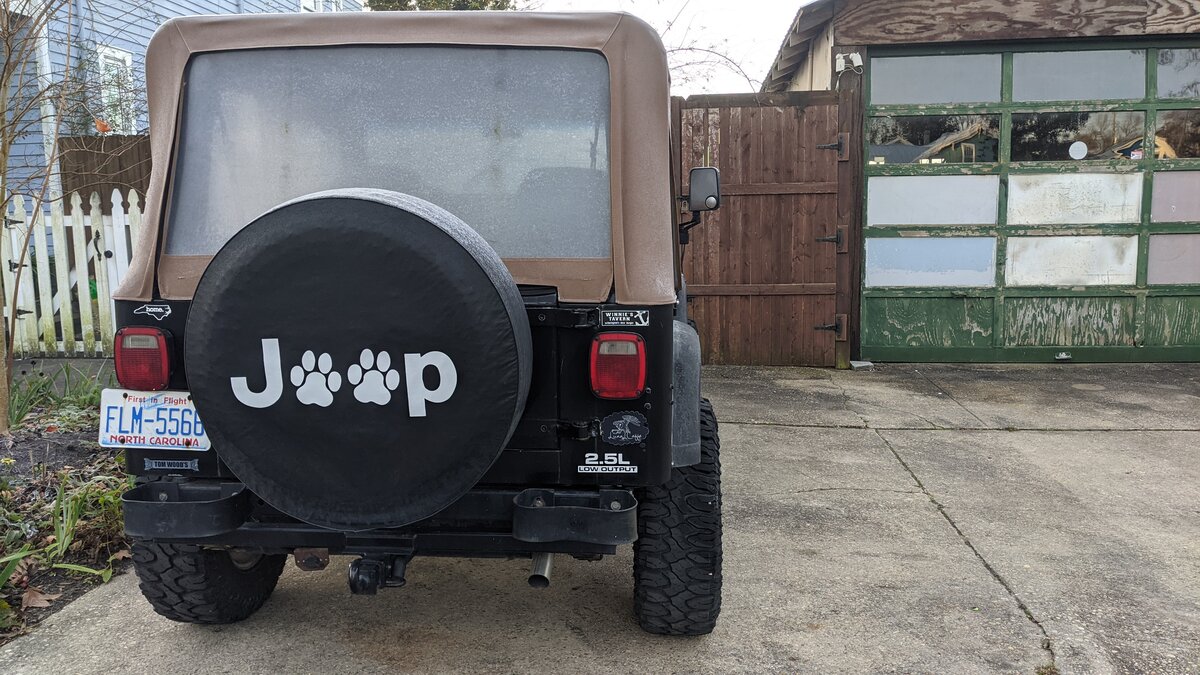

This YJ fell into my lap when a neighbor decided to move to Raleigh two years ago. She was sitting outside his house under a tarp with non-functioning breaks and homemade spring linkages that were so short that the leaf spring bushing eyes were touching the frame bushing eyes. This meant that the spring could not flex at all. She drove like crap. She is also the bare bones model. 2.5L with no power steering from the factory. That said no rust a 2.5” lift, nice rims, and a great running motor at $1,200.00 seemed like a great place to start.
I wanted something I could take to the beach or Uwharrie’s trails and still drive around town with the doors off in the summer. Here is the list of stuff I’ve done to date. As of now I consider her done so I don’t have any future upgrade plans.

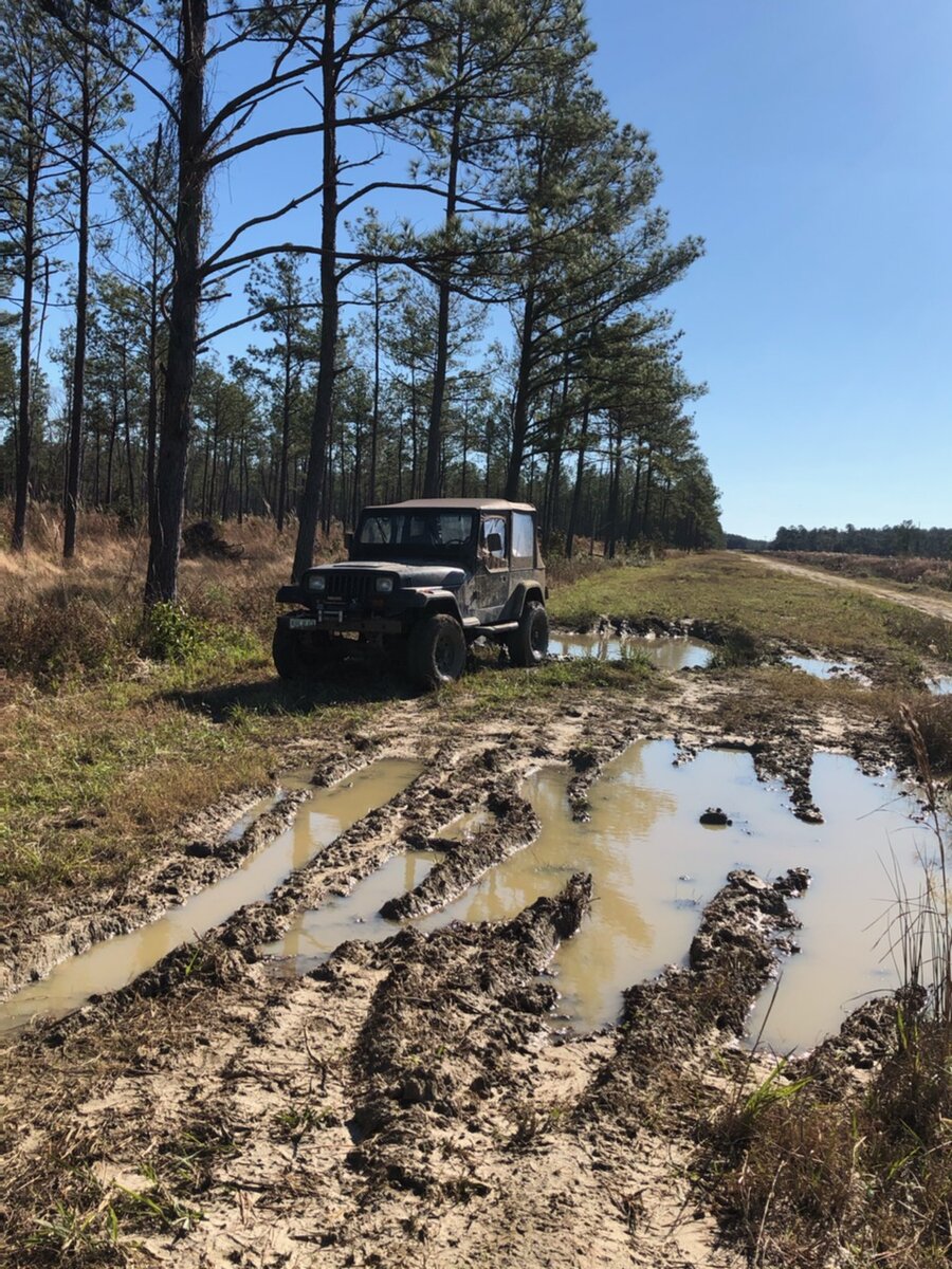

  • I got stuck in the mud.
  • I got stuck in the sand.

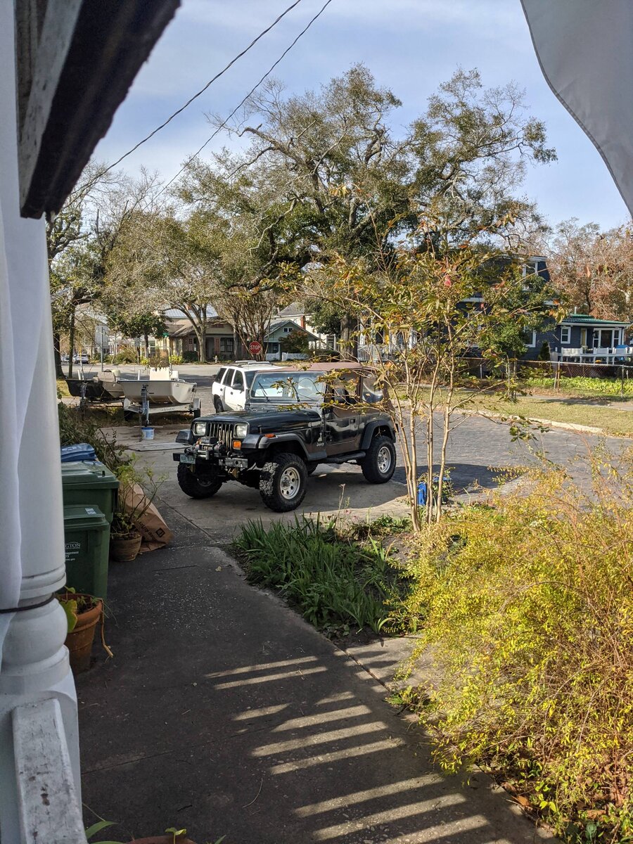

So the YJ went into the shop today after a u joint flew apart in the rear due to the need for a slip yoke eliminator to go with my lift. When I get the jeep back I will have added CV shafts front and back, a slip yoke eliminator, and a shift selector plate in the NP231 from a TJ giving me a true transfer case neutral. I'll also have new seals, bearings, and chain in the transfer case and I'm having them reroute the exhaust so it wont rub the front driveshaft.
