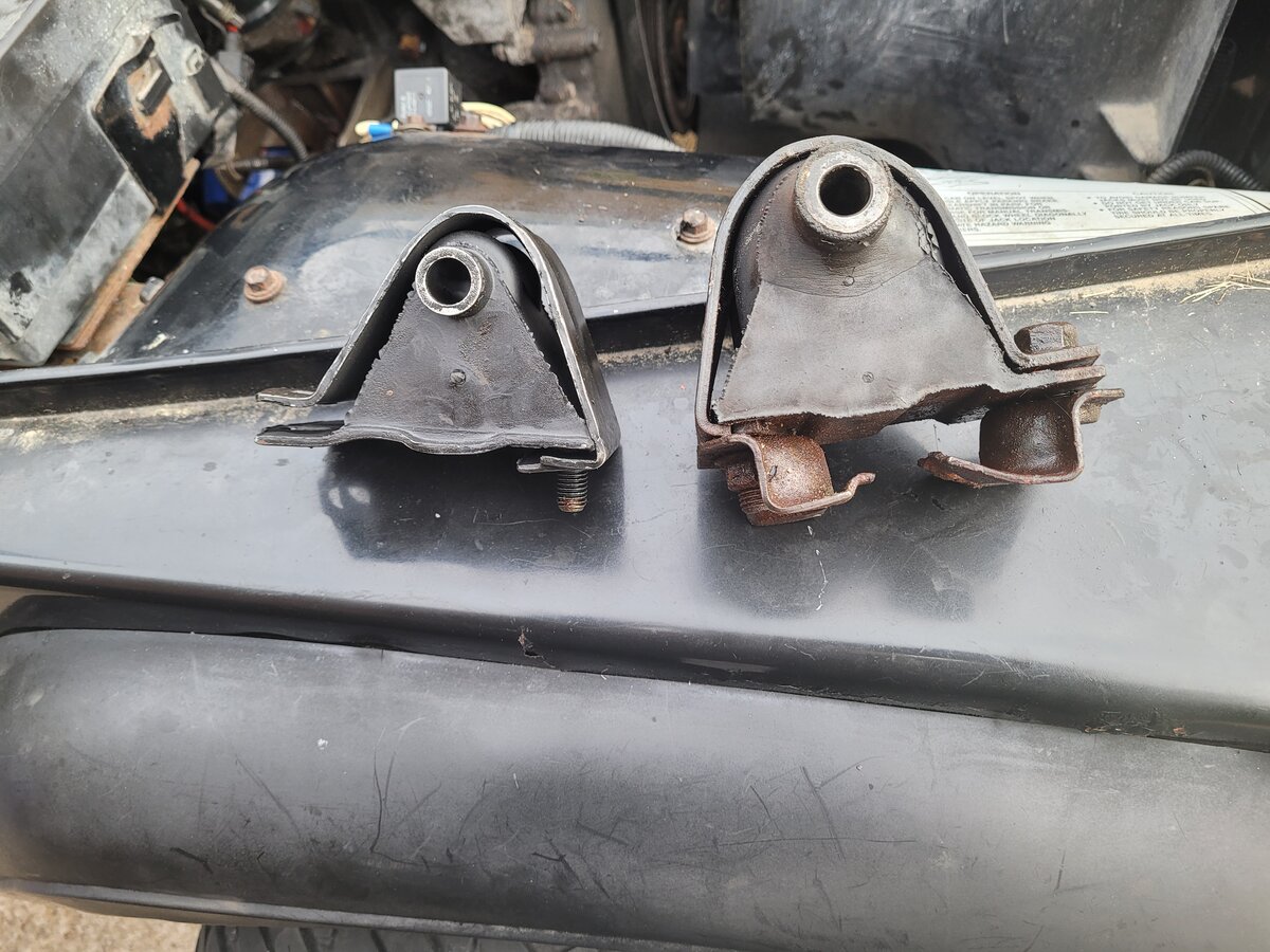

Is there a bracket under the motor mount can i buy one or do i fab one, the new one from rock auto is much smaller but matches the driver side?
Left and right are different on my 2.5L. I was going to buy a Brown Dog motor mount but had the material on hand to make one. That original OEM one looks like a quick fix after the design engineers realized they made a mistake and were an inch off. Every one breaks.
I used channel and flat steel.
