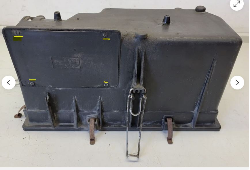

I am missing a small plastic plate at the lower inside of the air box. Looks like it was held on my screws or ribbits. Does anyone have this peice and what is it for?

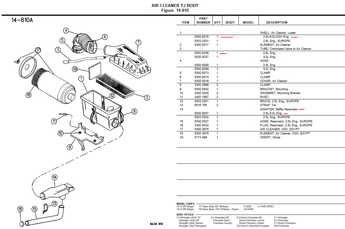

the free shop parts manual shows this.
i guess part ID #8 is hacked?

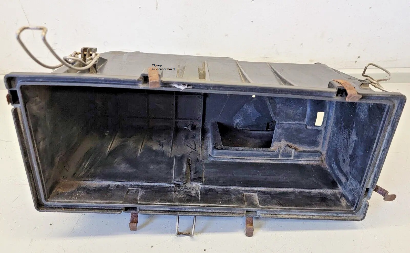

must be photo 3 here, i painted yellow

turn the box up right and the plate is on the bottom right side
my guess is someone had custom home made COLD air kit or snorkel kit attached there.
or is parts from outside USA.
jeep never sold that plate ever. its on all ours part of the box, total.
also some countries mandate a SILENCER there (noise abatement )
if anyone has an old broken box that they don't need I would like to get the plate off it. If not I will make one but rather have the factory look.

now I see the picture you posted. took a while to show up. Yep that's the plate I need.
Just make one. Previous owners drilled the rivets on mine and removed the panel, I'm guessing as a cheap "cold air" intake. Yeah I've had fun reversing the "good ideas" the previous owners had.
I took a plastic tote lid and cut it to shape, then sealed it with black RTV. It's not perfect but works fine.
